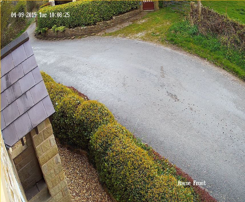

Now I need to decide if I buy the ANPR camera :-) do you reckon it would work in the same position as the camera image I have attached?

Good to hear you have cracked it.
I think a Hikvision ANPR camera will work OK there.
This model (with the 2.8-12mm focal length for your application):
Hikvision DS-2CD4A26FWD-IZS\/P | 2MP Darkfighter IR Array Bullet Network Camera
It is a far from ideal mounting position and view.
Ideally you would be much more aligned to the flow of traffic and thereby have the vehicle in view for longer - giving the camera a better chance to capture a decent image of the plate as a vehicle approaches.
Also, a better view would enable you to keep a vehicle in view for more seconds AND to narrow the view (zoom the lens in).
With your setup, vehicle will pass through side-to-side fairly quickly.
Hopefully, from the look of the road, it is a narrow bend and they will not be going too quickly.
However, having explained why it is a very challenging configuration, I have seen Hikvision's ANPR cameras manage to capture number plates at some very obtuse angles (where I would previously had said it would never work).
Our usual 'Buy & Try' would apply.
Thanks. I have also put a pole on a wall to the right of the snip I have provided. That is at around 2.5m height and looks across front of house + road. The pole is partially hidden in conifer hedge. My concern with 4A26FWD would be is size (length) and being a bit obvious making house look like prison :-) was thinking therefore of moving turret from house to pole and ANPR on house.
As you say, 'buy & try' applies :-)
