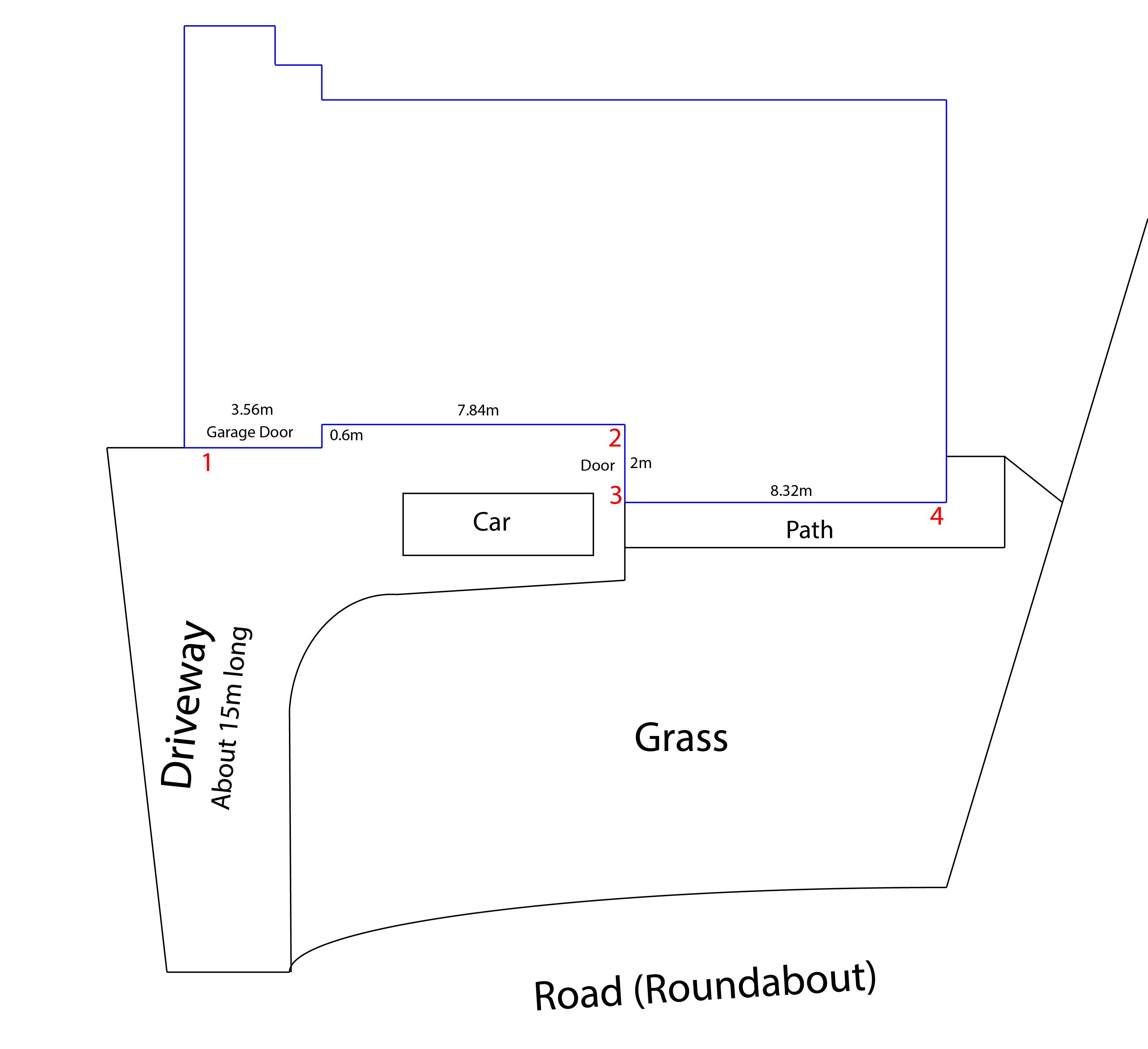

I would also like to know the best options in terms of 2.8mm vs 4mm and camera positions. Like I have said I am thinking of just starting with 2 cameras at the start of the house for now. I have tried to draw a rough layout of the front garden with some rough sizes. I have indicated 4 potential places.
Number 1 was my first choice. I thought with a 2.8mm i can still cover the entrance and the front door. Would that be the case? Any other advise as to where i may put these 2 cameras?
If i went with 1 and 2 - would 2.8mm or 4mm be best? And with either, would 2 see any of the front door? Or just the approach up the drive?

Hi @JDFx17
We would agree that the I-series NVR is the way to go if you want to use the 8MP AcuSense cameras, the main reason for not using the 4-channel NVR is bandwidth limitation. The 7604 is actually quite an old model now and only has a 40 Mbps incoming bandwidth limit, at the time of its release there were very few cameras that were going to be producing more than 10 Mbps but as the resolution has increased and now new smart functions are being added the bitrate is increasing massively. In some brief testing, we found some 8MP AcuSense cameras were actually producing around 20 Mbps with minimal activity in the scene, so obviously you are not going to be able to connect 4 of these cameras to an NVR with only a 40 Mbps limit.
The positions you are looking at are all fine, with a 4mm at position 2 it is unlikely you will get full coverage of the door because the 4mm 2386G2 has a FoV of 83°. We usually recommend for covering doorways that you use 2.8mm cameras because they give you the widest FoV over the shortest distance and thus there are fewer blind spots in the area directly around the camera. (the 2.8mm 2386G2 has a 103° FoV)
The other thing to be aware of with both cameras pointing at each other is that you make sure both cameras are not looking directly at the other camera's face, this is because the IR light that both cameras emit at night will blind the other camera. The simplest way to avoid this is to mount the door camera (position 2) slightly higher than the door and then angle it slightly down until the camera at position 1 is out of its FoV.
Other than that, those 2 positions are a good place to start.

I think I will get position one sorted first. I can then run an ethernet cable in the door to the NVR and hold the camera up to postion 2 just to check the view before I drill into the sofit first etc. But thanks for the note on the IR. I think it should angle down enough but well worth checking.
