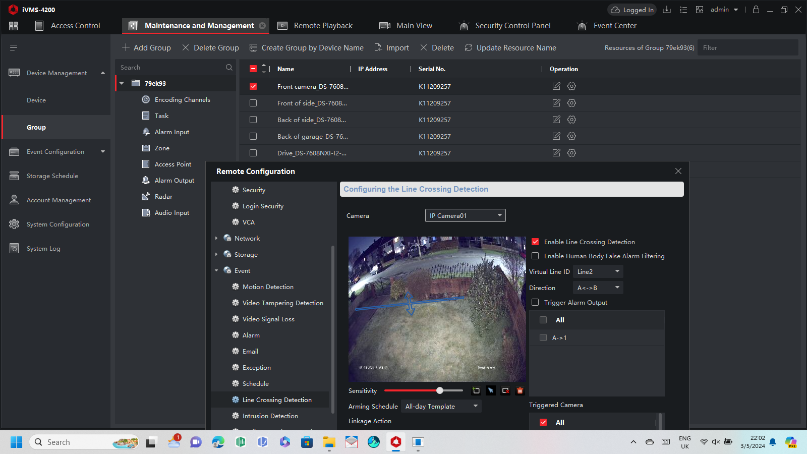

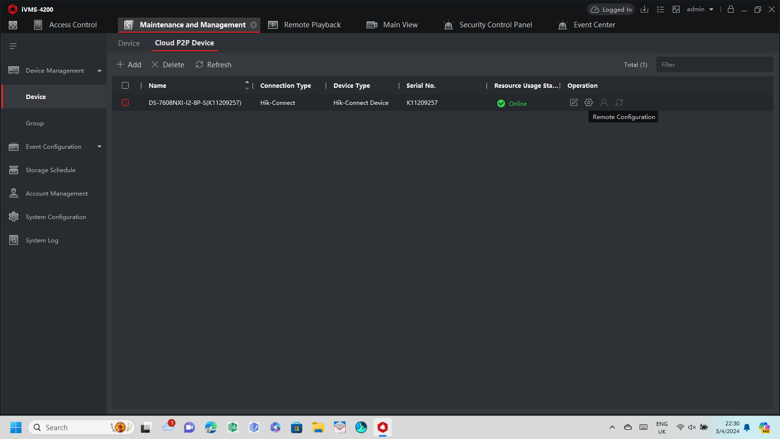

Anyway gentlemen, after spending all day yesterday I found the "line-crossing" area I was looking for from 2 different directions. I have enclosed some screenshots and notes. I also found an IPV4 IP address which I tried from my browser. This put me back into my system with the much smaller amount of functionality. I am happy with this and wish to thank you both for your help. I know I will be back due to other quality problems, but this issue is now closed.
Thanks again.
