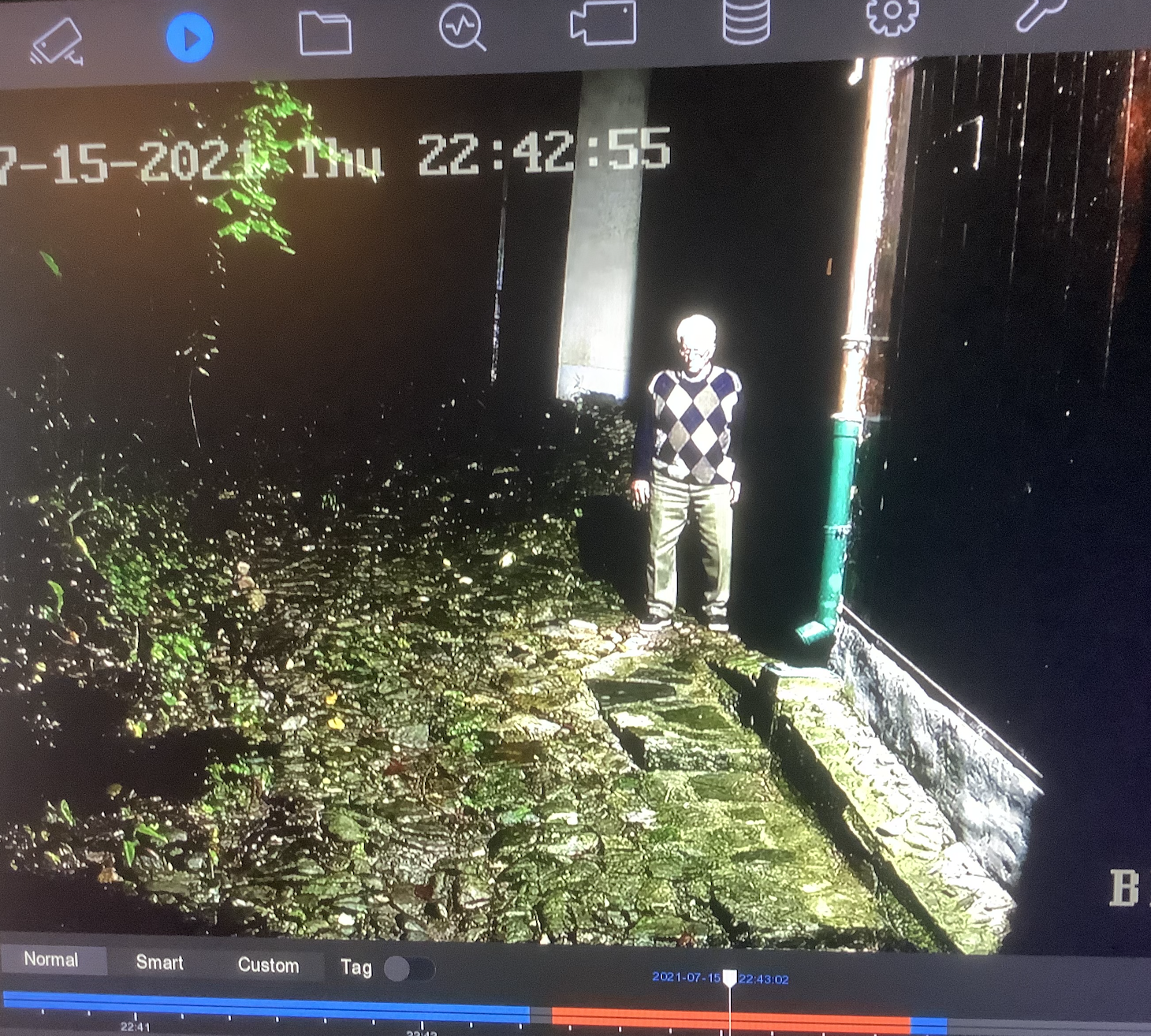

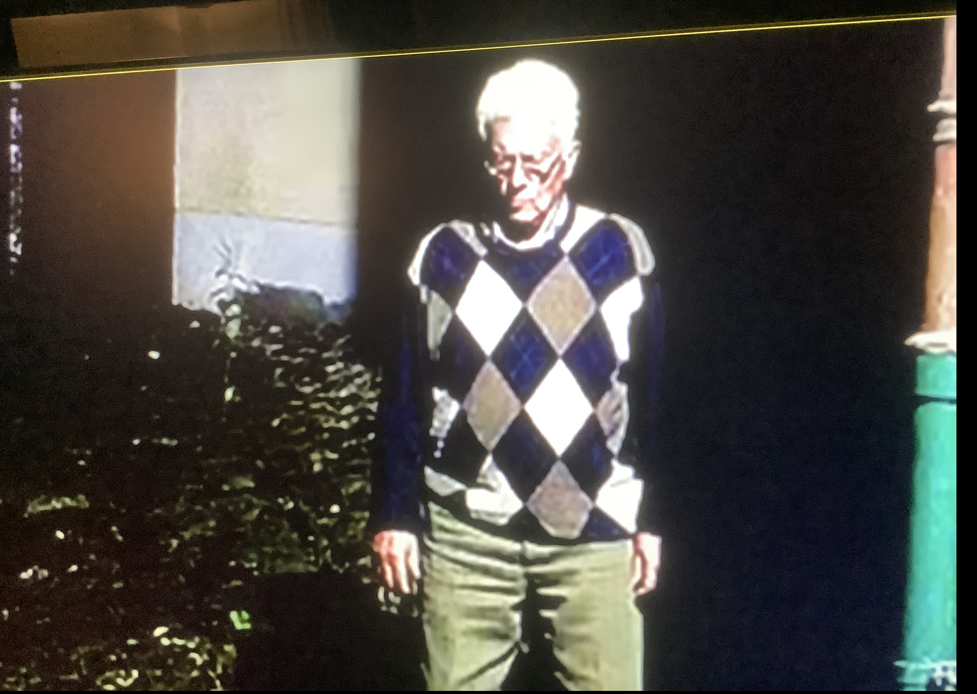

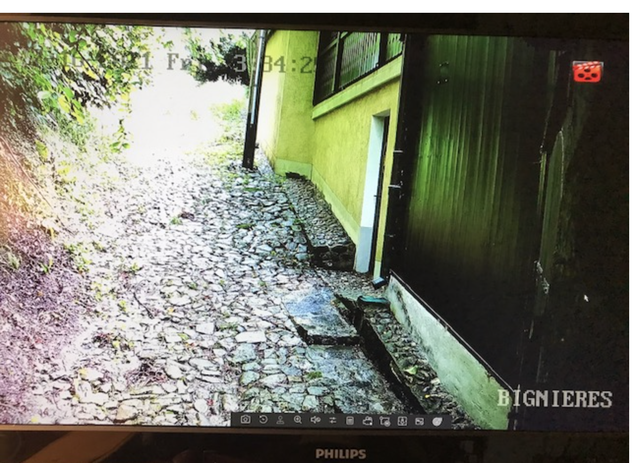

My house is located next to a forest with a forest lane running along my house. That facilitated two years ago a burglar to climb a wall and penetrated into the building. That happened before I had my surveillance
My video surveillance, not visible, covers the lane. The camera I use is the HIKVISION colorvu DS-2CD2047G1-L, 6 mm, 4MB.The video quality at night does not satisfy me nor is a face easily recognizable at a distance of 10 m. I decided to install an 800 lumen LED floodlight with a movement detector. Camera, floodlight projector and detector are all located at different places. Most important the camera is impossible to locate. The surprise to a visitor is total when in total blackness the flash appears and being filmed unaware.
The settings used for the shots shown here are the following: auto switch, exposure time 1/3, image setting: brightness 0, saturation 20, contrast 100. The camera is located about 10 m from me. The 3 pictures have been zoomed.
A camera with 6MP or higher my provide better pictures.
