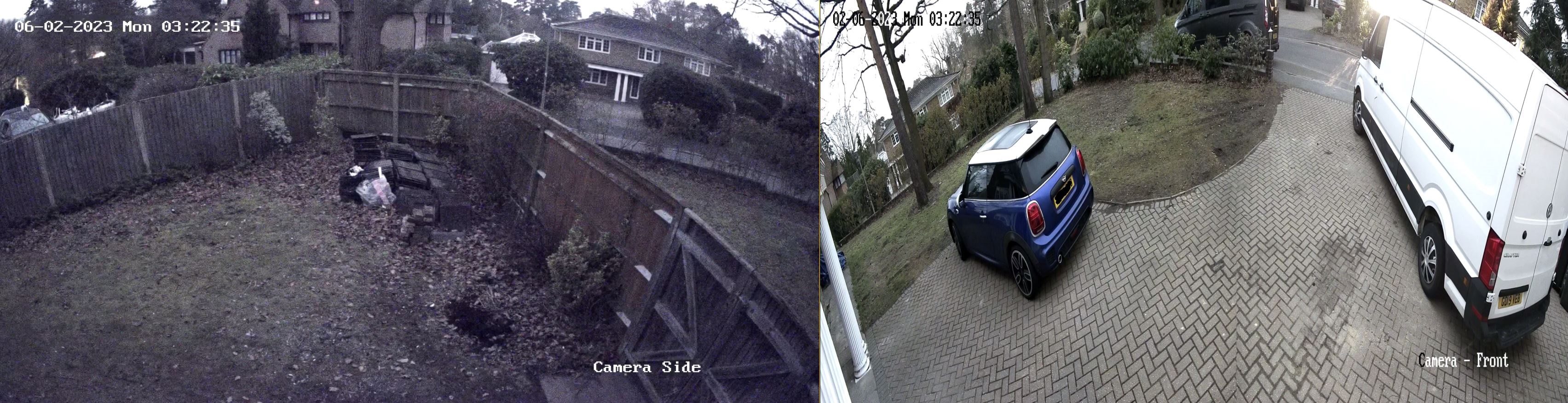

See enclosed the image. Side is the 4mp turret, right is the 8mp panoramic. thanks for looking

Are we actually looking at two views captured at the same time?
If you view those two cameras LIVE now, are they both showing the same/correct time?

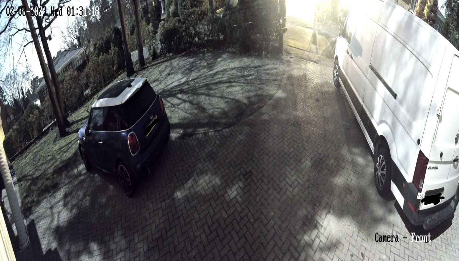

Your front camera seems to be capturing the sun rising at 03:22? (light and shadows in front of the van)
In the UK today?
The BBC weather page says that the sun rise was at 07:25 this morning.

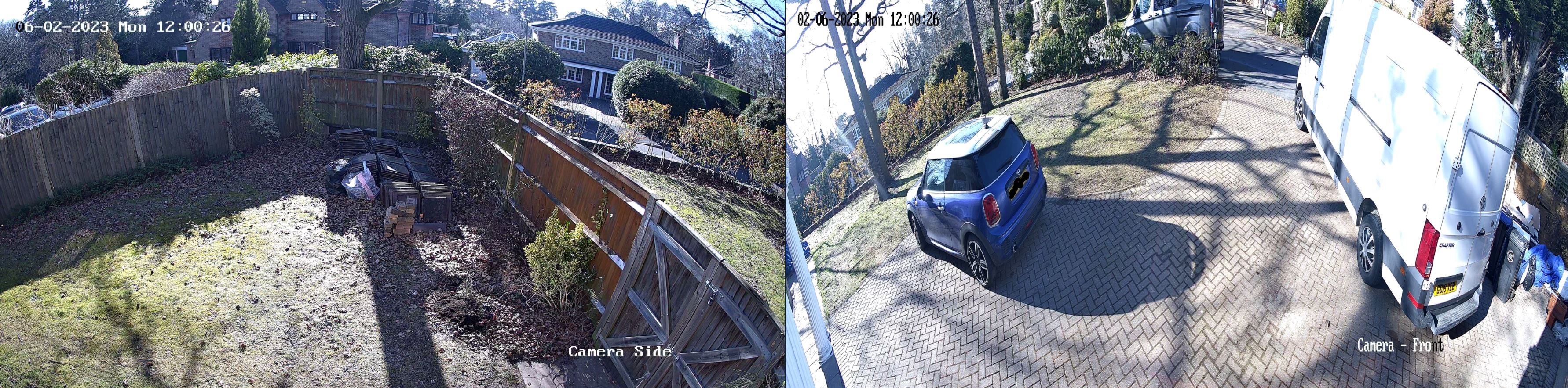

Hi, yes captured at the same time
Enclosed for mid day today yes the same and correct time on each
I think the "sun" is actually some light from the house opposite and I checked its pretty much on in the night
