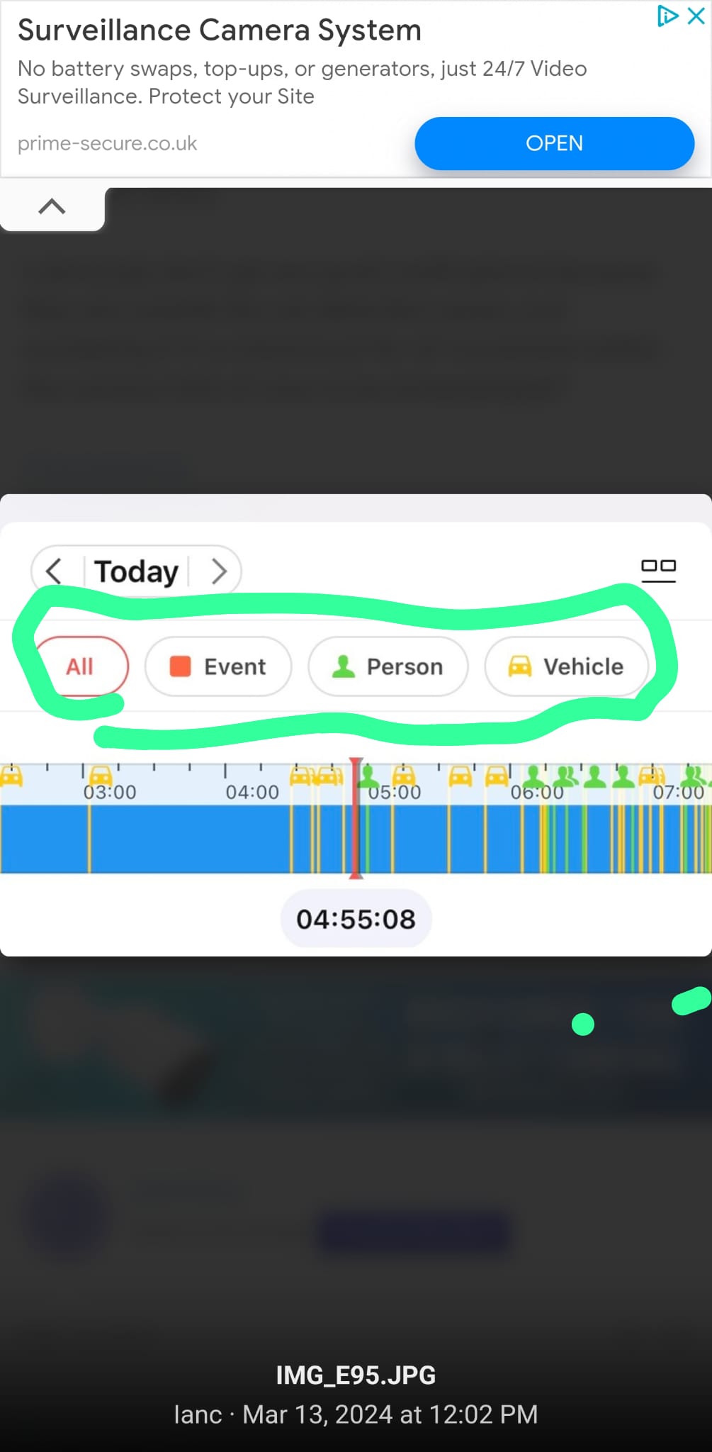

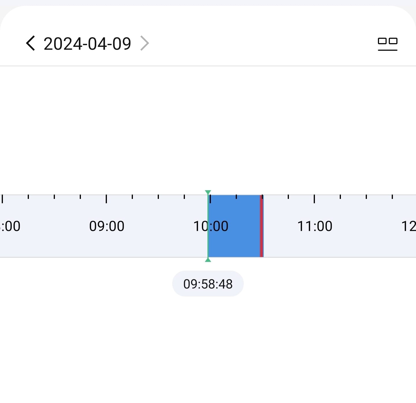

Any help would be great. I have attached 2 photos, 1 photo is what I see and 2nd photo is what I used to see before factory resetting my NVR.
