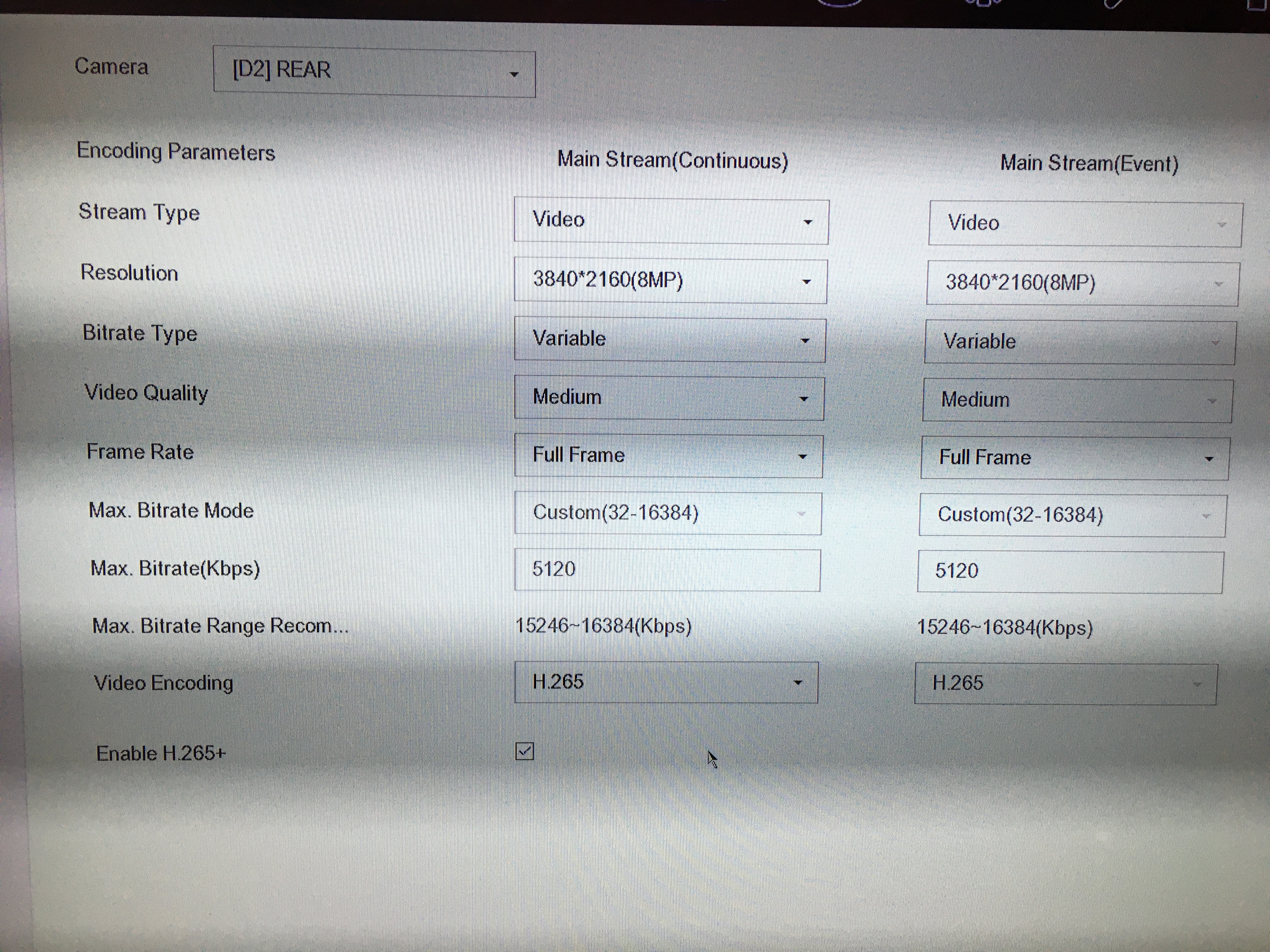

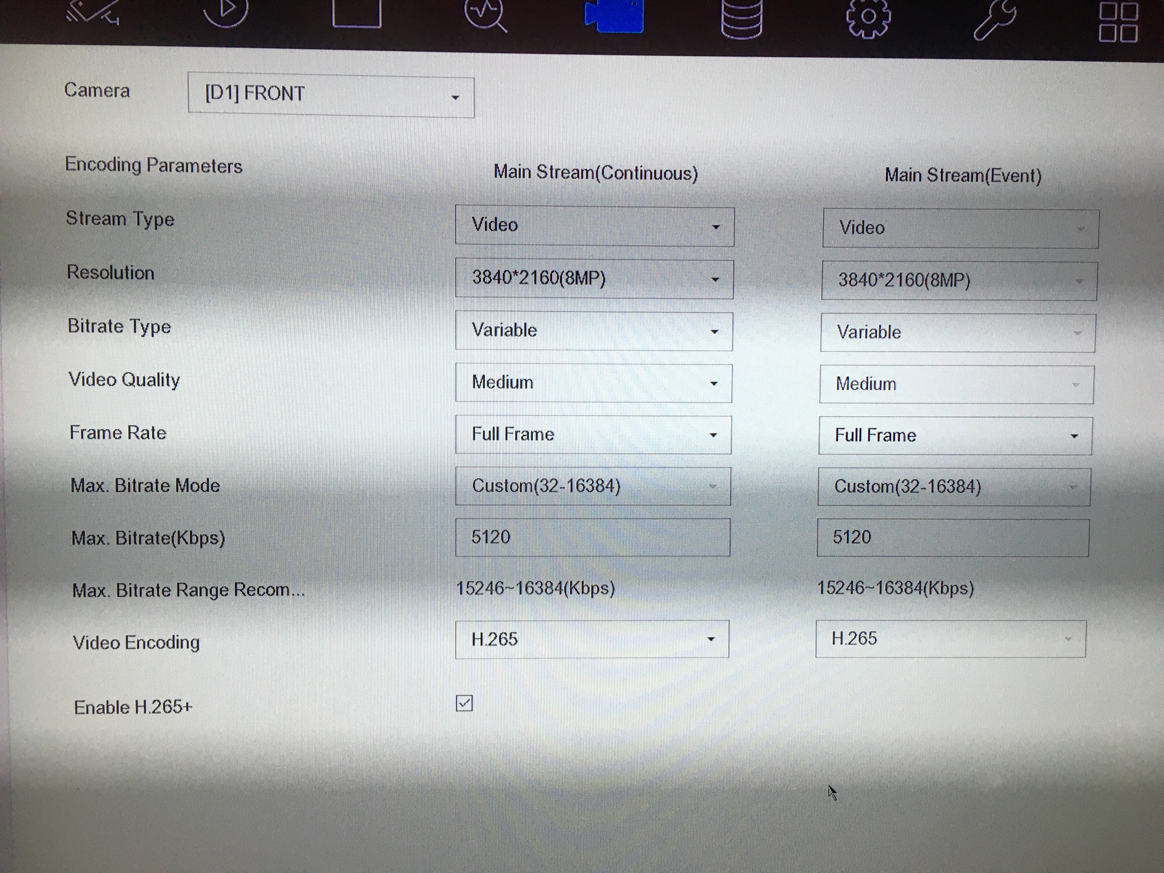

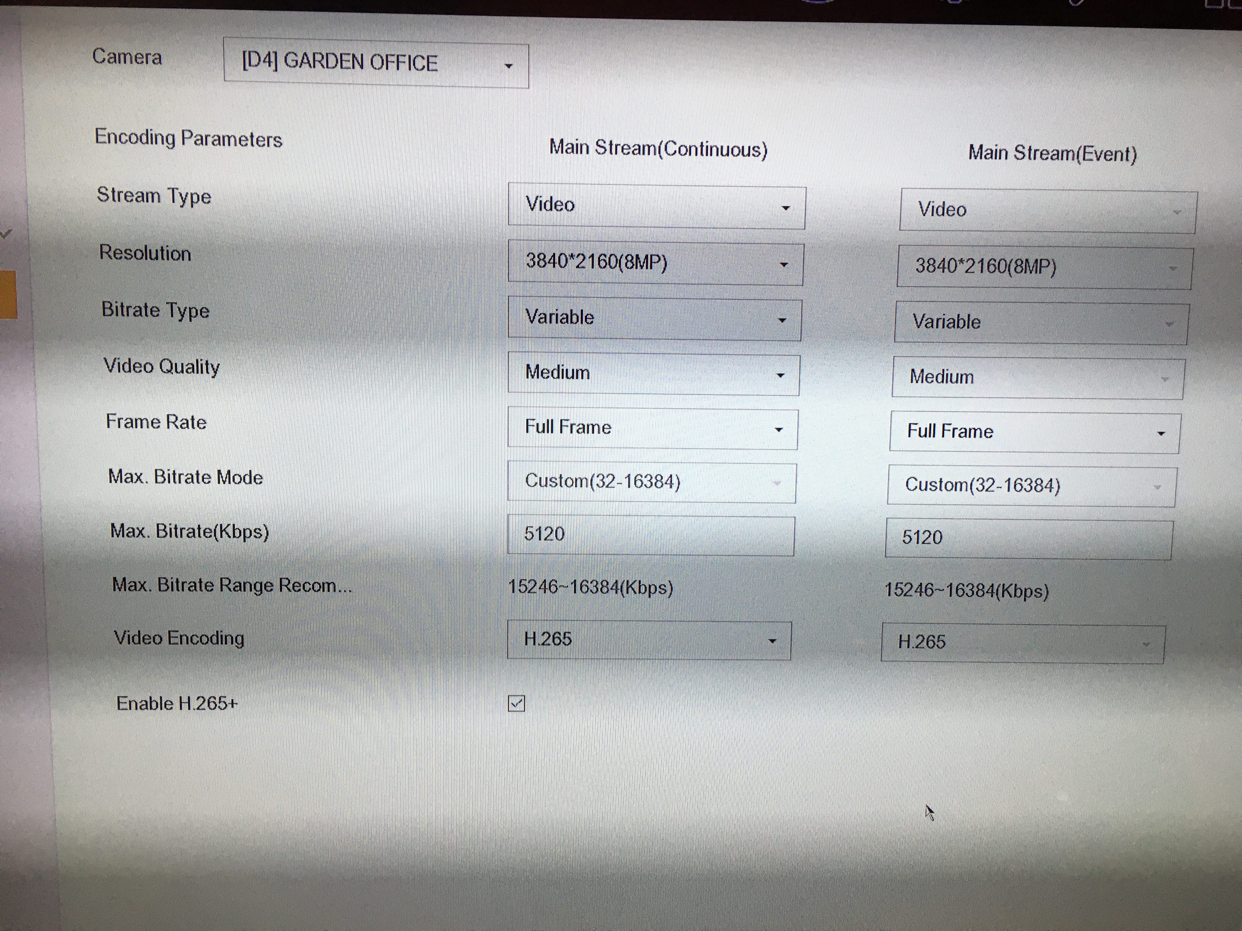

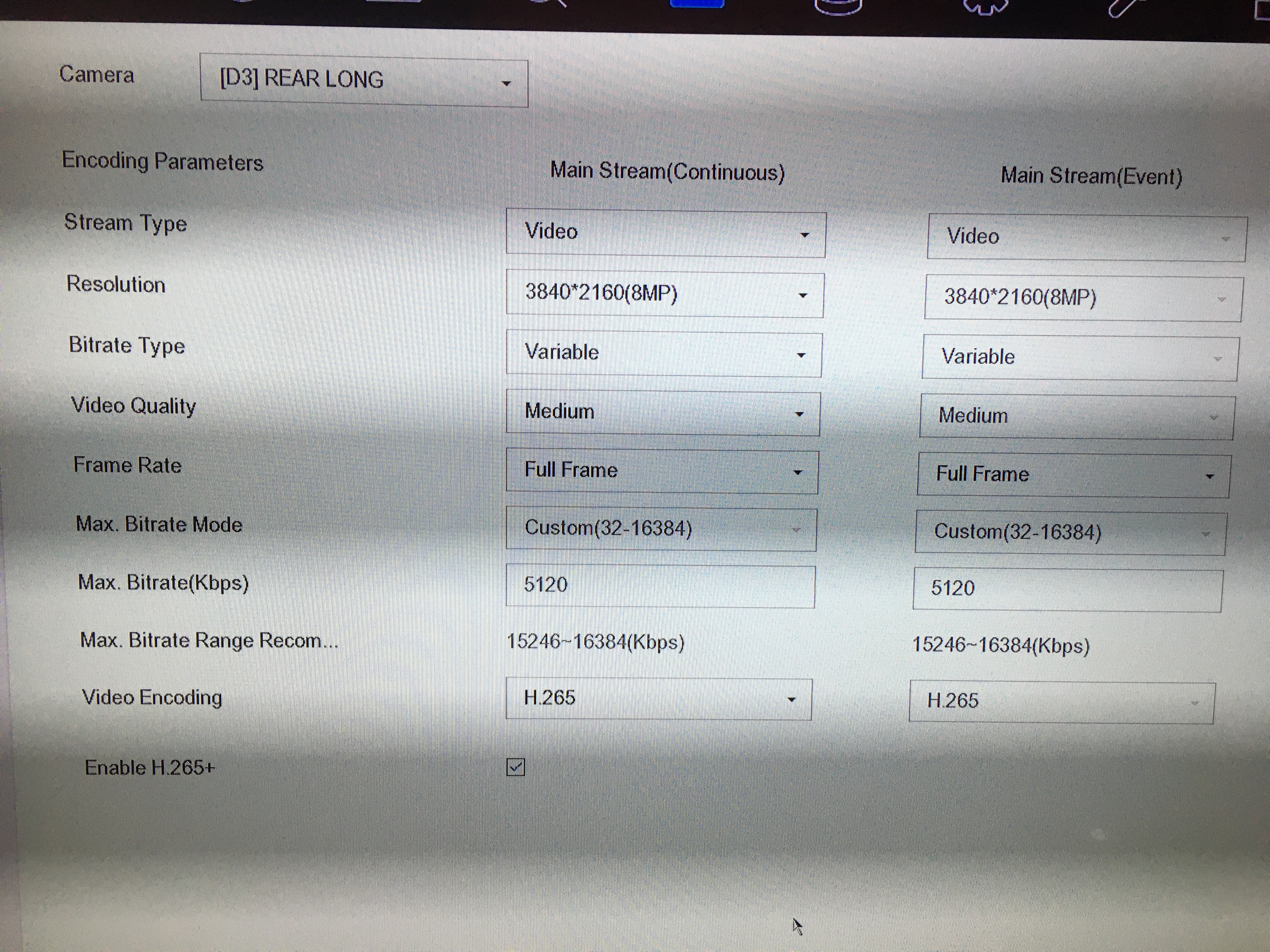

I have had 3 cameras connected to an 8 port NVR over POE. All of these have been displaying a LiveView fro HDMI connection to a Samsung screen. All 3 camera are set to 8MP under Main stream. I recently added a new turret as the 4th camera (IP connected not via a POE port on the NVR) and this causes one of the other main stream live view to show as No Resource when in a 2*2 live view configuration.
Reducing one or two of the cameras to 4MP Main Stream fixes the issue as does using the low res sub stream in the live view.
I am wondering why the live view in a 2*2 split screen cannot handle all 4 cameras set as 8MP?
I updated all cameras and NVR to latest firmware yesterday.
