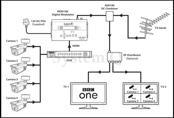

Hi there, If you had the output from a traditional analogue CCTV camera, then you would be able to use an encoder to create an IP video stream - Search results for: 'encoder' ¦ use-IP Ltd
However, your CCTV has already been converted from analogue composite video 1 volt peak-to-peak to a TV signal (or whole system output as HDMI as shown below) via an RF modulator i.e. converted to a certain TV channel and distributed throughout the building.
I'm not aware of any gadgets to convert this to an IP stream.
Perhaps you could use a TV capture card?
Image credit: System Q
Phil, thanks for that. Obviously not what I really wanted to hear but at least I know how to implement a solution. I'll stick a USB tuner into the PC for now and I should be able to record the CCTV feeds. Will be slightly more complex when I introduce the NAS but I'm about £1000 away from that at the moment :)
