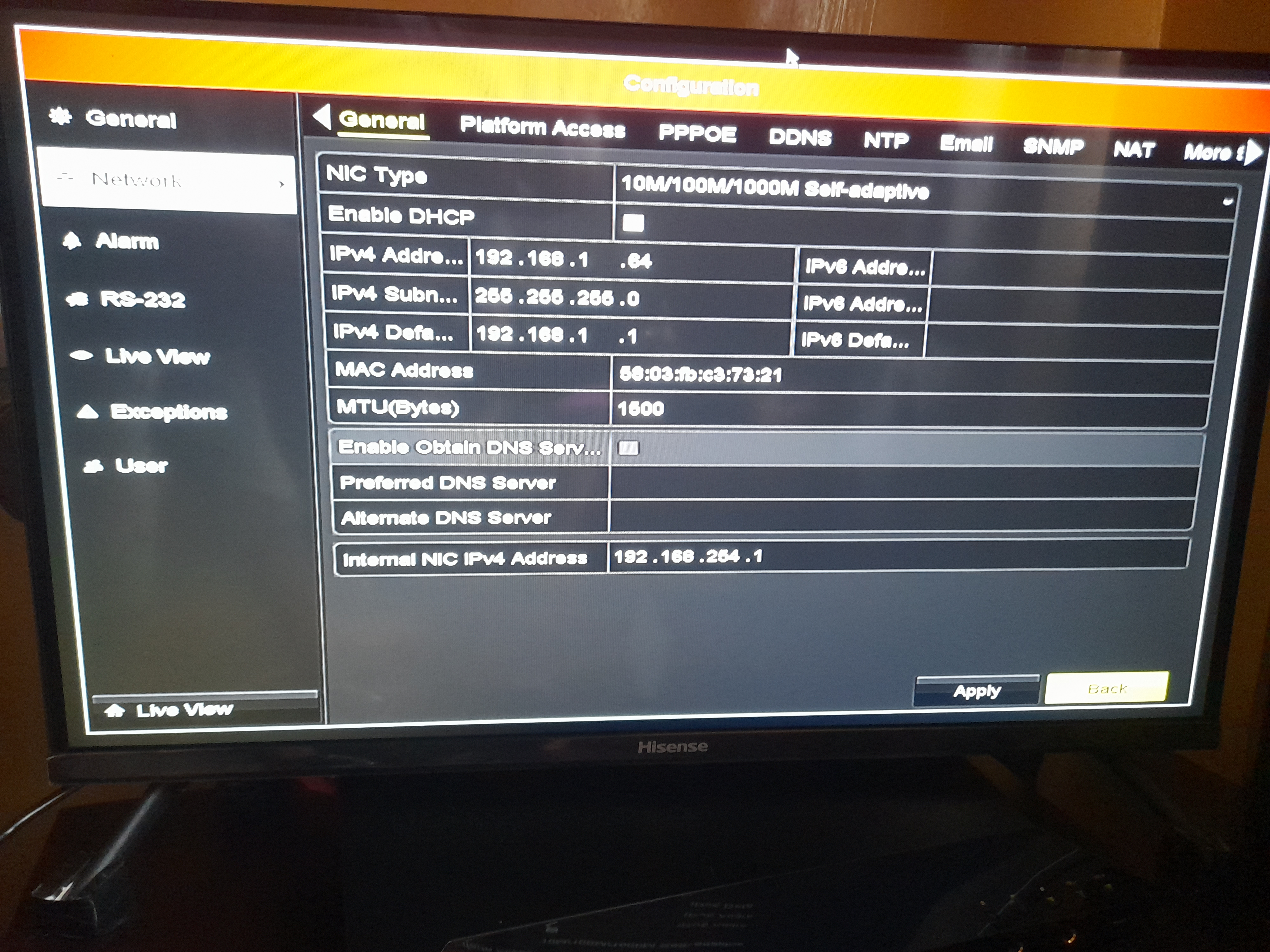

Hello, someone help me, my nvr ds-7716ni-k4, its ip address is different from the one that i saw on SADP tool try to change but it still the same and nvr already reset.

Where are you seeing the different IP address when you're logged into the NVR? (can you share a screenshot?)

Thanks @digTechnologies
Your NVR and SADP are showing different IP ranges (192.168.1.xxx and 192.168.2.xxx) so we need to figure out which IP range your local network is using.

The time i configured the nvr, it was offline, just NVR, my PC and a camera. I set a static IP on nvr but moment i check to the SADP tool it shows no changes.
What really happened to my nvr. Try to reset but still the same problem.
