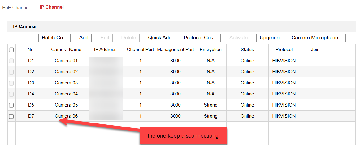

Whenever i restart the NVR i have to re-configure the events and select send email for each camera.
The other issue is one camera keeps disconnecting.
To make it work i have to disable PoE channel then restart the NVR then enable PoE channel and restart the NVR again.
This keeps happening every day.
Any idea how to resolve?

How many cameras do you have connected? 6
Is this problem camera a different camera model to other models connected? All connected camera are same model, one of them has this issue
Is it wired differently? No
Are all using POE from the NVR? yes.

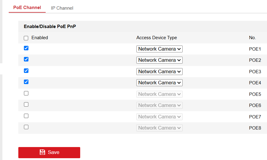

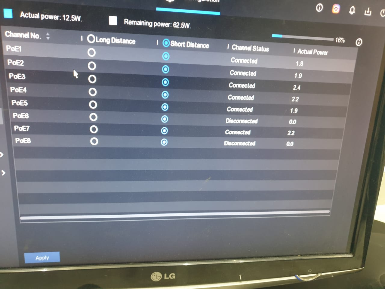

i changed setting for the camera as following:
i changed port (NVR 8 port, connected only 6 camera) it works for 24 hours then again disconnected.
i disabled POE and restart NVR, it detect the camera and it works, after few hours again disconnected, i restarted NVR it works again

i have other camera in a longer position and works fine
Have you tested with this camera temporarily connected to the NVR using a short, factory made, non screened, patch lead?
To rule out ANY issues due to the installed cable.
It may also be worth checking that all your devices are running the latest firmware; we just tend to do this first as a matter of course when fault-finding 'tricky' issues.
