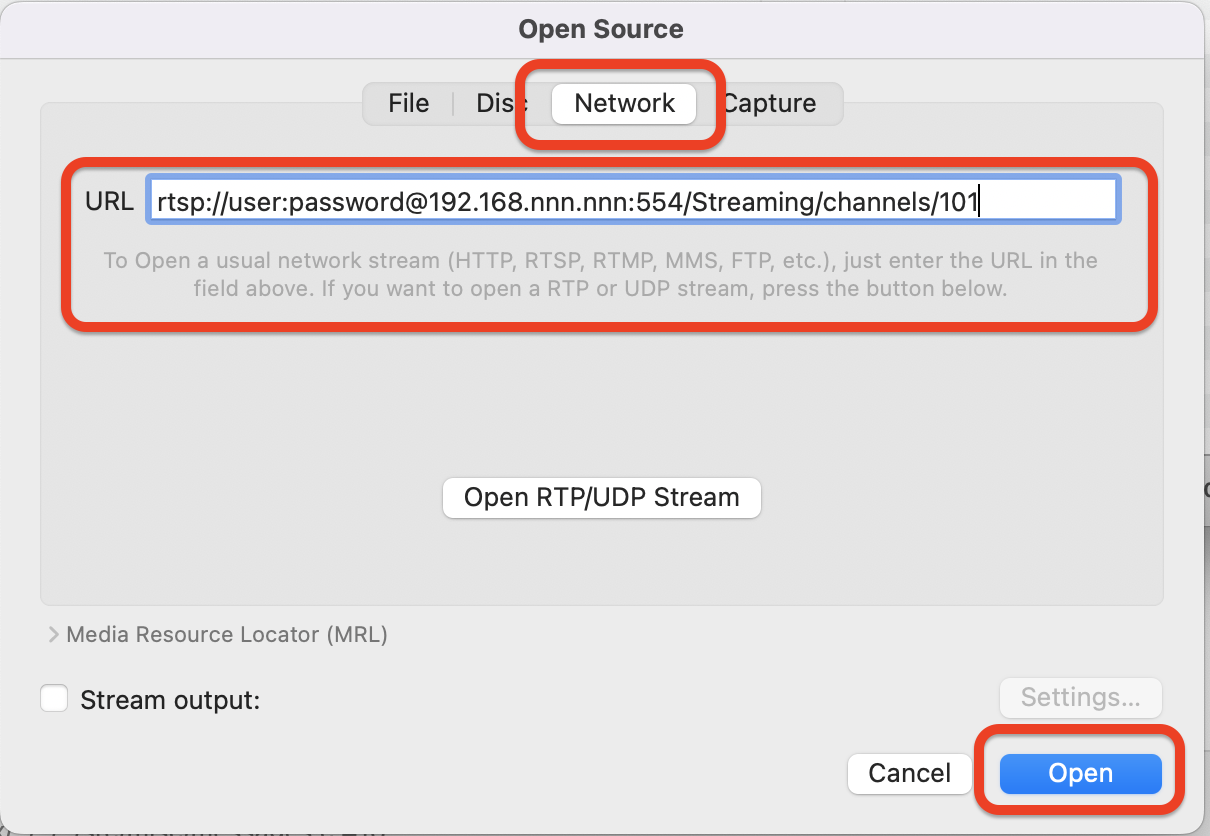

Can you play the camera mainstream (4MP) rtsp url using VLC?
Didn't know you could do this I will try tonight when i get home.
MacOS VLC
File> Open Network.....

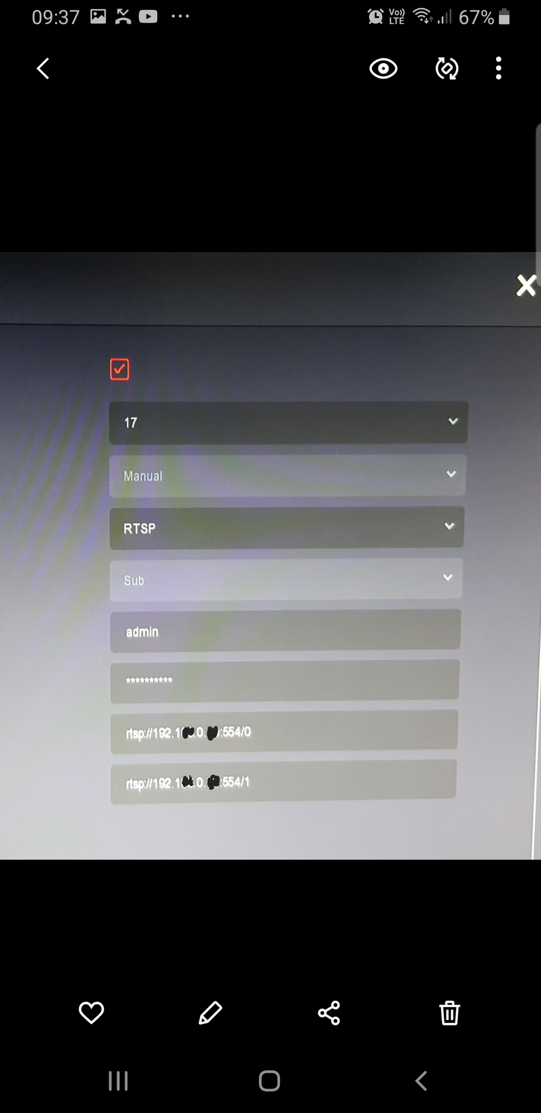

DVR is set up with these settings . Think you may have prompted the issue with the Resolution using RTSP if you look at the settings the ones in grey can't be changed so it is using the Sub Stream

David in the picture above i am going to try changing the 554/0 with the 554/1 to see if it will give me the main stream on the substream to fool it. Let you know later when I get home cheers
Sorry forgot to update. This didn't work. Pulling my hair out now I think the hikvision camera and my DVR onvif protocal just don't speak the same language. As I tried a cheap Escam ip camera and it works fine in onvif.
