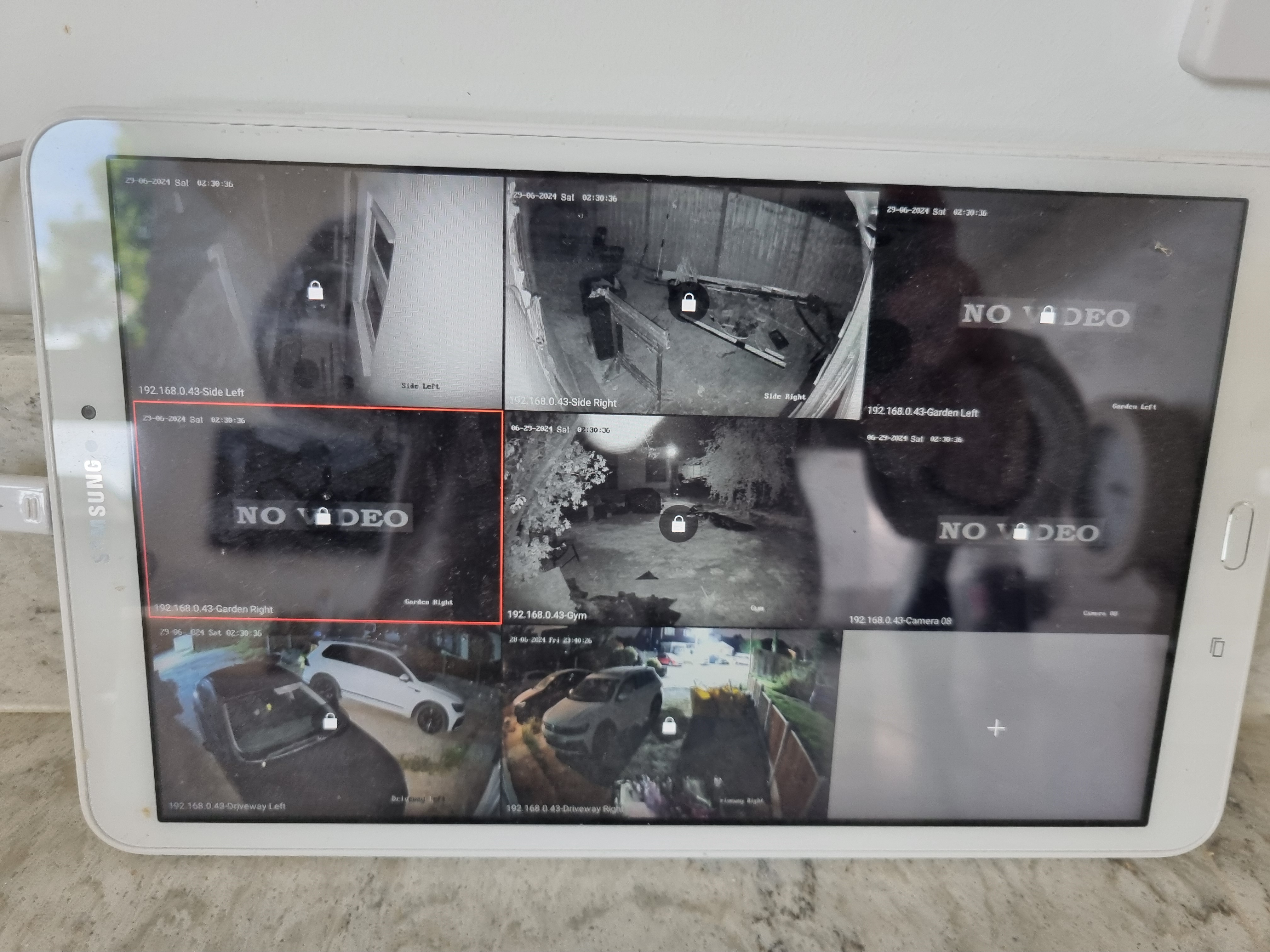

Good morning,
My hikvision app through Samsung tablet, keeps requiring the code and has a padlock?
It does this every other day.
I've got 5 analogue and 2 ip cameras
Thanks for your help

The padlock usually indicates that Stream Encryption is turned on. It can be disabled in the Platform Access menu of the recorder or in the Hik-Connect app. I’m guessing that you might be using the tablet to connect to the system using its local IP address when at home and so the key is needed each time.
Yes I've got them on a tablet using local. I'll disable and see of that resolves. Thanks for your help
With stream encryption enabled, Hik-Connect decrypts the streams for viewing when connecting through the service. That doesn't happen when connecting using a local IP and so you need to enter the key. If you need to keep the encryption on, you'd need to stream to your tablet while using the Hik-Connect login but that will limit the stream to 5 minutes before reconnecting is needed.
