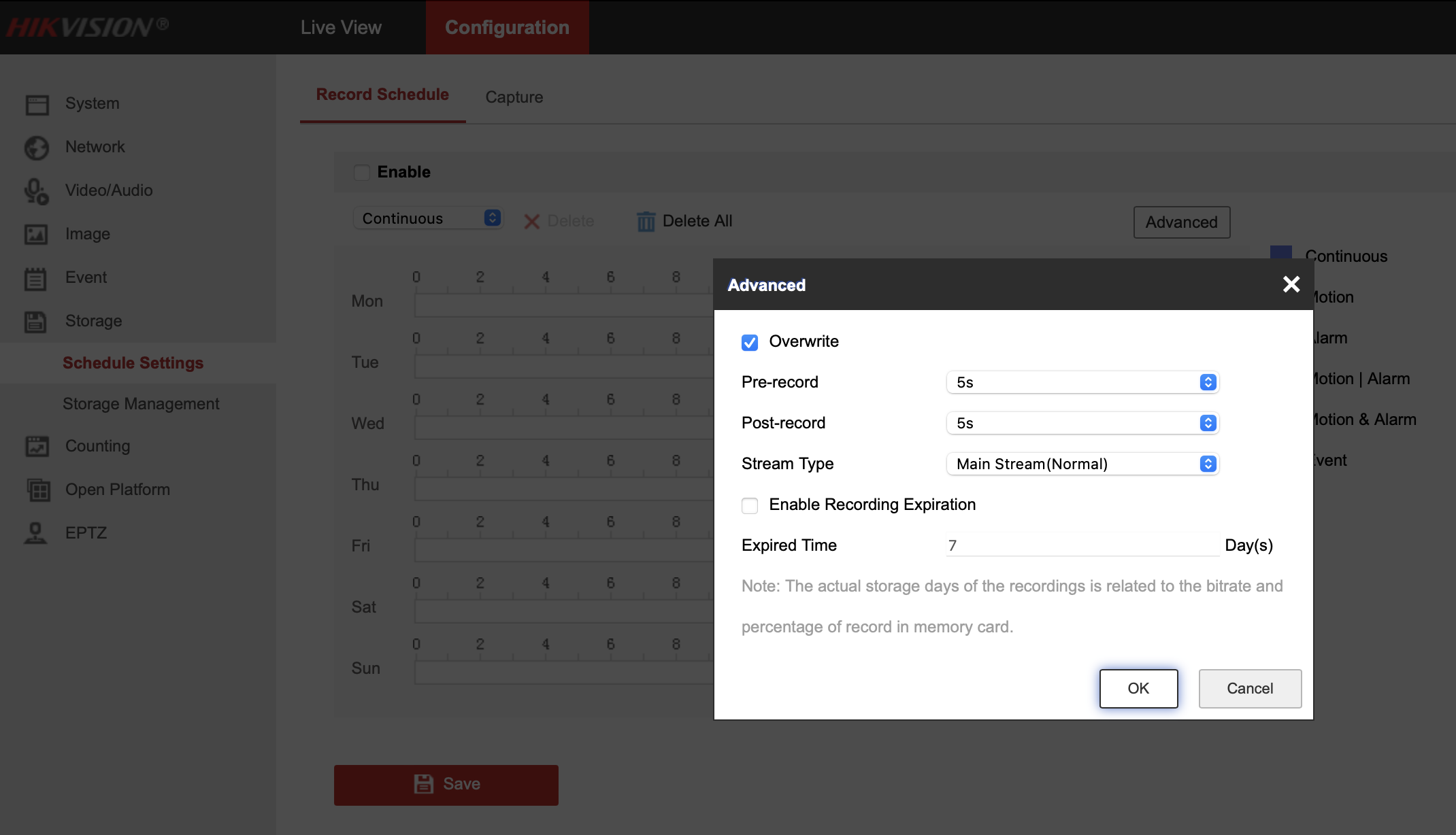

If you have them set to record motion only, it sounds as though you're wanting then to record a little longer after the initial trigger? If so you just need to adjust the post event recording duration. In the camera web menu go to:
Configuration > Storage > Schedule Settings then click on the 'Advanced' box.
You can see on the image of one of mine below that the default is to record 5 seconds before and 5 seconds after the trigger. Just up the post record time to 20 or 30 seconds. That'll avoid the situation where someone is stationary for a few seconds and it stops recording.
