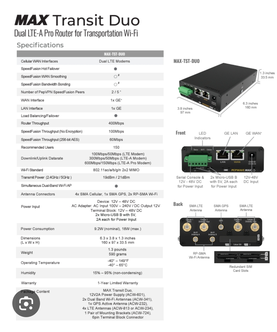

Could you post a link to the technical specifications?
David
This is is

There is probably a security feature enabled to automatically reconfigure the device. Disconnect all the antennas just after the factory reset has finished.
