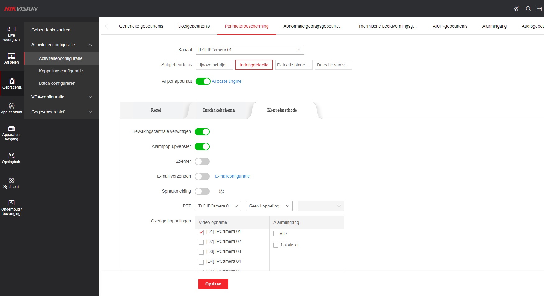

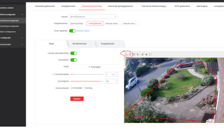

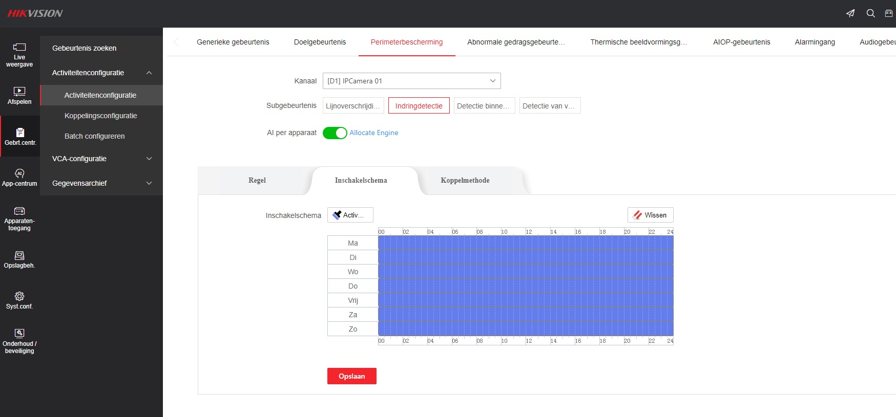

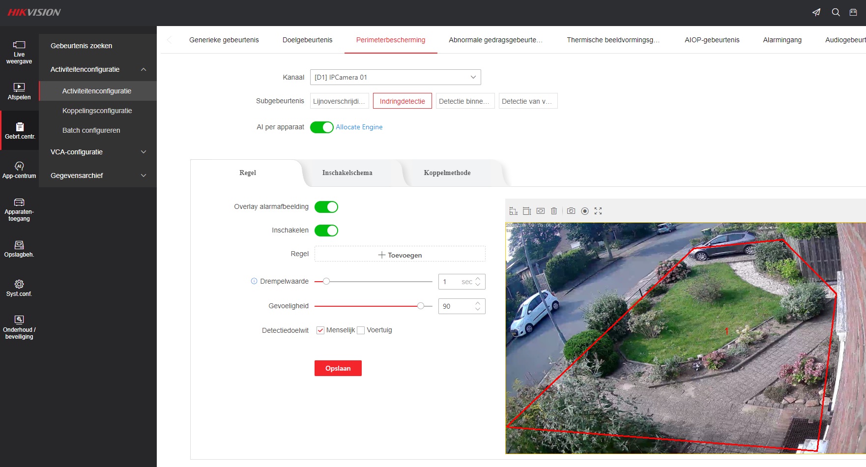

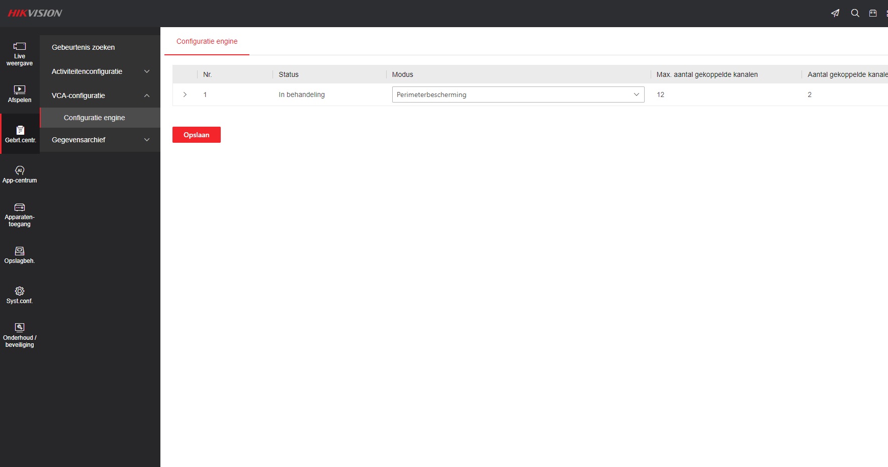

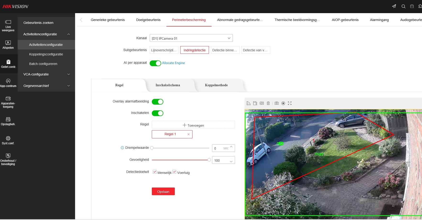

I have included a few screenshots with the settings. I've also searched the internet, but I think I'm doing exactly the same thing.

On first image i don't see you drew/set Min/Max values to give margins for detection calibration. If there are no margins , it wont work.
Only way it would work if it was set on Motion Detection 2.0 with just area , but you are using Intrusion where it has to be.

Setting the min/max did not work. I can dance to it all I want, but nothing happens.

Look at your first image, you need to draw minimum and maximum sizes for detection, as there are none it wont detect anything.
Everything bigger than minimum and everything smaller than maximum will enter Object detection algorithm
