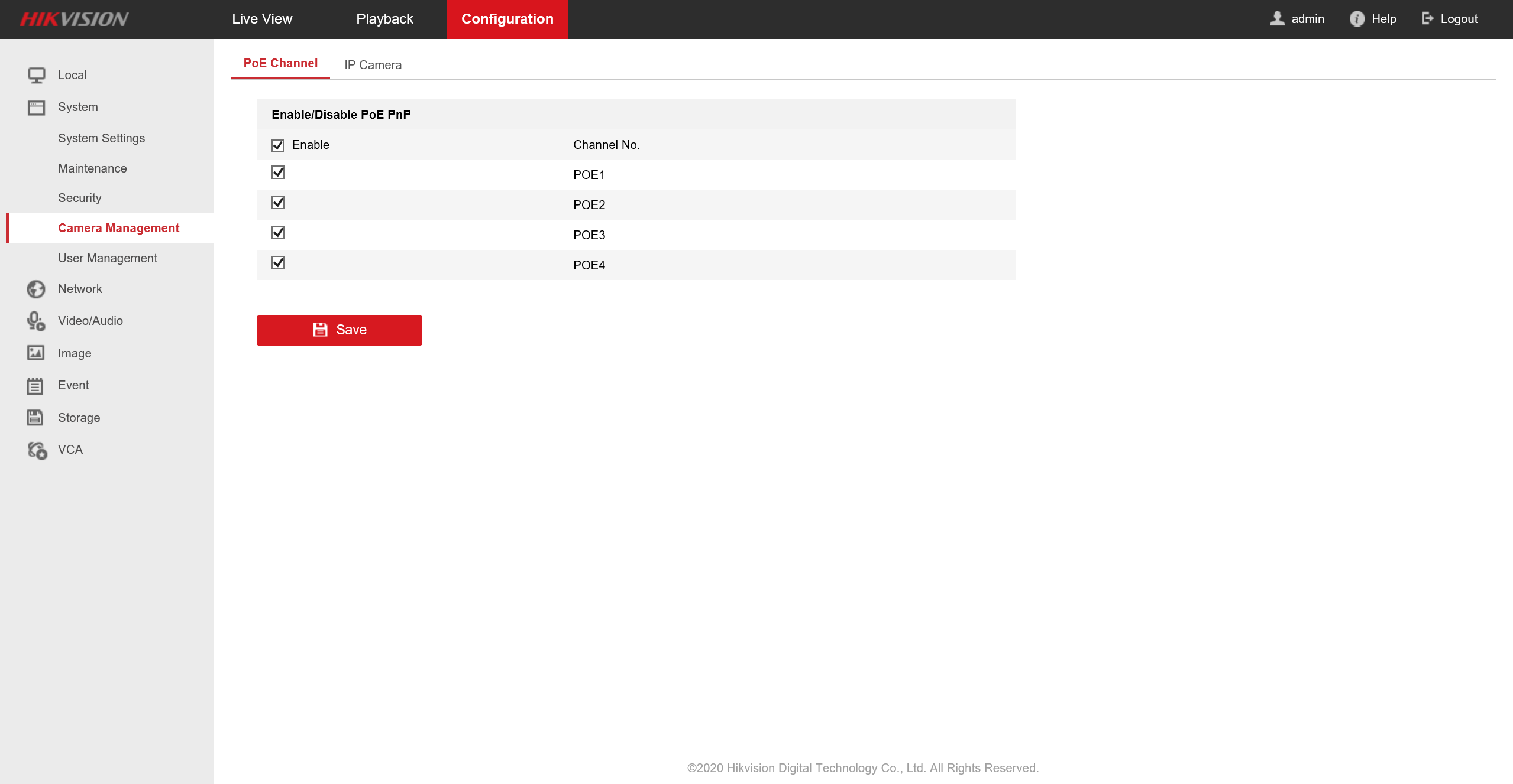

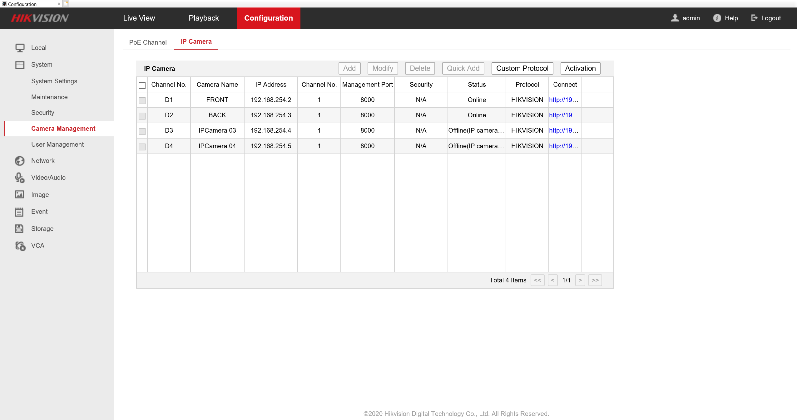

Can you please upload a screenshot of the Camera Management page from the NVR's Config?
Yes, Only 2 cameras both connected direct to NVR using POE.
