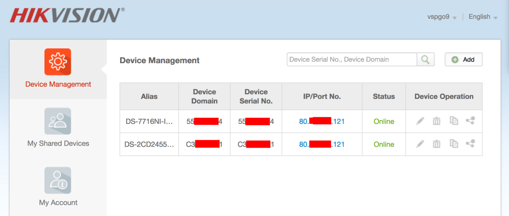

All being well, you should see your Hikvision devices showing at the portal as 'online' and reporting their current world wide web IP address:

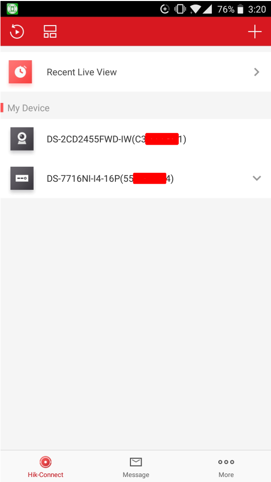

Install the App on your mobile device, and sign-in with your user name and password that you used to create your account, and you should straight away be able to access the devices that you added at the portal.

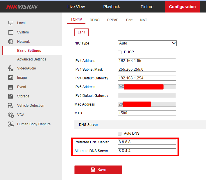

THE most common problem that prevents this solution from working is the lack of DNS settings being entered in your camera or NVR's Configuration settings.
Without DNS settings your Hikvision device is unable to lookup and contact the portal.
These settings can be found in Configuration -> select Network, Basic Settings at the left -> select TCP/IP at the top (usually it defaults to this)
We would recommend that you set your DNS settings to Google's DNS servers as below:
Preferred DNS Server = 8.8.8.8
Alternate DNS Server = 8.8.4.4
Don't forget to click 'Save'.

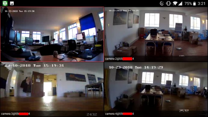

In the App on your mobile device you should see something like this:
