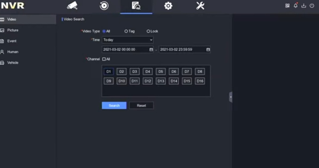

In the meniu I have only search button for footage, I entered to the meniu, I pressed the searched button I selected time 7.30 am to 14.30 pm I have searched the footage, and appeared 6,7 captures to 7, 30 to 8,30 and so on , 6,7 captures , havecI selected all?

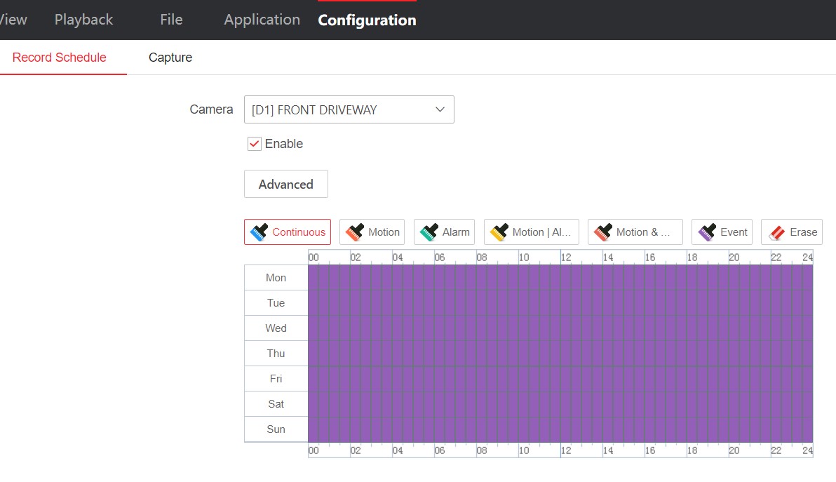

When you say "appeared 6,7 captures to 7, 30 to 8,30 and so on , 6,7 captures" that sounds like you have sporadic footage in the playback timeline which would suggest your camera is not configured for continuous recording and thus you won't be able to export the whole 7hrs.
Have you checked the NVRs Record Schedule to see if this camera is configured for Continuous or Event recording?

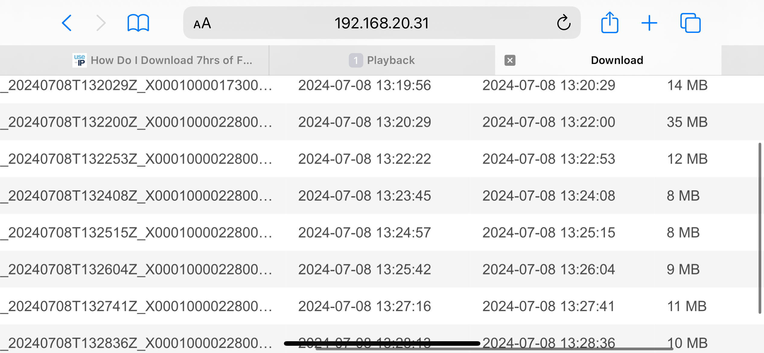

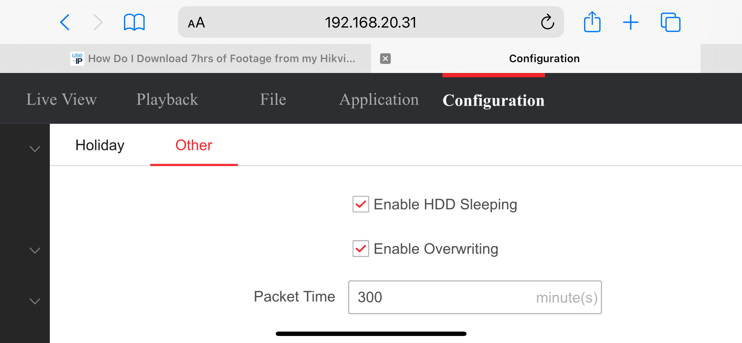

So the NVR breaks up your continuous recording into set packages of footage that are usually around 30 minutes in length by default, so if you wanted to download 7hrs of continuous footage you would need to download the multiple packages of footage that make up that 7hrs.
You can extend the duration of these packages, but I don't think you'll be able to extend it long enough that you'll get the whole 7hrs in one file.

That is what I thought, if you want to download all 7hrs of footage you will need to go into those search results (as is shown in the video) and select the multiple files that cover the 7-hour window you want to download.
You won't be able to download just one file that contains 7hrs of footage.
