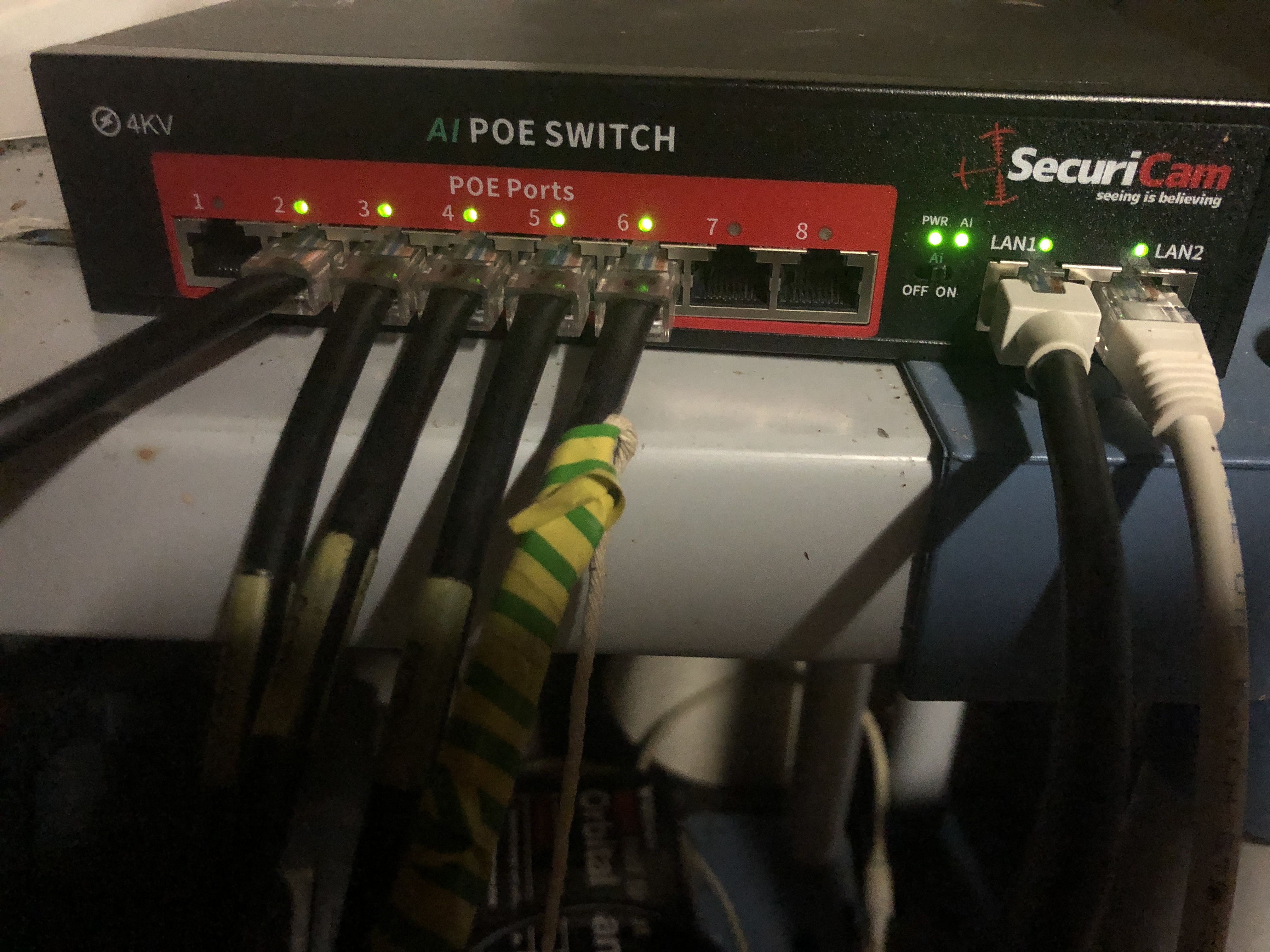

Attached photo is of the switch showing all the ports lighting up

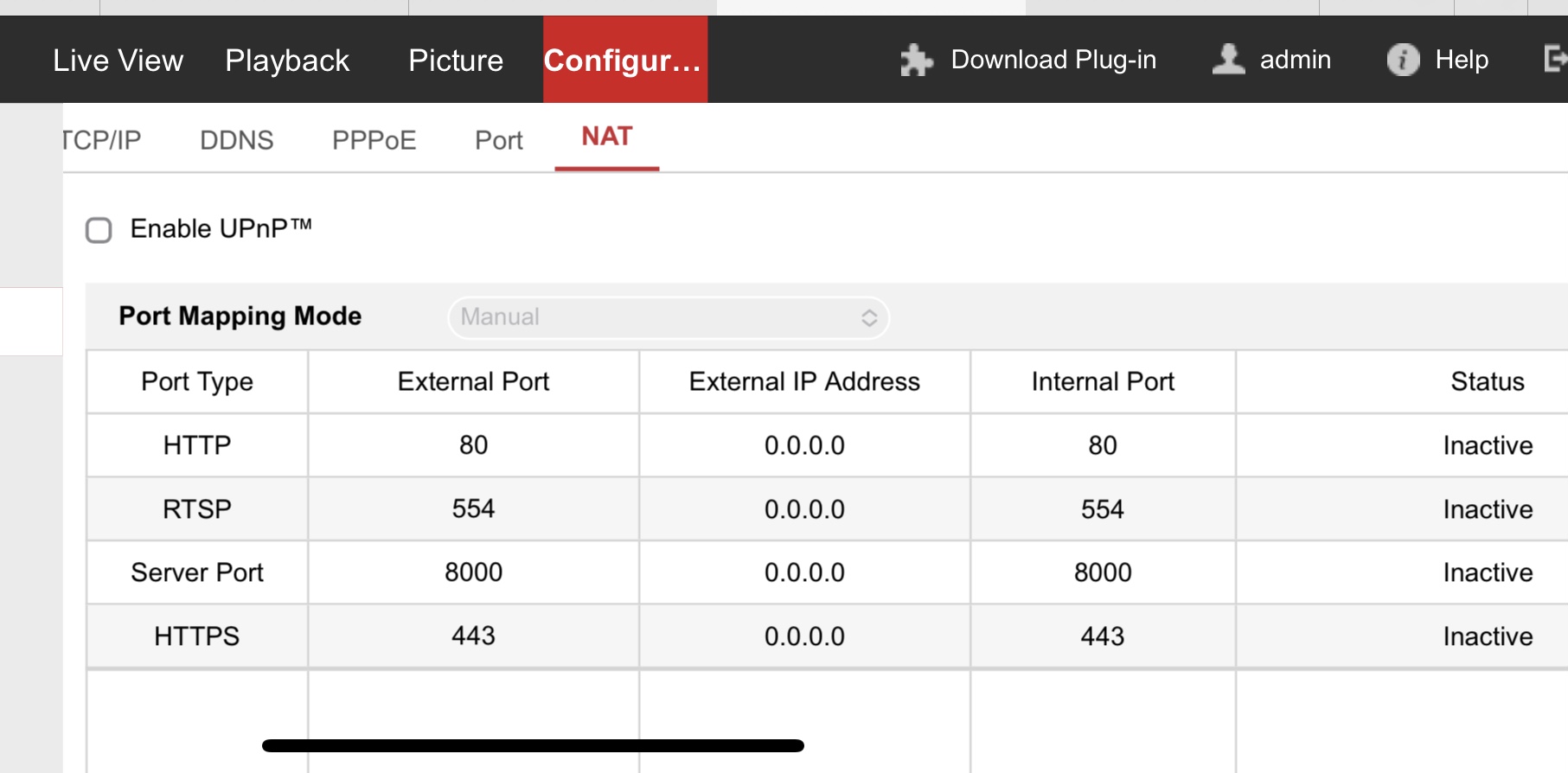

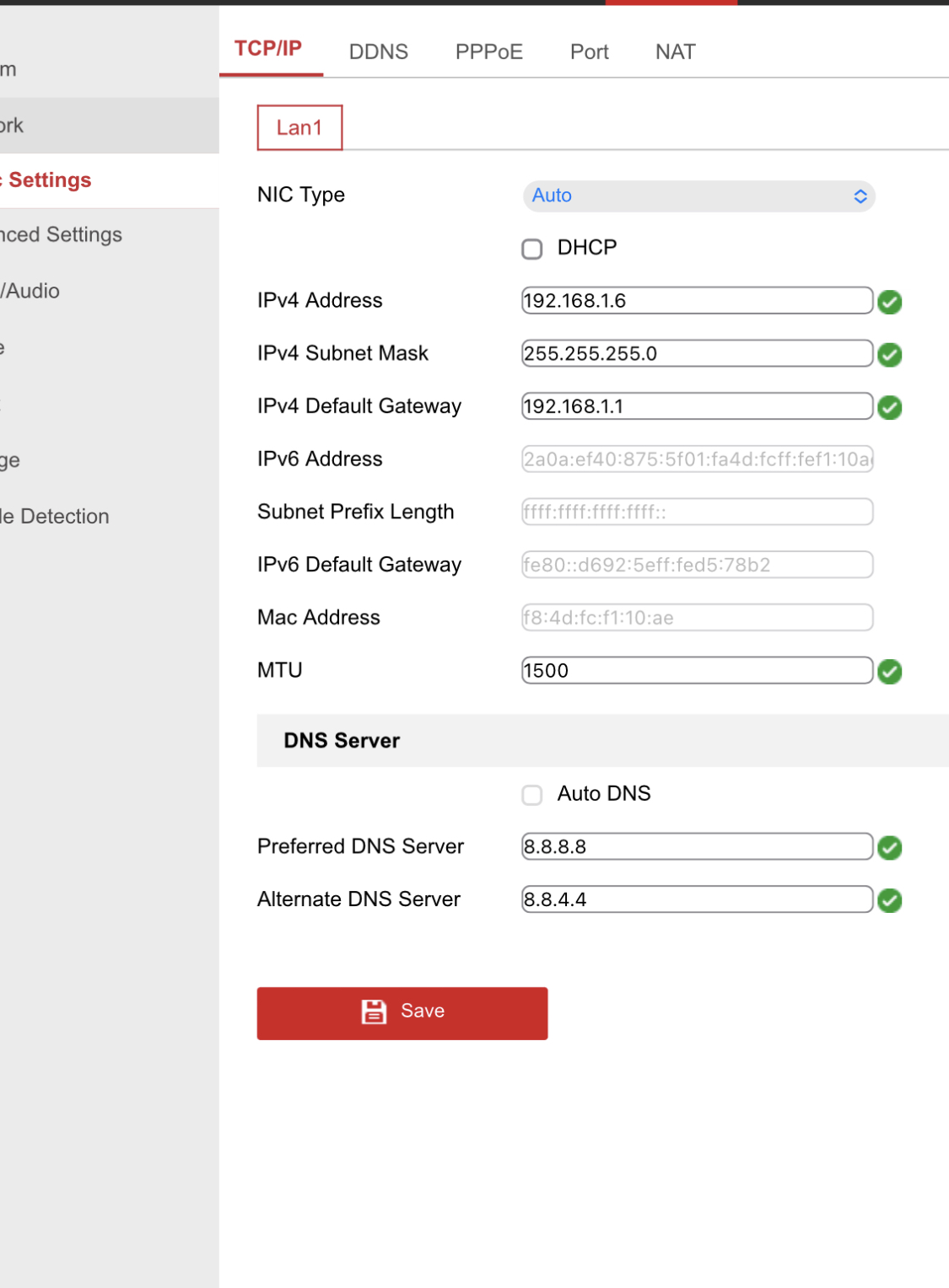

Can you please share a screenshot/photo of the NVR network settings?
Hi @Chip

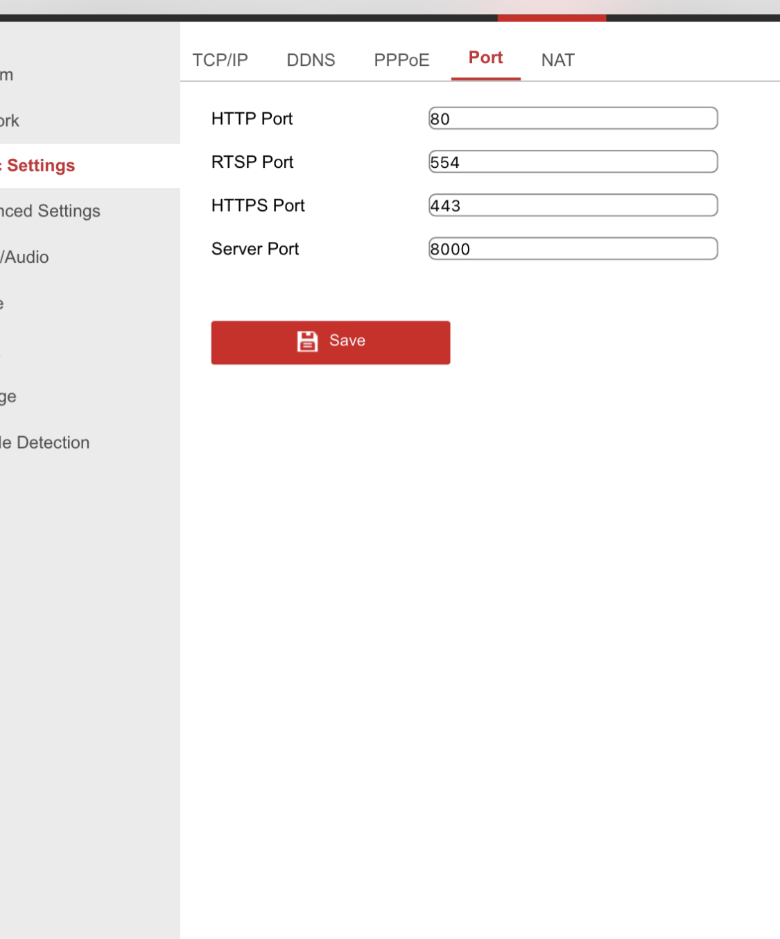

Cheers, Dan. Please see attached (I’m never sure what I should / shouldn’t share or blank out, so let me know if I need to redact anything!)

Thanks @Chip
Please delete the Basic Information screenshot, I don't really need this information and we don't usually recommend making public the full Hikvision serial numbers.

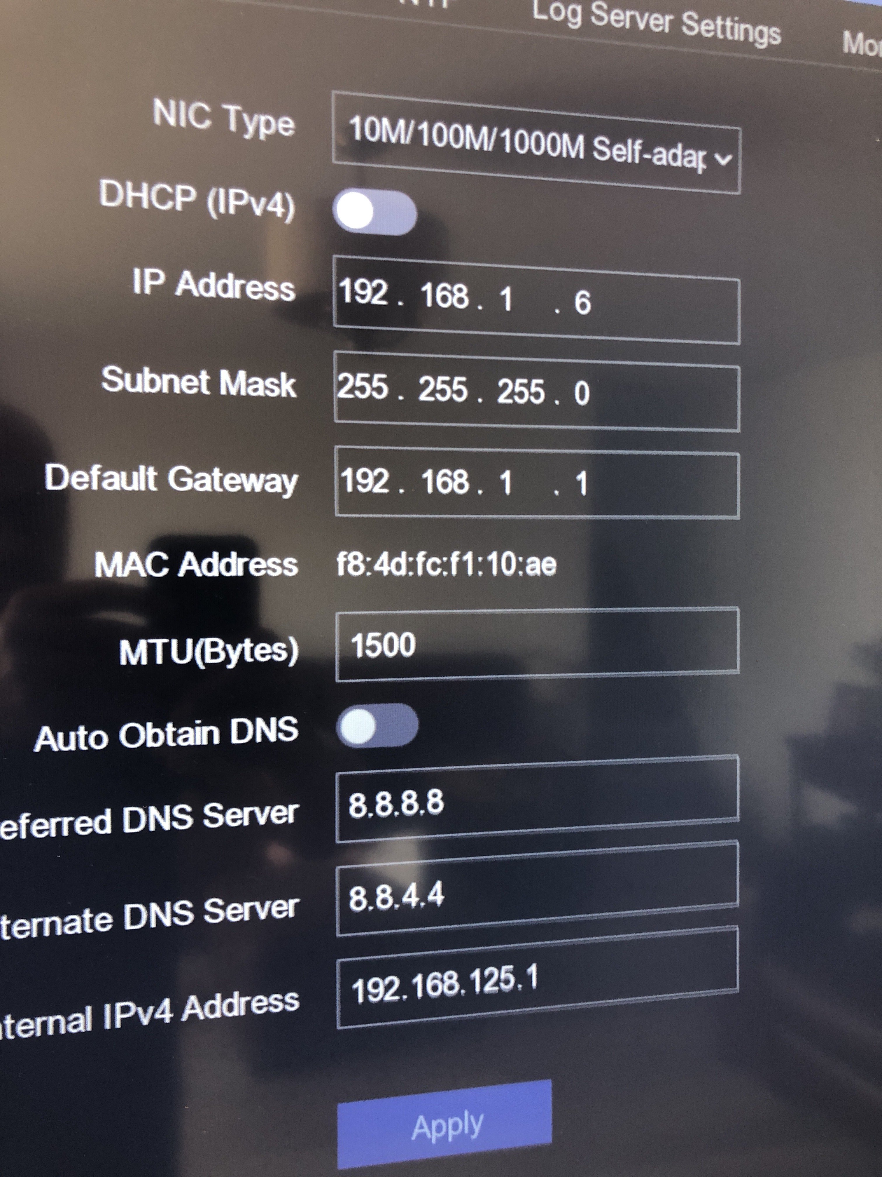

It's strange that you have a PoE NVR, but there are no details in the network settings for the "Internal network card IPv4 address" which is the IP address range used by the directly connected cameras (which is usually different from your local network IP range), are you accessing the NVR remotely or from the same local network as the NVR?
This is the screen from the VGA/HDMI
Thanks,
So your NVRs internal PoE port IP range is different to your local IP range, this makes it unlikely that the cause of the problem is an ISP/network issue.
If your local network range were to change when you changed your ISP this would only impact the cameras NOT directly connected to the NVR and the cameras directly connected should still function fine because they are assigned IP address from that internal IP range (192.168.125.xxx) would still be the same after changing your ISP.

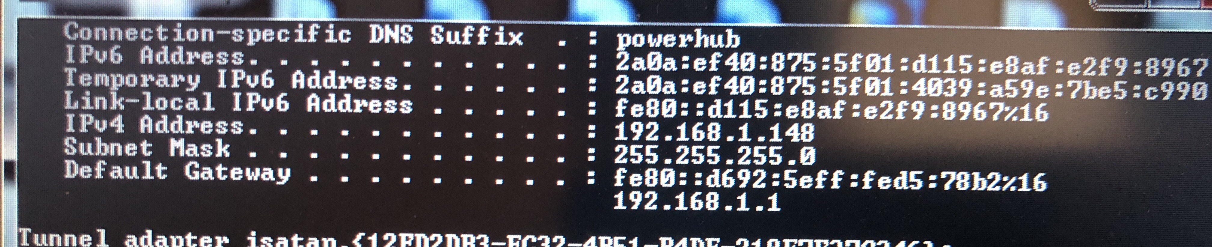

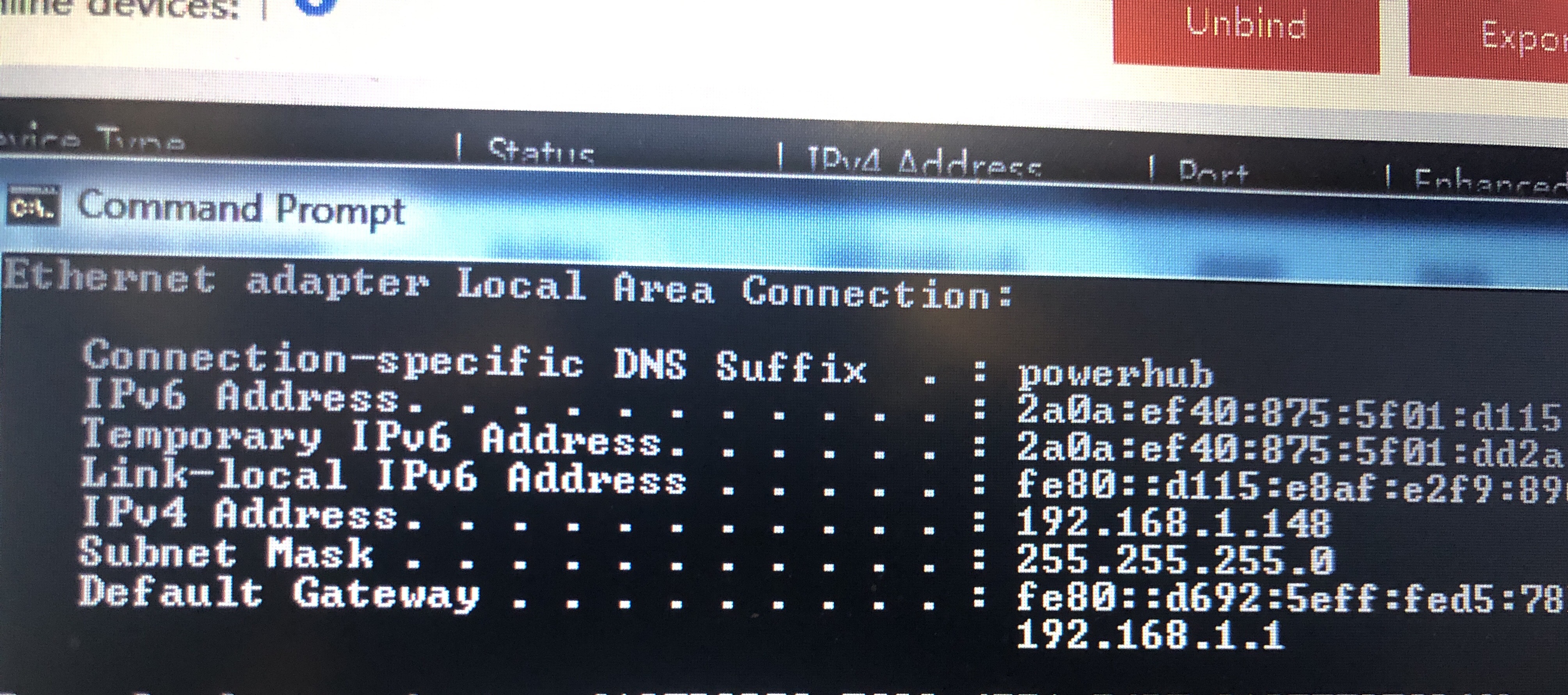

Connected into the main ISP router we have an AMPLIFI mesh system. I was connected to this earlier (in the house) when I ran the ipconfig
However, having gone down the garage to open the SADP tool, I connected my laptop to the PoE switch and ran ipconfig again. This time i got the attached IP info. I then plugged my laptop directly into the NVR and I then got the (same) attached IP info - which clearly differs from what my laptop showed when connected to the main wifi network (I believe that both the NVR and PoE switch run directly from the ISP main router)
So I’m not sure where this leaves us now…. Any further suggestions are very gratefully received and apologies for the confusion
