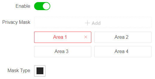

Hi. Unfortunately, all my cameras do not support this handy feature.
DS-2CD2047G2-LU (C)
DS-2CD2347G2H-LIU
DS-2CD2346G2-I
Here is the print screen. Only black mask type option available.

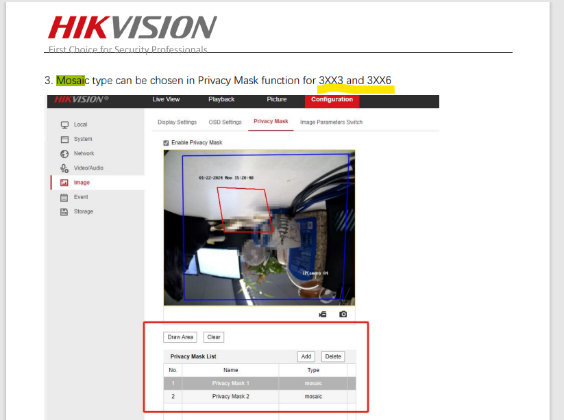

Mosaic type Privacy Mask, is only for IPC-3 series
Hi @tuil @alfaclvi
I've spoken to Hikvision support about this to get clarification and they've said this:
"Only 8MP cams support the mosaic mode. There is a future plan to add the mosaic mode to 4MP cams, but no estimated due date yet."
