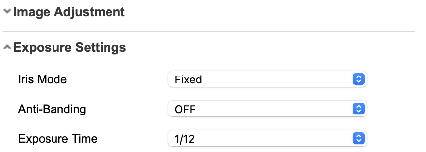

I set Exposure time to 1/50sec to help avoid motion blur. I switched to H265, Video Quality 'Higher', Max Bitrate 16,384 (it doesn't need to be so high but the M series NVR will do that for all of my cameras without issue)

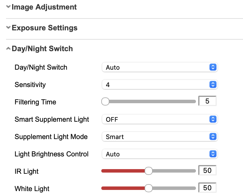

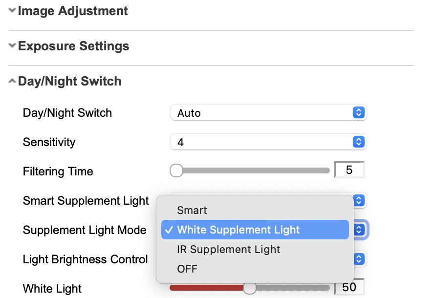

The images below show the additional options in the menu for the modes. As shown, you can alter the levels of the infra red and white LED illuminator separately:

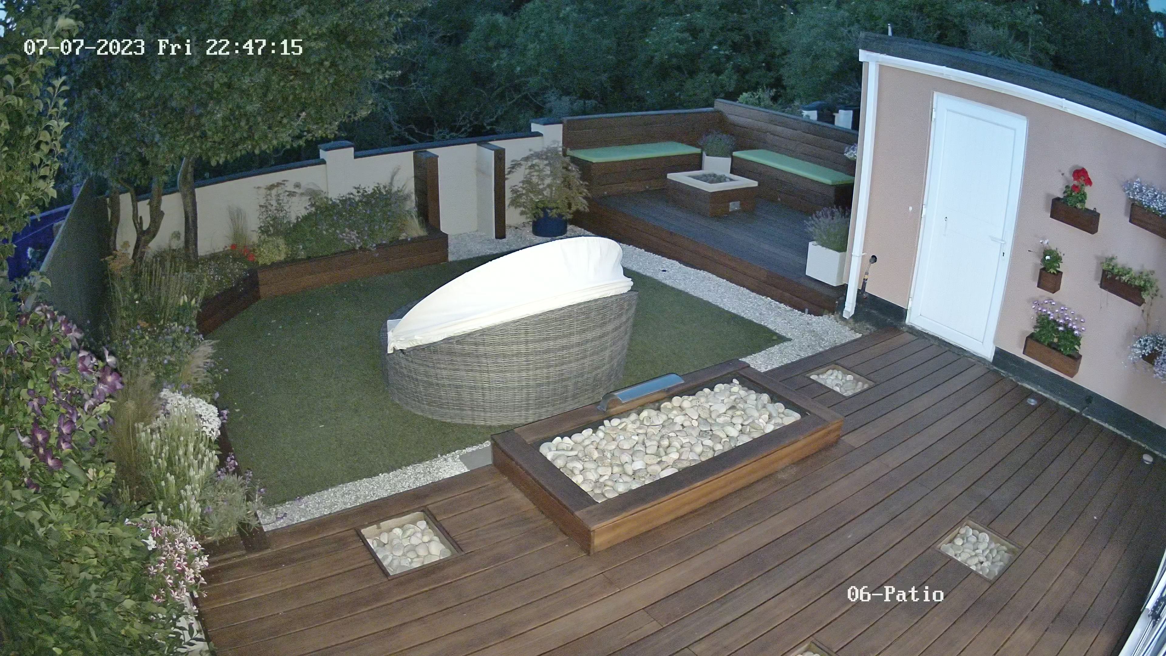

After triggering a motion event, the camera switches into Colour Mode and uses the white LED illuminator. As well as facilitating the exposure, the activation of the white LED is a good visual deterrent:
Again the image is well exposed edge to edge, with no obvious darkening in the periphery of the image.
The switching from infra red to colour is almost instantaneous following the event trigger - around a second. I have a security light (disabled for this test) that usually provides illumination if someone were to come into the garden. It's important to note, that while the security light provides great illumination and would switch a standard camera back into colour; that switchover takes 5 seconds as the filtering time cannot be reduced below that on any Hikvision camera. When I had an intruder in the garden a few years ago, they triggered the security light after climbing over the fence on the left of the image. However the camera didn't switch to colour until they'd walked across the field of view and were on the deck behind the garage. This Hybrid light model would've switched immediately, providing useful colour detail.

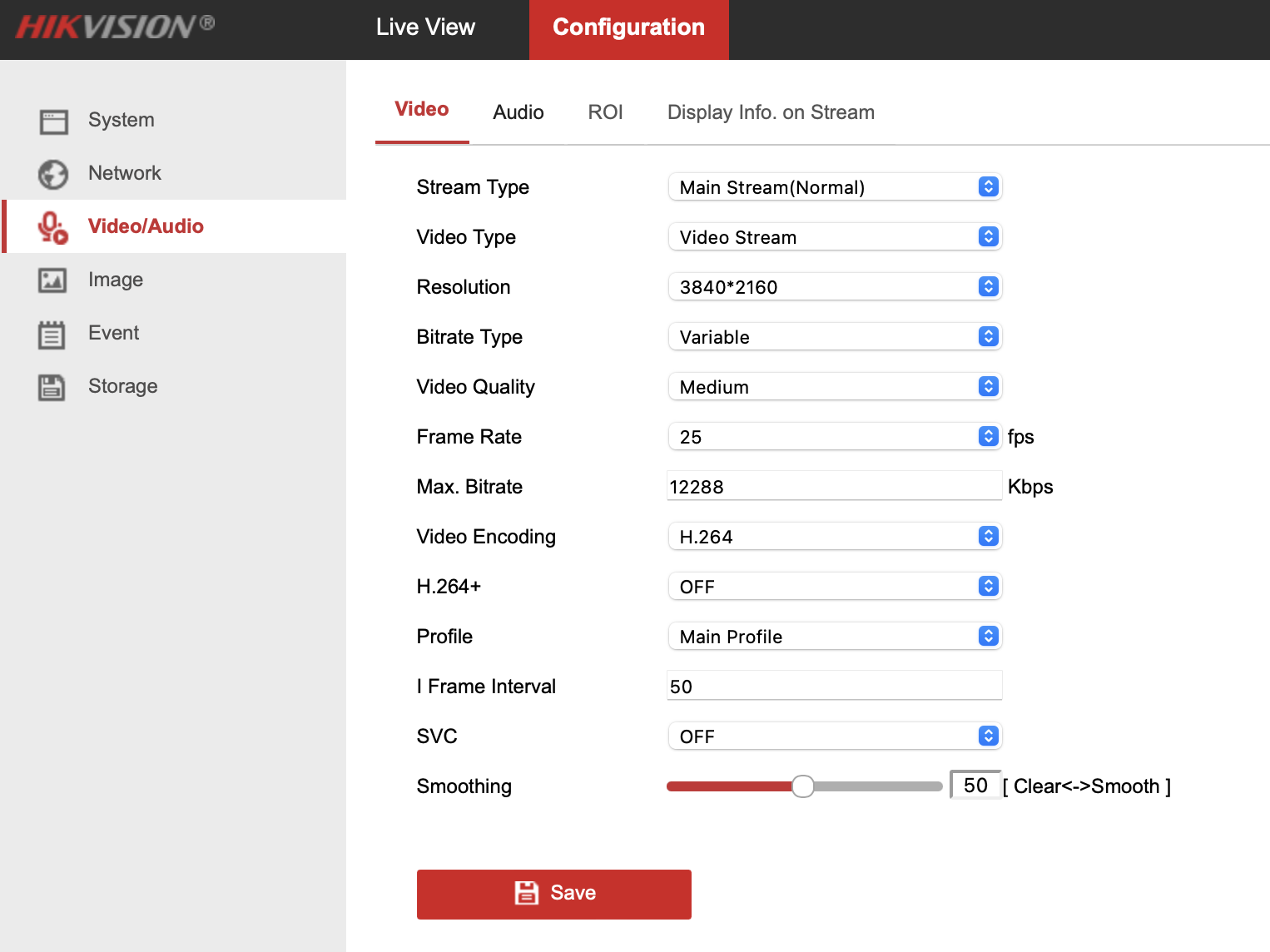

here the web view, i will put picture later
if you want specific screen, let me know

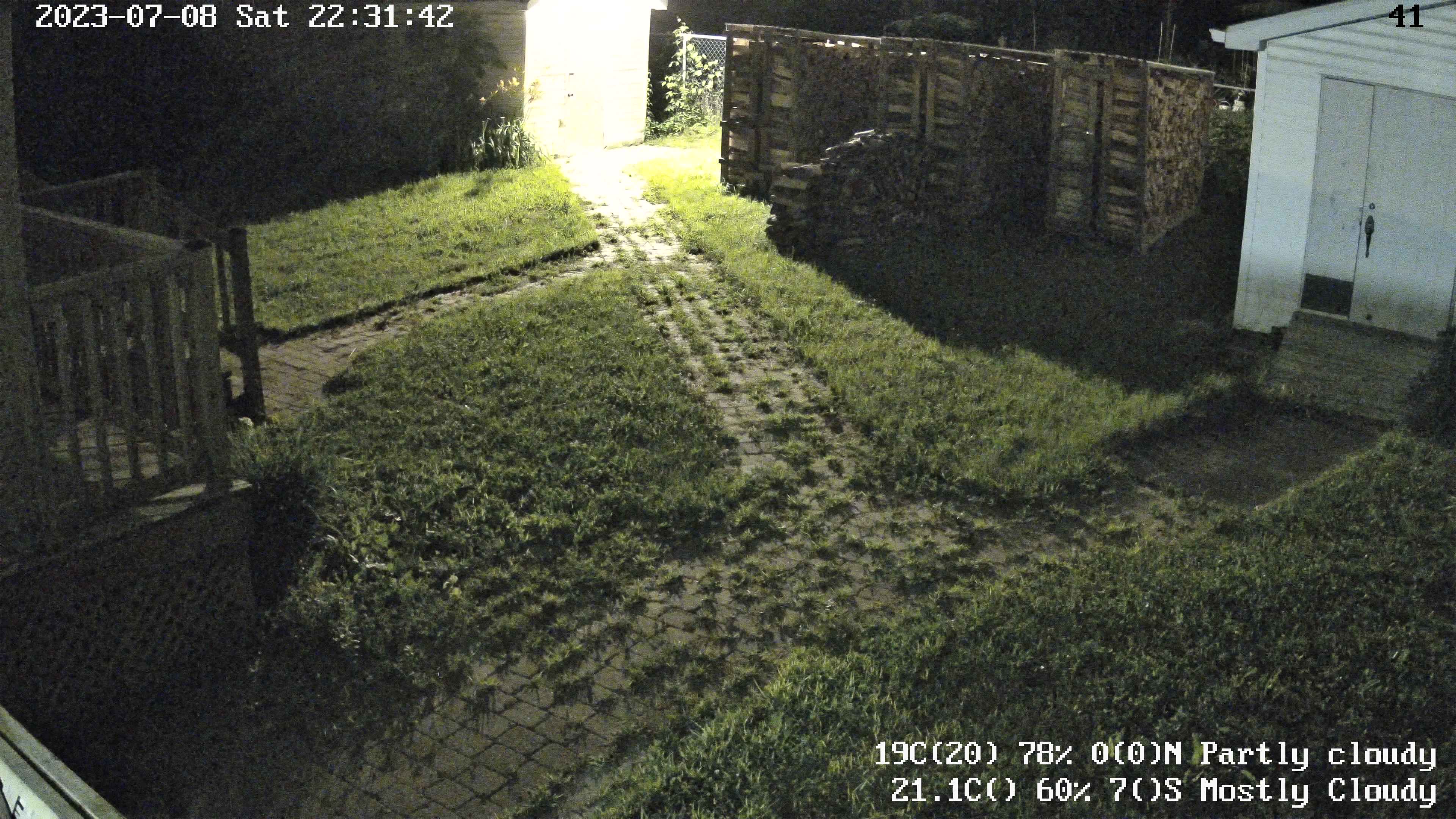

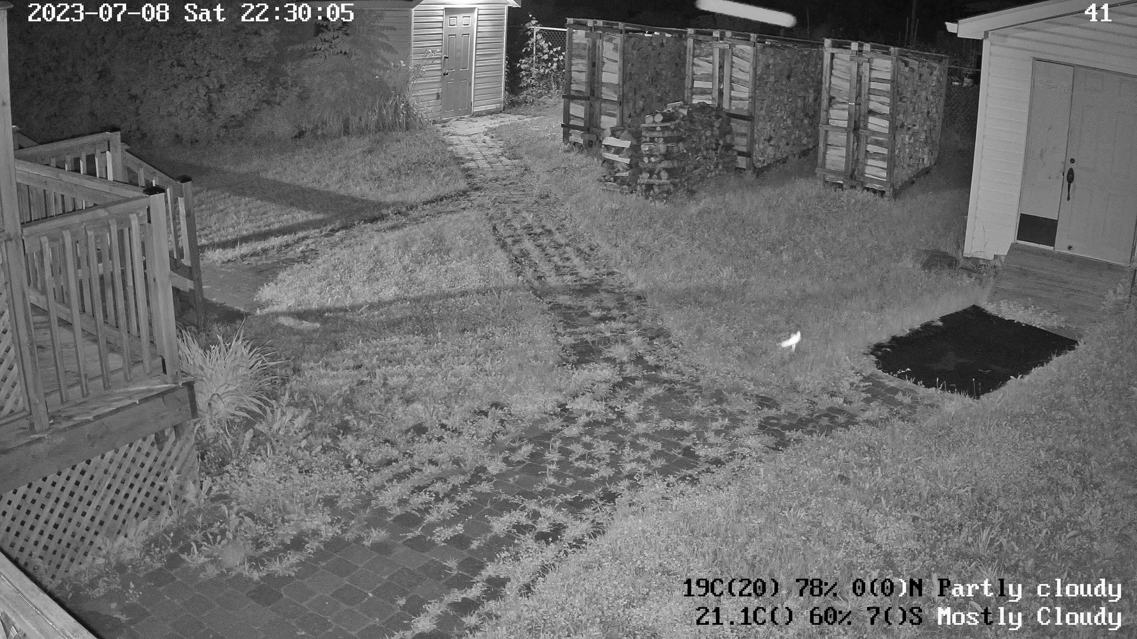

the door at the end of the walkway is about 17 meters / 55 foot from the camera, this is not close
look at the filename for light context
this is 1/60

It’s not a bug. Auto Day/Night has always worked that way. During darkness manually switch camera to ‘Night’, then manually drop gain to a low level so that it darkens the exposure. As soon as you switch back to Auto, the camera will remain in Night but ramp the gain back to 100.
The WDR thing you mentioned I’ve noticed before. Auto WDR regardless of level switches on WDR at a higher level. Again it’s not something specific to these models.

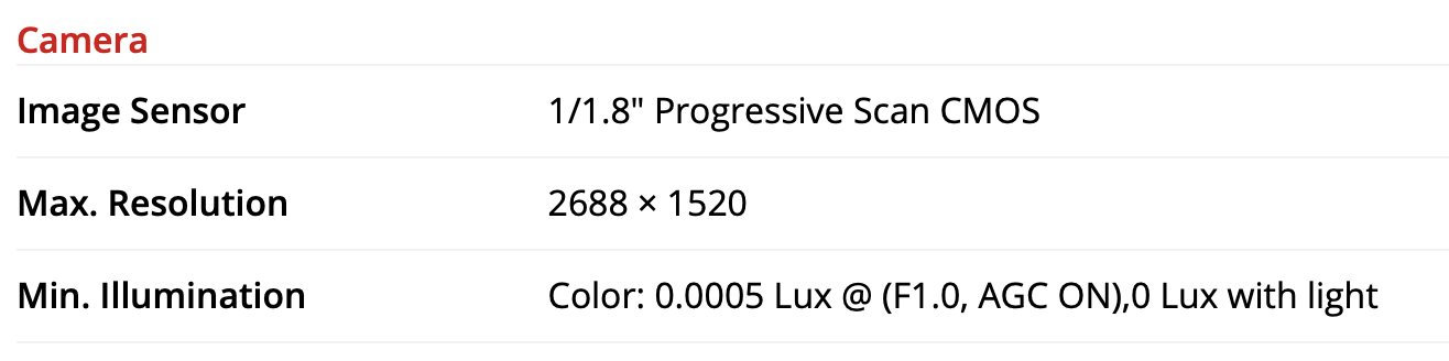

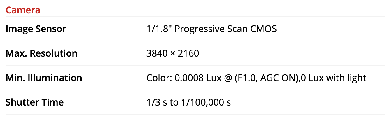

One thing I have just noticed in the specs is that while the 8MP Hybrid model uses the F1.0 aperture lens from the 8MP ColorVu it does not share the same 1/1.2" sensor; it's using the 1/1.8" sensor from the 8MP Darkfighter and so is less sensitive in ColorVu mode than the standard model. That seems a little unusual as the data sheets show that both 4 and 8MP versions use that same smaller sensor at 1/1.8"....
DS-2CD2347G2H-LIU - 4 megapixel
DS-2CD2387G2H-LIU - 8 megapixel

One thing I have just noticed in the specs is that while the 8MP Hybrid model uses the F1.0 aperture lens from the 8MP ColorVu it does not share the same 1/1.2" sensor; it's using the 1/1.8" sensor from the 8MP Darkfighter and so is less sensitive in ColorVu mode.
for my camera it's the first thing i noticed and mine is a little bit worst with an aperture of 1.2 instead of 1.0
for my use case, i needed at least 6mm and unless i missed one, my only choice was a varifocal one and i didnt want a dome
