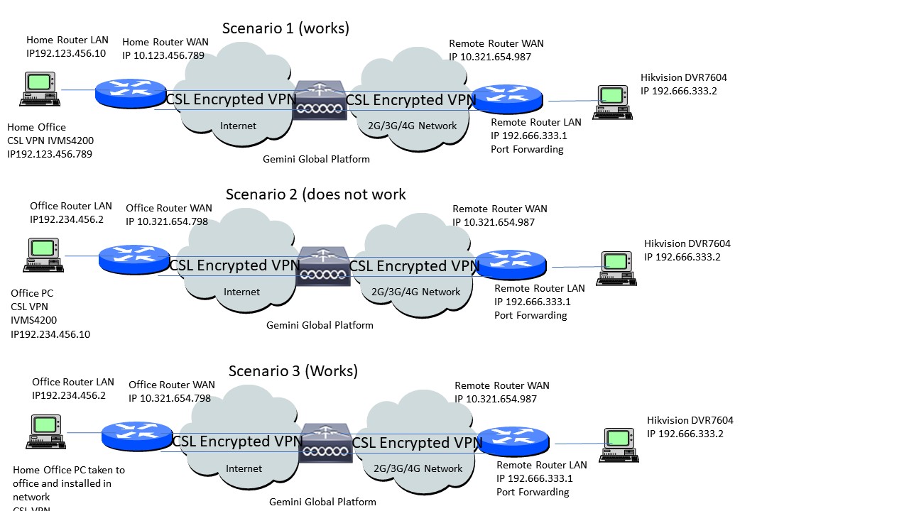

Thanks for you response however I think I have probably not explained myself properly. I have attached a powerpoint of how the whole thing links together from my perspective. Scenario 1 works with my home office pc from my house to the remote site
Scenario 2 does not work with exactly the same IVMS and CSL VPN setup from my main Office
Scenario 3 shows that when I take my home PC and plug it into my Main office network it does work, so port forwarding at the other end is okay, the VPN only supports one connectivity at a time which is fine as it is only being used by one person, me.
It cannot be a restriction on the VPN as I can also access the remote site from my phone which uses the same VPN.
I am assuming, because I dont know for sure, that there is some form of "client/server" relationship between my home office device running IVMS and the NVR at the far end. What I cant work out is why, if I have exactly the same IVMS software and CSL VPN on another machine cant I see the remote NVR. Id their some form of restriction within IVMS against usernames. When I set up each instance of VMS I have to put in a nre Superuser name for that machine. I have kepth this the same across all platforms that I have tried to do this from so the home office machine is the same superuser name as the Home office which should allow it to log into the NVR
Please note all the IP addresses shown are maky uppers and inclued to give the flavour
Many thanks
Ian

Hi Ian,
We'll sort this out.
Are there 3 different locations? It looks as though the NVR site only uses 4G connectivity, are the other sites normal broadband ISP's?
Home
Office
NVR
Could you show the proper IP addresses? It's good to see the subnets involved. Exclude any public WAN addresses, maybe use nnn.nnn for the last 2 octets.
There is a client / server relationship on the VPN side. I'm not a real user of ivms4200 but think there is a client / server setup as well.
Is the Gemini Global Platform a VPN matcher service to resolve Carrier Grade NAT on the 4G network side or do you have a public IP on the 4G side?
David

Hi David,
Thanks for that.
Yes the NVR is housed in a Portakabin type structure which consists of the cabling to the 4 cameras, a power supply and the Cisco CSL router. Because the transmission to and from the NVR is via the 4G network the CSL router and VPN were the solution provided by the Security company. The CSL router is equipped with an external aerial to maximise the connectivity.
The IVMS is configured to transmit on port 8000, I haven't changed this it is just the default that came with the system.
House LAN, Office LAN and NVR LAN are all on 192.168.nnn.nnn with 255.255.255.0 mask.
I don't have any detail on the Gemini Global Platform but would presume that it is Internet / 4G mobile network gateway type environment. The only public IP I have for the 4G side is the CSL Router WAN address at the Portkabin.

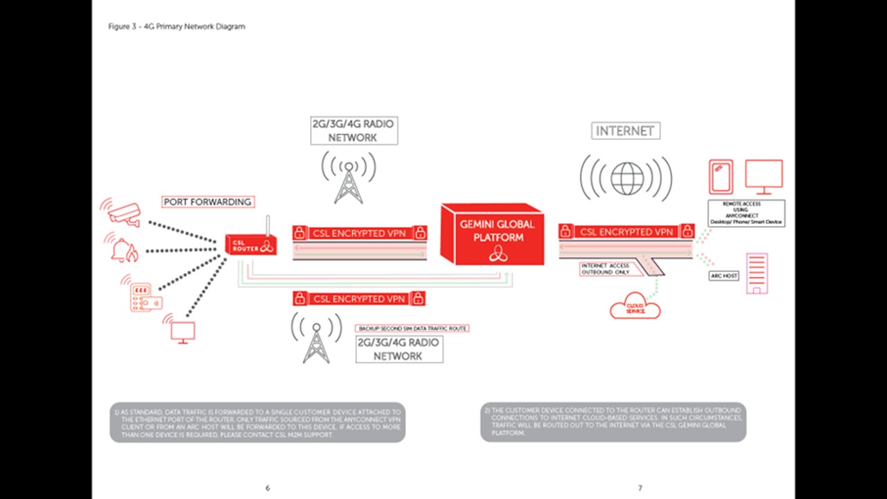

I have attached an original network diagram from CSL
Because the VPN sets up equally well from wherever I set it up I do not think the issue is the VPN, however I will drop the helpdesk a line just to make sure.
