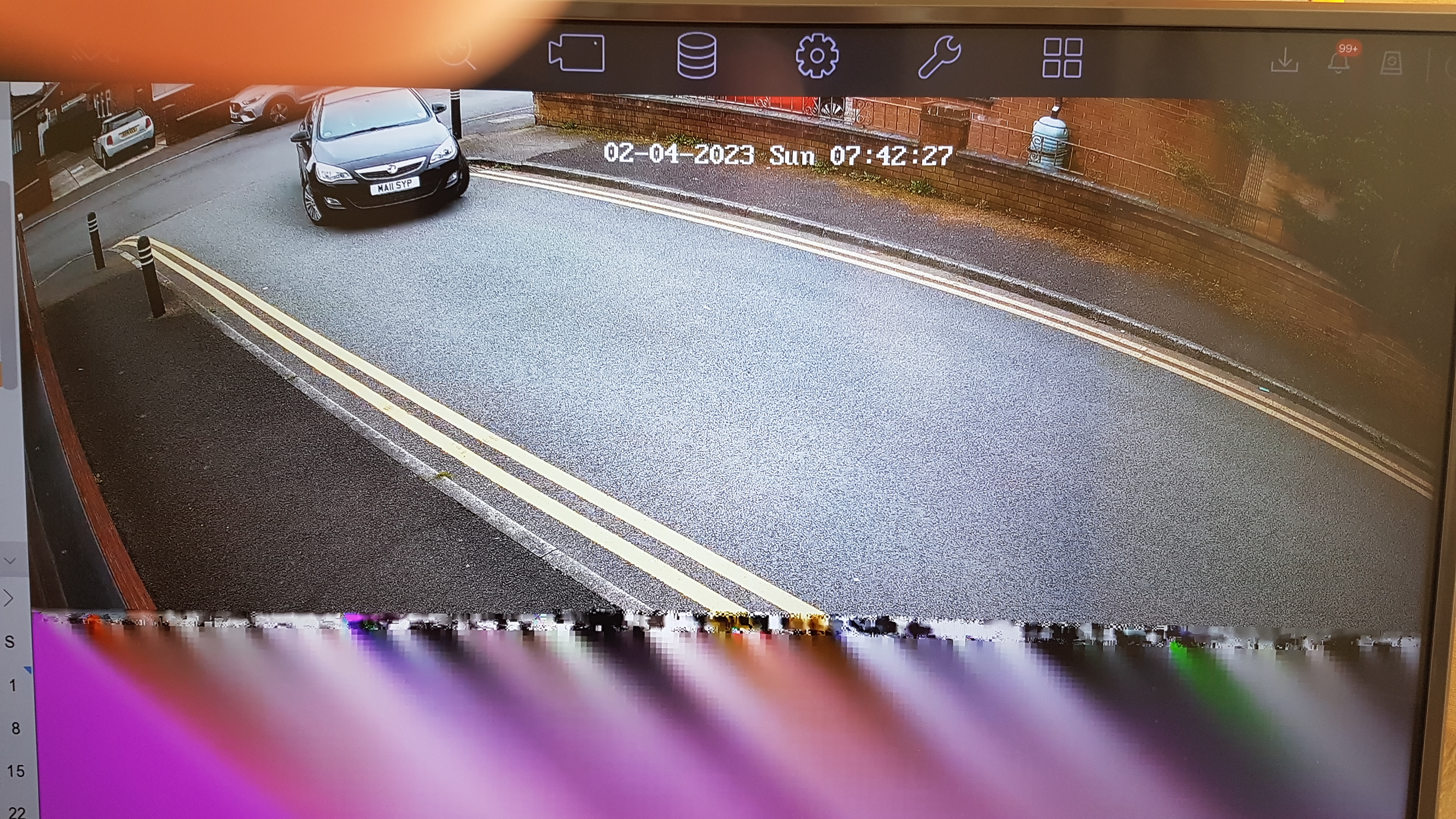

installalled 2 x colorvu 4K cams DS-2CD2387G2-LU (with cat6) on Hikvision NVR DS-7716NI-I4 / 16P(B) problem is on playback with skipping frames and blurring on bottom quarter of screen, running latest camera firmware 5.7.12 and live view perfect?? new at this can anyone please help.

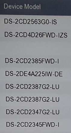

How many cameras do you have in total? Which models do you have?
Model Numbers Access from 4K TV, will be 9 Cameras if and when this prob is solved. Wanting to put another DS-2CD2387G2-LU on system .
No problems with existing cameras. Thanks in advance for any help

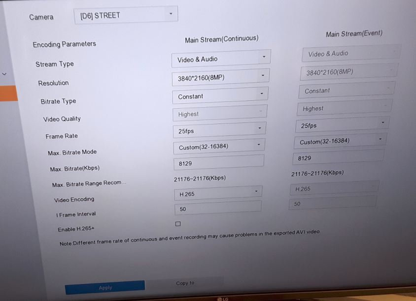

Is there a particular reason you have Constant bit rate set? Have you tried switching to Variable bitrate and checking footage recorded after that change?
Attached pic was taken when on variable, the last pic was the setup after I changed it this morning, (07:00), whist on test (with constant bitrate) this morning the fault has not shown. The test was taken with a different view. (no yellow lines)
Daft question but I will ask, could road markings i.e YELLOW LINES cause this fault??
Thanks @Schof
I wouldn't expect the yellow lines to cause any issues.
Just to clarify, are you saying the issue is visible when the cameras are set to variable but once you've changed to constant you don't see it?
This might suggest it is a bitrate/bandwidth issue because when set to variable the bitrate will just go as high as it needs to maintain the resolution/stream settings you have set, whereas constant restricts the bitrate from going beyond a set limit.
Constant bitrate might impact the image quality/resolution because it will automatically adjust the image/stream settings to keep the bitrate under that set limit, if you are noticing a drop in quality we would recommend switching back to Variable and try reducing the frame rate to 20fps, enabling H.265+, and lowering the video quality to Higher or Medium.
A combination of these setting adjustments should reduce the max bitrate used by the camera when set variable and hopefully remove the playback glitch.
