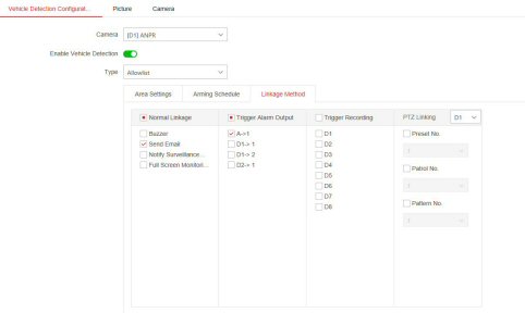

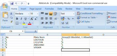

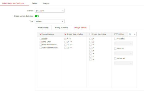

I'm a newbie setting up a NVR : DS-7608NXI-I2 / 8P/S with a DS-2CD7A26G0/P-IZS 2MP ANPR camera. I've configured my email details in the NVR settings and I've imported the test blocklist/allowlist shown in the attachment. I've entered the settings for Event and Linkage as shown in the attachments.
However I receive no emails for any entries or exits of the 4 listed vehicles even though Data Retrieval shows them all being captured with pictures and plate numbers. Any thoughts
on what I might be doing wrong?

Hi @im2020
It looks like you are from your screenshots, but can you please confirm that you are setting up the Vehicle Detection on the NVR as well as the email setup?
Can you share a screenshot of the email settings page, please, with your email address blurred/blocked out?

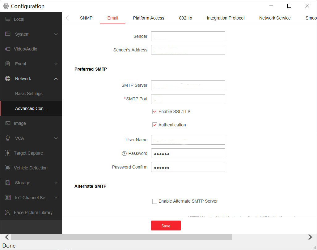

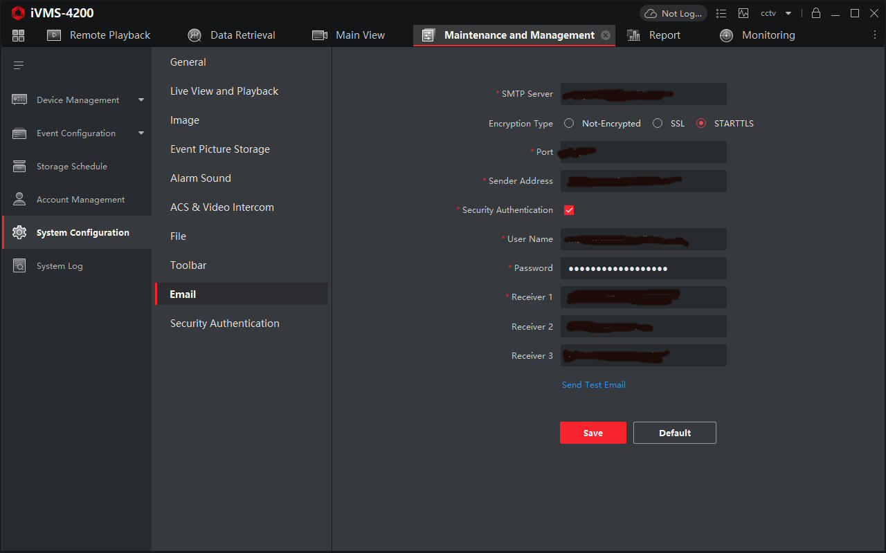

I stumbled upon the solution to my problem. The email settings I had entered were on the System page rather than on the Device page. The attachments show the difference and the Device page is where I've now entered my settings and am now receiving the desired emails.
What are the email settings on the System page for?
Well spotted, I didn't consider that!
The iVMS-4200 email settings will be for notifications sent by the software, I've never tested it to say how well it works, to be honest, but I guess the idea is that if you have lots of different devices connected to it separately then it will save some time (rather than entering email settings on each device).
These notifications would only be sent for events set up on iVMS-4200 under "Event Configuration", rather than on the cameras'/NVRs' individual event settings, and are different to the usual smart events.
