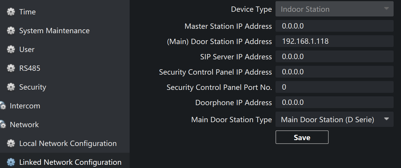

Bought a Hikvision 2-wire intercom system:
1 x DS-KAD706 (switch)
3 x DS-KD8003-IME2 (door station) DS
3 x DS-KH6320-WTE2 (indoor station) IS
All DS and IS are connected to the switch. All I want is that if someone is calling on one of the DS, that all three IS will ring.

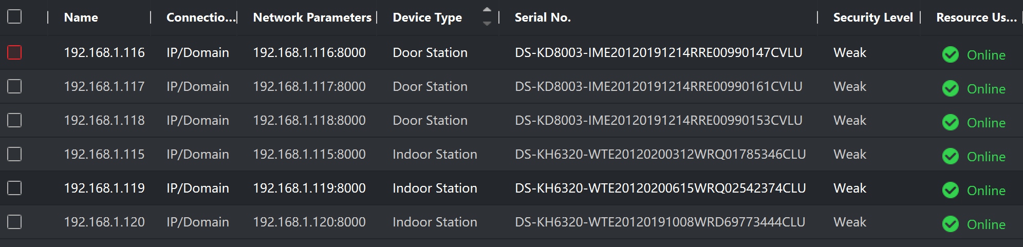

I invested a lot off time to try to configure this, but didn't succeed. Spend a lot of time on the internet and wrote every manual I could find. I have reset, reconfigure, used IVMS, tried without IVMS etc etc...

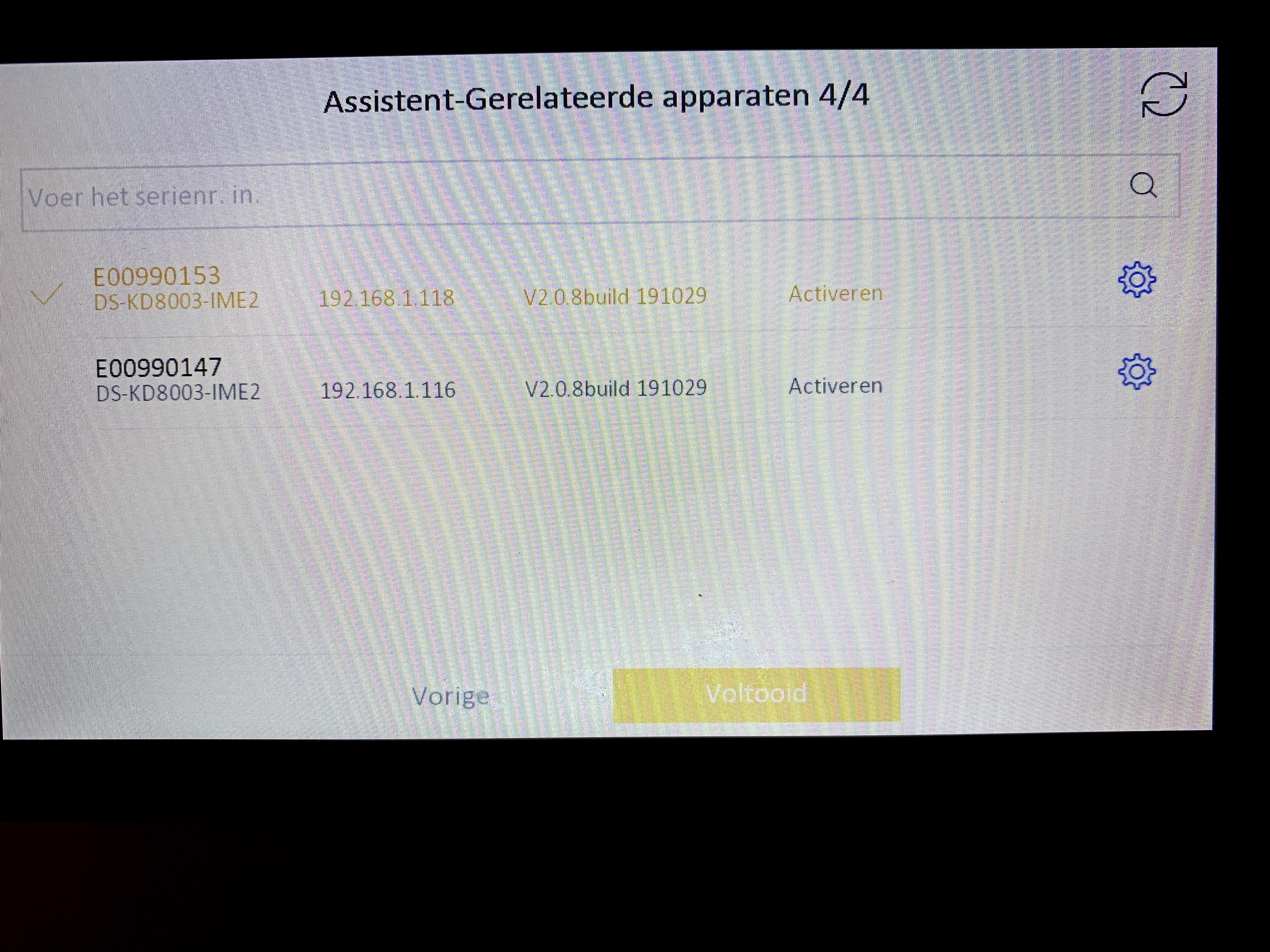

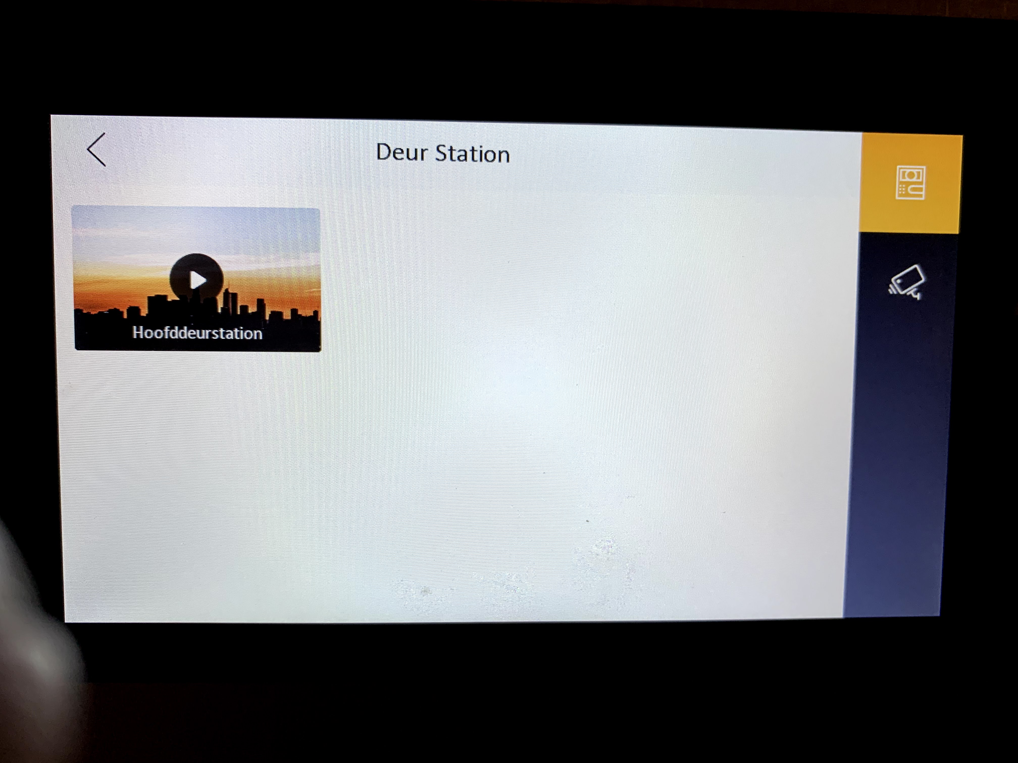

When I start with 1 IS, and connect the first DS, i'm able to activate the DS, can view it on the IS and everything works fine. But when I connect the second OS and I run the configuration setup on the IS again I see two DS which I can activate (
) But I can oly activate one. And when I have done this the result is that I only see one DS on the IS. (When I connected the other two IS, the display only one DS
When someone rings on the first DS, the (two of the IS rings, and you can answer the call) When someone ring on the second DS you'll here 'calling failed).
So even when I connect the third one I get the same problems, only 1 DS will work.
Where do I go wrong

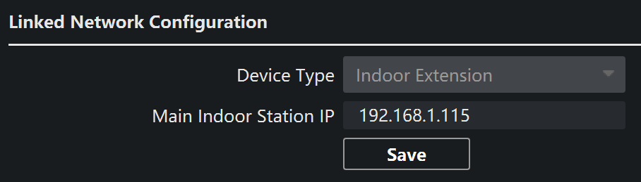

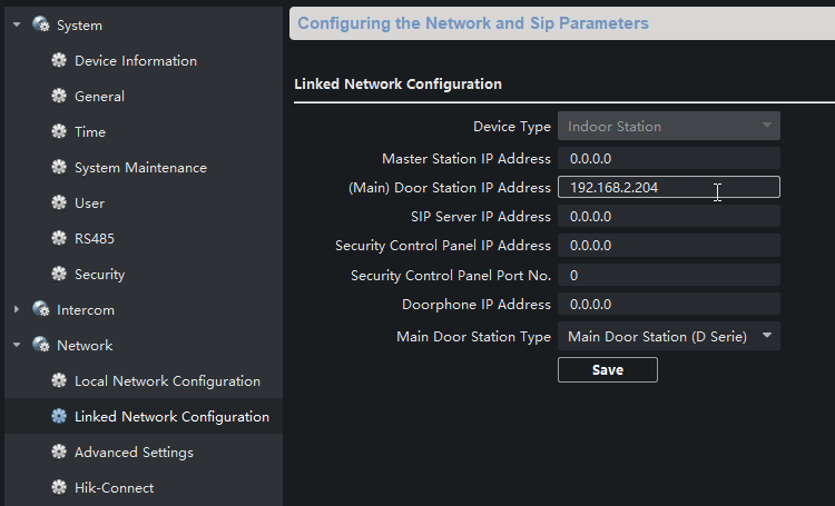

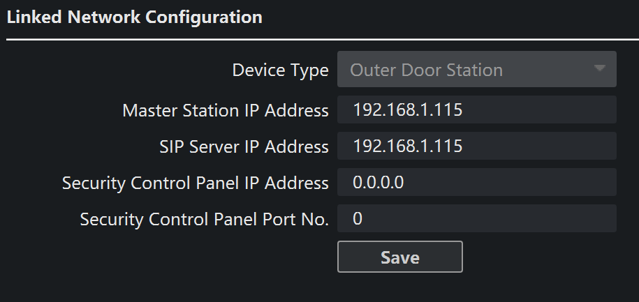

I tried to configure everything in IVMS-4200 but could get it running. Other people say that you don't need to use IVMS, and program it just on the IS's.
Programmed the first IS as 'main door station' the other two as 'sub door station'.
Do I have to use different room numbers and floor numbers.
