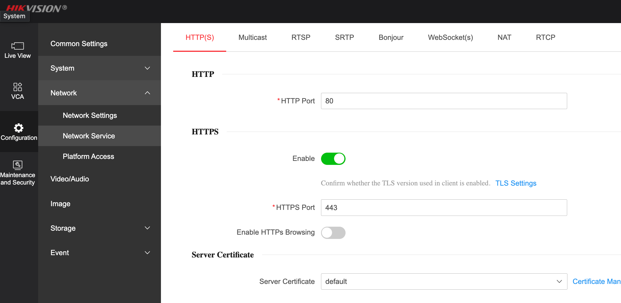

After following a tutorial on YouTube to the letter, I still can't get this camera to work when I try streaming to YouTube. The issue is still within the camera and trying to upload the RTMP firmware.
Device Model
DS-2CD2386G2-ISU/SL
Firmware Version
V5.7.18 build 240826Upgrade
Encoding Version
V7.3 build 240801
Web Version
V5.1.117_R0101 build 240824
I've tried EVERYTHING and have spent 3 days trying to get it up and running. I can see the picture/audio if I use a browser so no problem there. The problem is trying to get the RTMP tab to appear.
Any advice would be most welcomed. I've contacted HikVision who refused to help. Thank you.

Thank you very much. I now have RTMP. Can't get it to appear on my youtube live though but at least I have RTMP so I can play around with it. Thank you very much for your help. Much appreciated.
Then this might help. Please see attached file.
An Update: The update you provided has given the RTMP section on the camera. I am now having issues trying to get the picture to appear on my YouTube feed.
This is a screen capture of what I'm looking at, am sure it's just a simple click something and it will work but don't know what! Any advice is most welcomed. All I want to do is live stream my garden. Thank you.

Did you factory restore after upgrading firmware? You should have a another input to insert youtube stream code.
In the url you need to combine both url + key from youtube,
so its looks like
rtmp://a.rtmp.youtube.com/live2/1111-AAAA-2222-bbbb-3333
As you can see it works. I used the same firmware on test camera

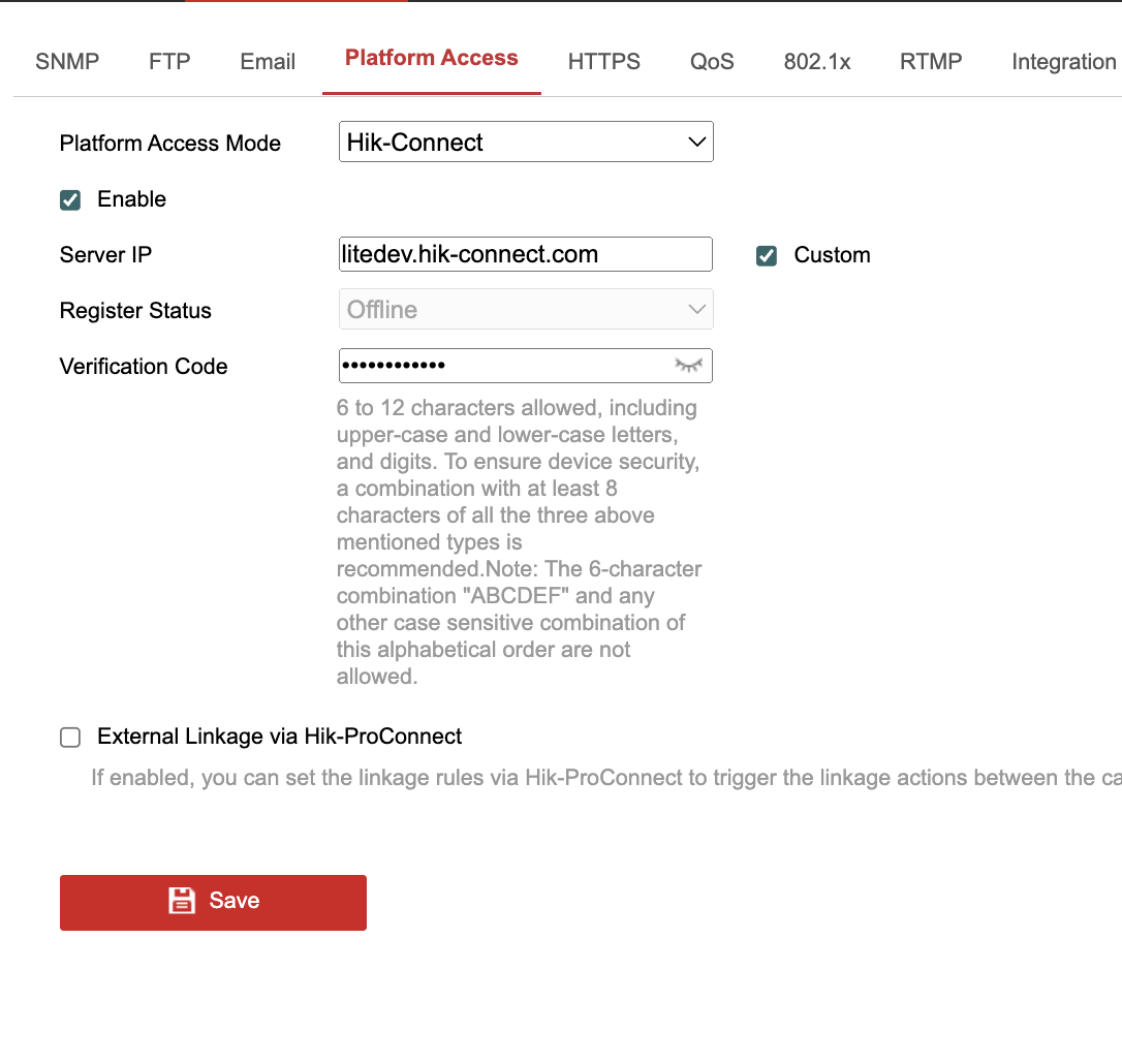

Is the gateway and DNS correctly set? Does the Platform access says Online - Meaning it got access to internet?
Other than that i have just tested on DS-2CD2663G2-IZS (C) and it worked without any trouble.
Only thing that might block you if your youtube studio is opened for the first time and you need to wait to be authorized from youtube to stream(24h)
Also in Security tab, set RTSP digest/basic and save.
Other than that there is nothing else.
- WHERE CAN I FIND THIS?

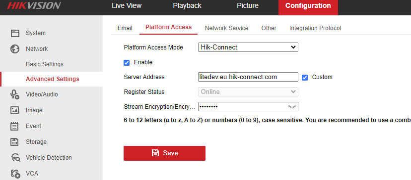

Does it says online in platform access when its enabled?
Dont mind menu, this is from DVR, since i turned off camera. But camera got the same menu
Ok your camera does not have access to internet or its being blocked. Hence RTMP wont work

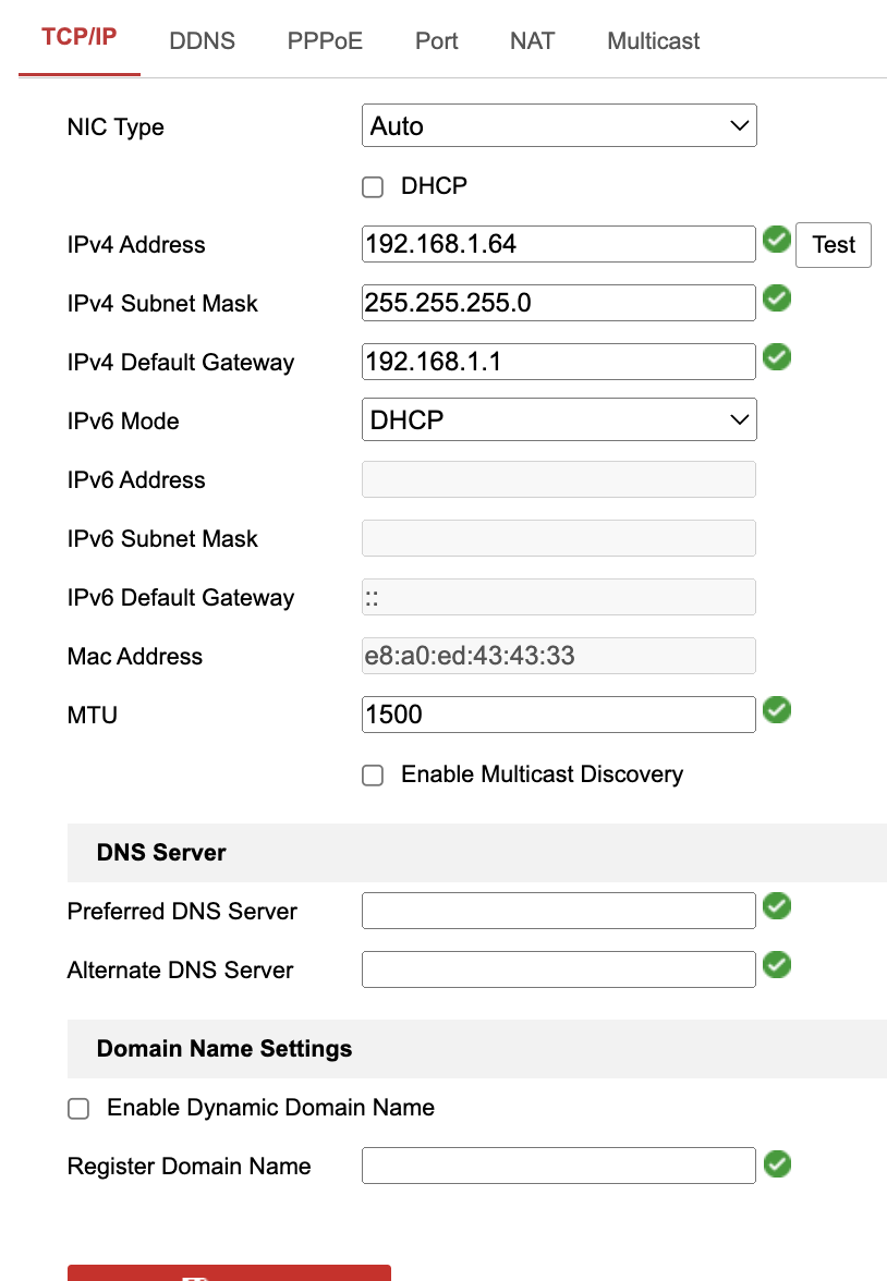

Check if your gateway is rightly set as well DNS
Okay, when you are connected on same network with your computer. If its a windows machine open Command Prompt and type "ipconfig"
If you are connected wirelessly look under wireless adapter this next informations
ipv4 address:
Default Gateway address
Subnet mask
Now lets say your ipv4 address is 192.168.1.28 and mask is 255.255.255.0 and gateway is 192.168.1.1
Your camera should be on ip address 192.168.1.2-253(and not 28) subnet mask 255.255.255.0 and gateway 192.168.1.1
DNS you can add google dns 8.8.8.8 for primary and 8.8.4.4 for secondary
You can find this information inside camera under Network - Basic - TCP/IP
ok write in dns
8.8.8.8
8.8.4.4
apply
Then after a minute go to platform access check if its online

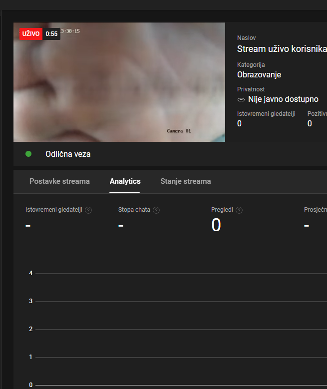

Can you see what I'm seeing?
Thank you very very much for all your help and support. I will treasure this thread in case I need it in future. Thank you once again from the bottom of my heart.
