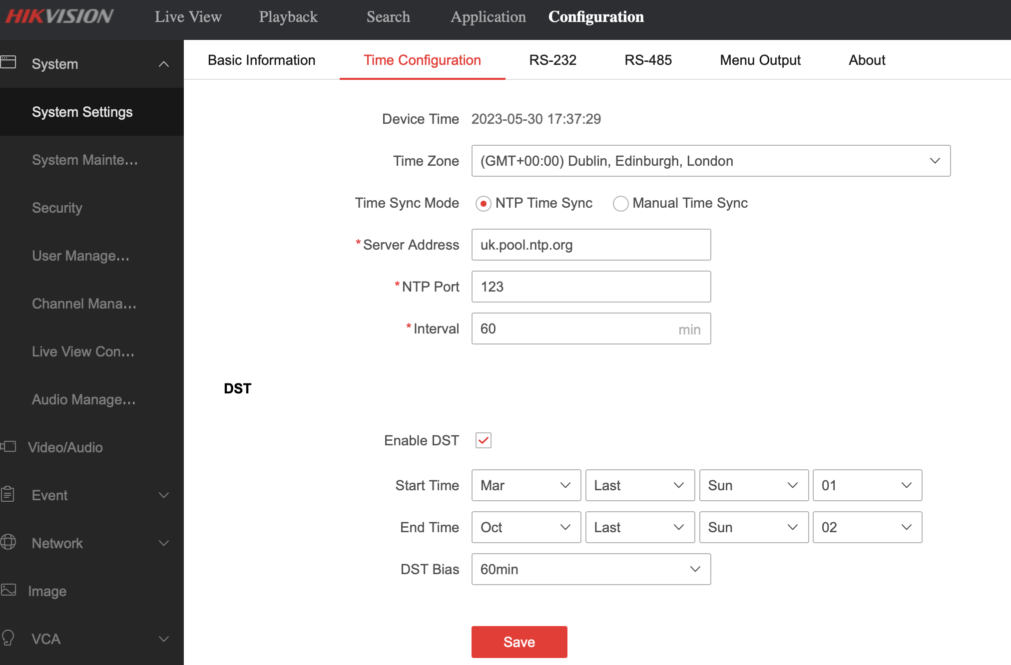

To do the above using the web browser A little different...In the image below normally I'd set the timezone first, then the daylight savings as required, then click manual time sync, sync to computer time before switching back to NTP (you do the daylight savings before setting the time otherwise depending on the time of year, you'll immediately put it out by an hour):

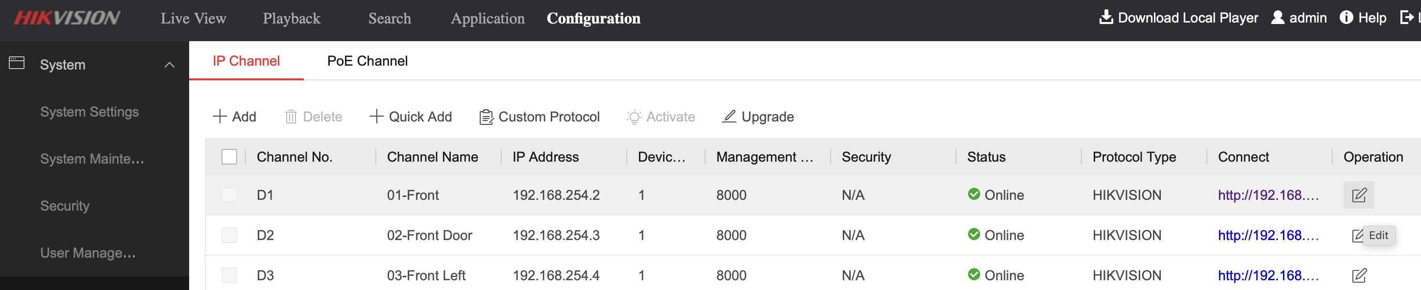

Then to check the camera time is sync'd you'd go to the page shown below:

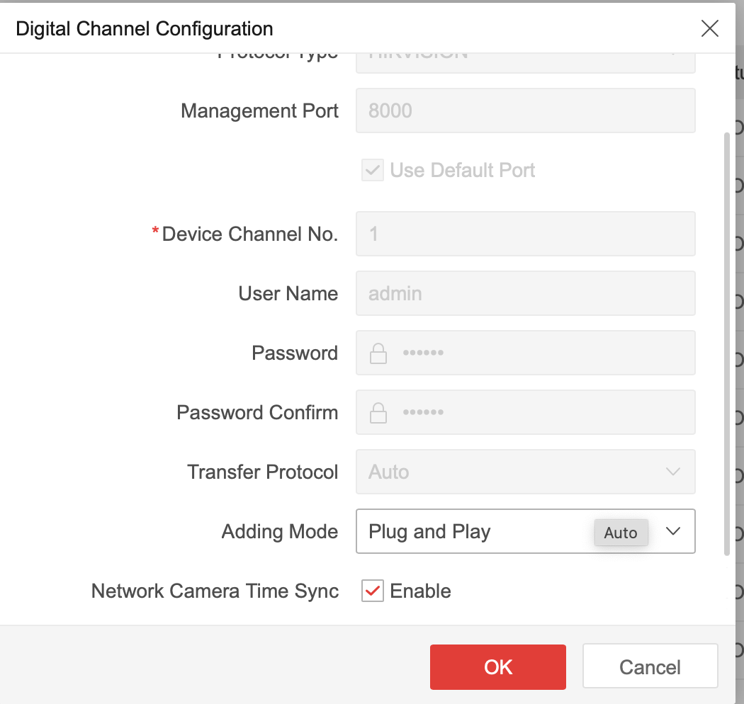

Click that 'edit' icon at the end to show this screen:
Where you can check the 'Network Camera Time Sync' box (your NVR may word it a little differently)
