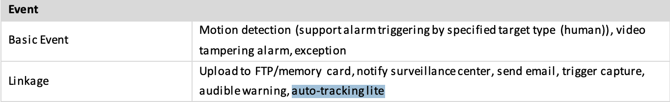

Hi @mumin
This model supports Auto-tracking Lite, which can be enabled as a linkage action after motion detection has been triggered (see below).
So the camera won't support general auto-tracking of any movement through the scene, but it can support it as a reaction to a motion detection trigger.

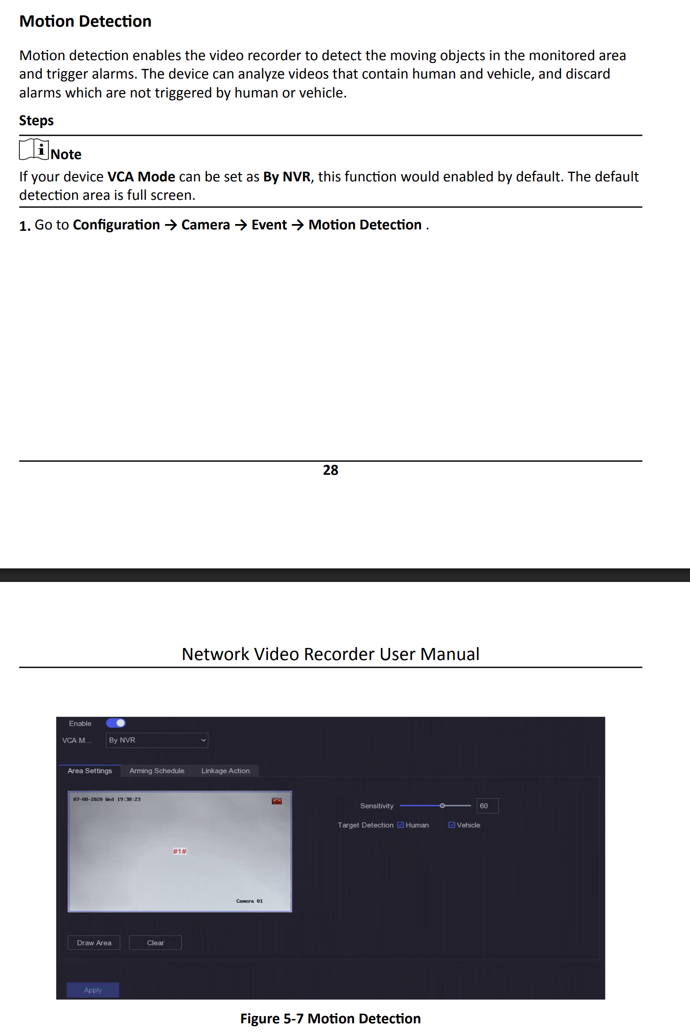

With the Q1 NVR, you might be able to find the auto-tracking option in the Linkage Action menu under the Motion Detection settings.
But this newer Auto-tracking Lite feature might not be supported by the Q1 NVR, so you might have to log into the camera directly with a web browser and enable this feature under the camera's motion detection settings.

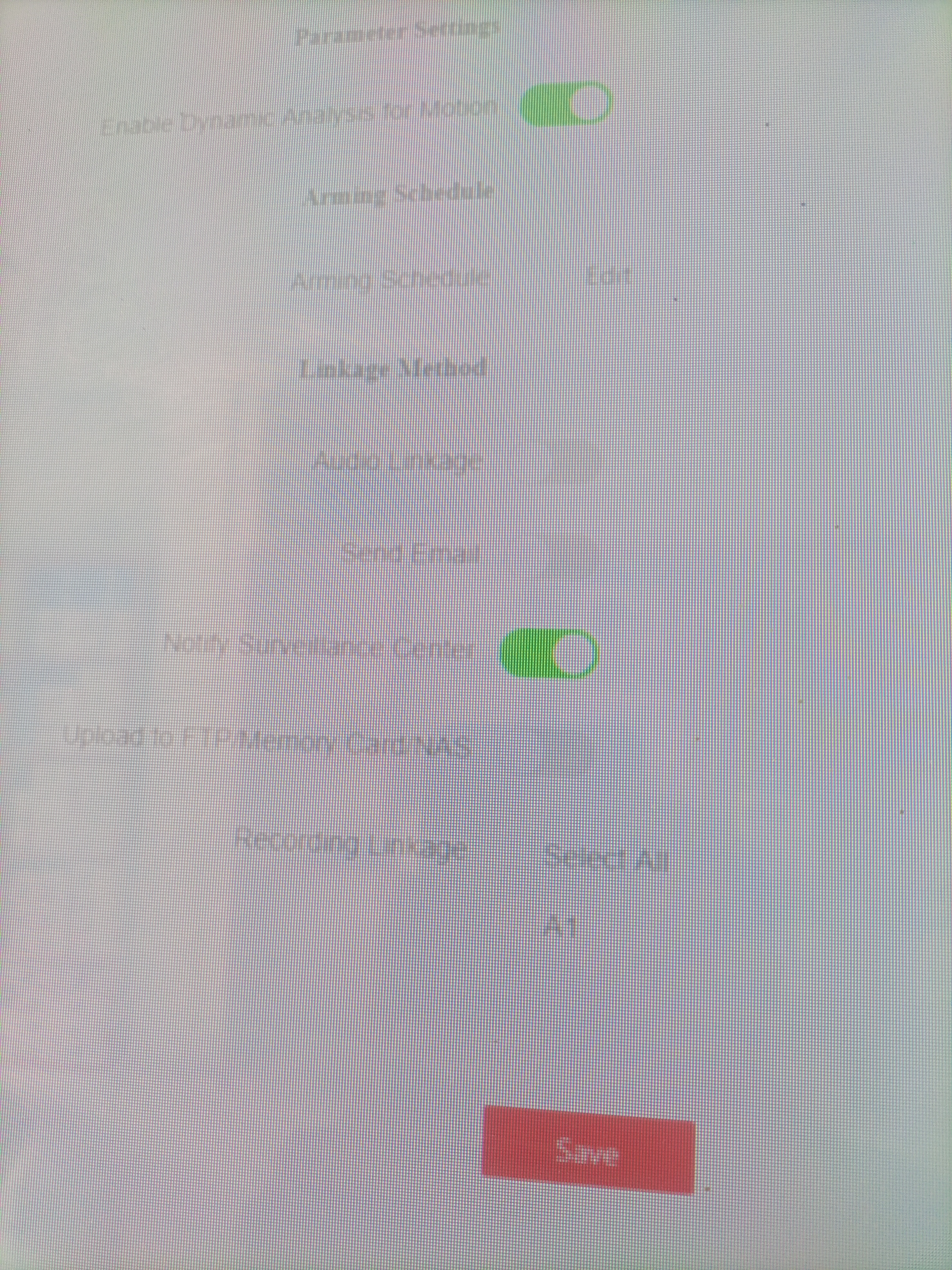

I don't get an option to enable Auto Tracking lite via motion detection
