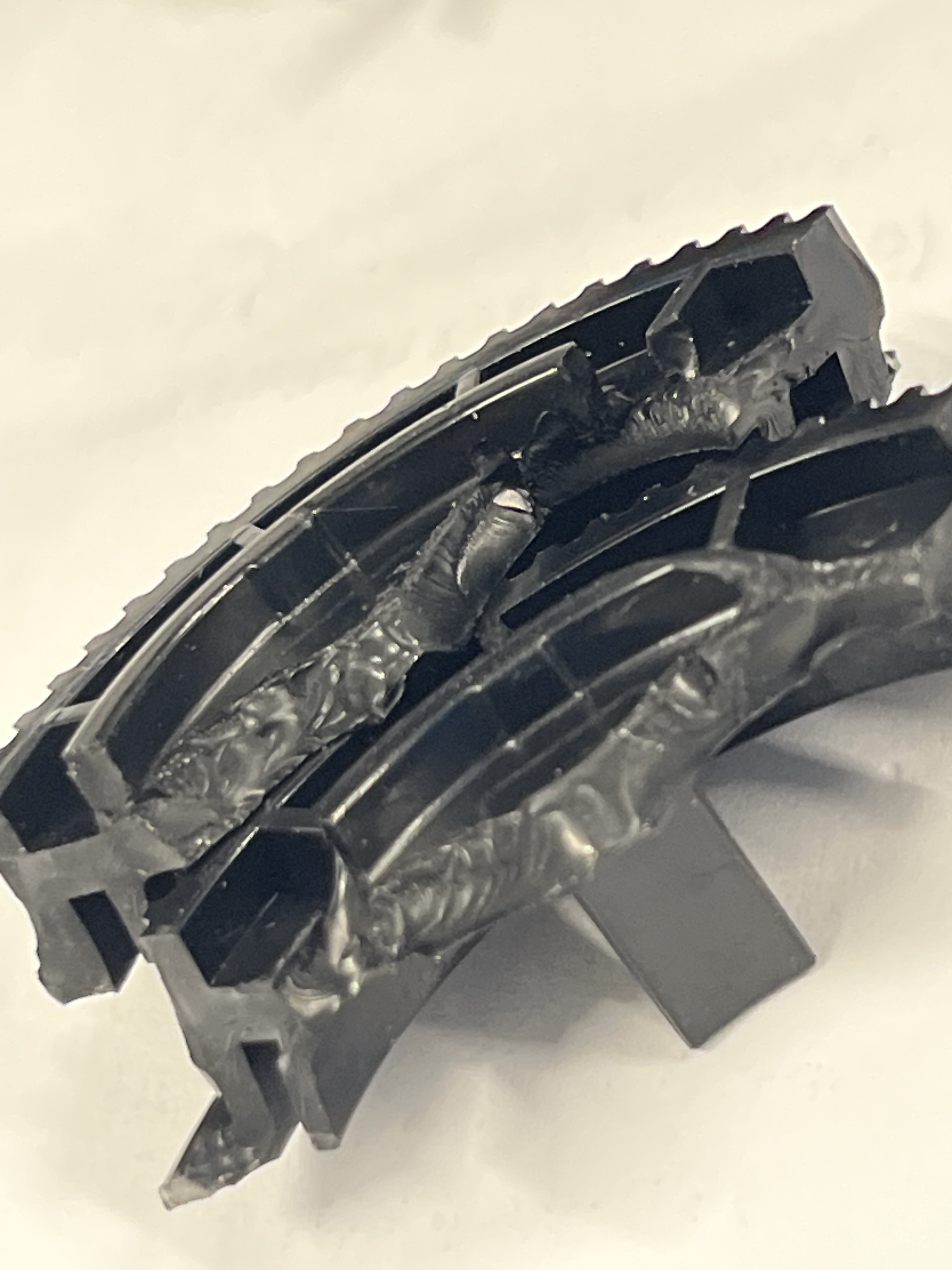

Finally managed to get a a hold of the cameras. I opened a few up and they all have the same issue.
Here is a description of the image in case it is not showing: the pan gear is shattered in all cases, about 3-4 pieces. The broken surfaces are clean and shiny, almost like broken glass, or hard plastic being hit with a hammer for example. There are bits of gear plastic still attached to the housing around centre of the gear and cable entry. There is no evidence of wear, ie ground plastic or metal.
These cameras are panning all the time. They are about 4 metres up and not easy to reach at all. They were working when installed.
The environment they are in gets pressure washed once a month. Been installed for about 7 months.
My only theory is that accidentally or on purpose they get a water jet that is powerful enough to give the camera a torque shock and break/crack the gear. Intentional or malicious we do not know.

Nope, never seen that happen before!
Your theory sounds feasible.

My next step is to try and prove my theory by trying to break the gear when the camera is panning.
Did some numbers on how we use the cams: we pan 360 deg over 30s, with 4 stops spaced 90 deg.
We control the cams by the ISAPI interface (not great API, and docs are awful with lots of hidden stuff too).
We give the cam a full speed command until we hit the desired pan angle, wait a few seconds then repeat.
Rough calculations give me 23k start and stops per day.
We were wondering if these start+stop events are too sharp and can lead to torque shocks.
If there is any crack/defect in the plastic it can grow like fatigue failure till break.
I add another closer pic of the broken surfaces.
Any theory at this point is welcome!
