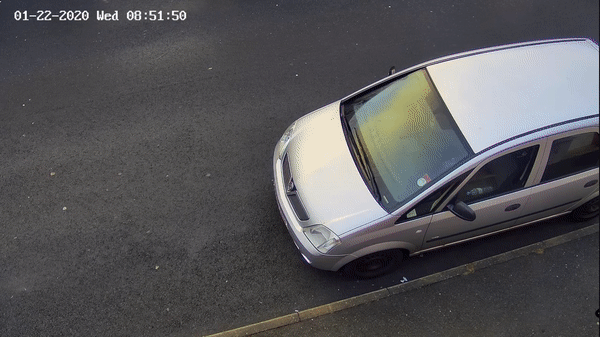

Hello, First time posting on the site. I am getting a problem with pink ghosting with moving images on my Hikvsion PTZ camera DS-2DE4A425IW-DE I am using a DS-7608NI-I2/8P NVR.
This only happens when WDR "Wide Dynamic Range" is Enabled. When it is off the colors seem quite washed out without it enabled.

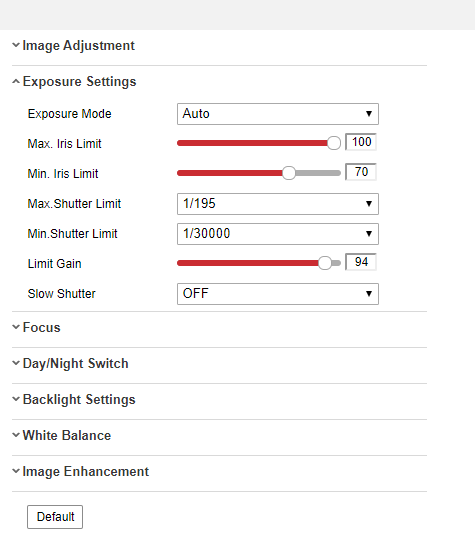

have found that changing the max shutter limit to 1/195 instead of 1/30 seems to help the problem but soon as the sunset the camera image becomes black and is not visible if anyone has any suggestions or solutions to why this might be happening I would appreciate it.
That purple/pink effect looks like a chromatic aberration when you shift the focal point. Does this only happen in the live preview when panning the PTZ, or is it present in the recorded footage too?

It happens on the live preview and on the browser it is when fast-moving objects are passing by such as a car or when I move the PTZ.
Happens on my monitor which I have connected NVR > Monitor via HDMI. I have even replaced the HDMI cable and even when logging in to the web interface I get the same pink effect.

Changing the WDR setting from the default 50 > 20 (other WDR setting probably work too) fixed this for me.
The purple hue was in the recorded video footage too btw.
