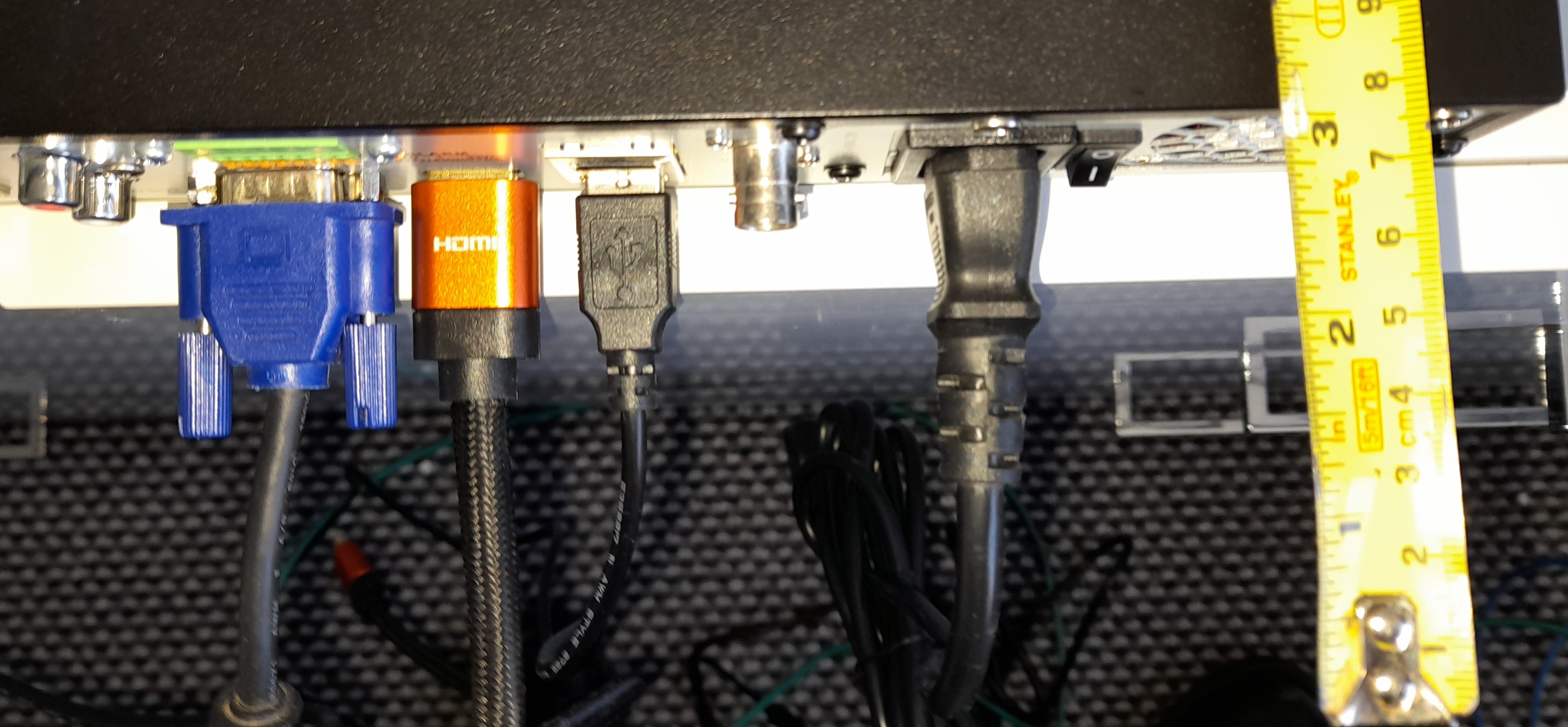

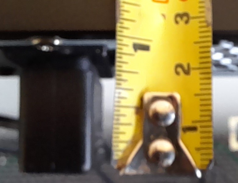

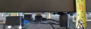

And my NVR only been 322mm deep sat on the shelf nicely, all was happy days until come to putting all the cables into the back of the NVR, mains cable, HDMI and all the patch panel cables for the cameras, the mains cable once inserted into the NVR stuck out roughly 80mm from the back. So, the NVR was over hanging the shelf at the front and right to the glass door more or less.
So, my option was to buy angled down power cable, and an angled HDMI etc., so it fitted nicely.
Ok it would have fitted but buying the angled cable made it fit better and also look smarter.

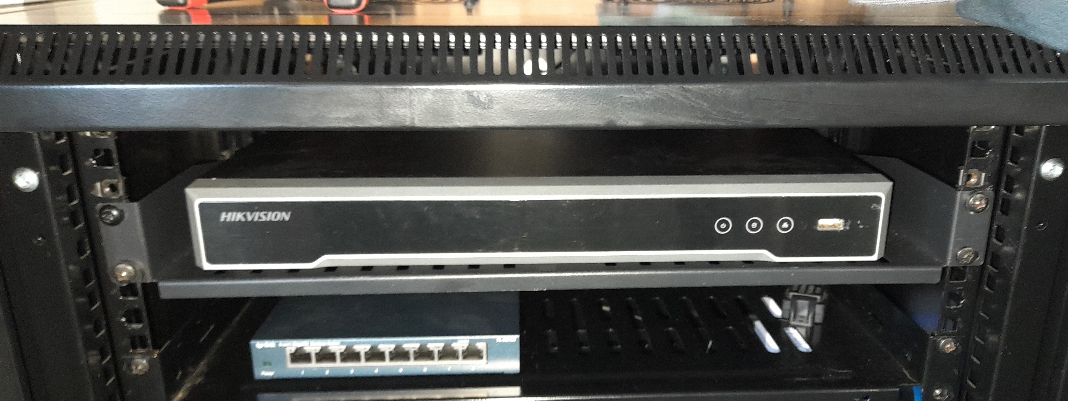

Hi Technoir,
Couple pics, They are not that brilliant, however they'll show you the cables and the difference between getting angled cables to fit in with the cabinet. I just pulled it out of cabinet to show cables.

So with that in mind, I decided to move it back downstairs into one of the bedroom cupboards. And with it being in the cabinet and the door shut. I'm unable to hear the fan. it doesn't keep me awake at night.
With regards to your last question regarding airflow, the cabinet has got slots in the sides, top and bottom for ventilation. So air flow isn't really a problem. With me fitting the Sonoff temperature sensor inside. If the temperature did rise. Let's say above 20 degrees, It would automatically turn the fans on. And turn off once it drops below my set temperature of say 16 degrees.
