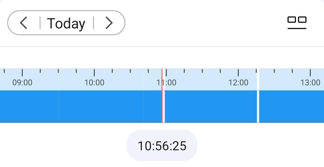

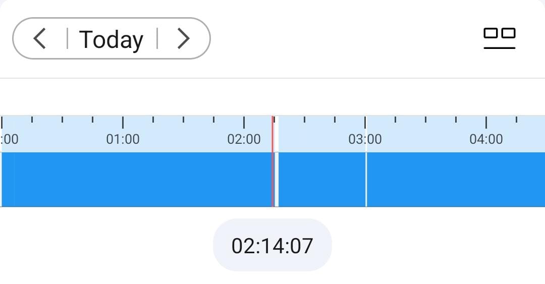

Here is the latest status of my case:
Today, one of my cameras had 5 recording interruptions. 4 of them are unexpected interruptions which are probably results of reboots. You can see these as gaps in the timeline:
  • Timeline gap 1 is around 02:15.
  • Timeline gap 2 is at 03:00. This is a scheduled maintenance reboot.
  • Timeline gap 3 is around 11:00.
  • Timeline gap 4 is around 12:15.
  • Timeline gap 5 is around 18:00.
My both cameras don't go offline simultaneously but I noticed that when one camera goes down, after a few minutes, the other camera goes down as well. But the network is up. I only encounter this situation if I try to reach the cameras using the Hik-Connect mobile app. If I do not use it, there is no interruption (because I see no gap in the timeline).
Since the other camera only records video based on motion detection, I can't exactly compare its downtimes against the other one but when one goes offline, I switch to the other camera and it goes offline shortly after (at least it happened that way today).
I am helpless here. I just do not understand the reason behind this. Is it related to the Hik-Connect mobile app, or is it a network-related issue, or faulty hardware? I don't know.
Perhaps around ten minutes of downtime over a 24-hour period might seem minor; however, the consistent issue arises when attempting to connect to a camera. This makes the situation bad for me.
