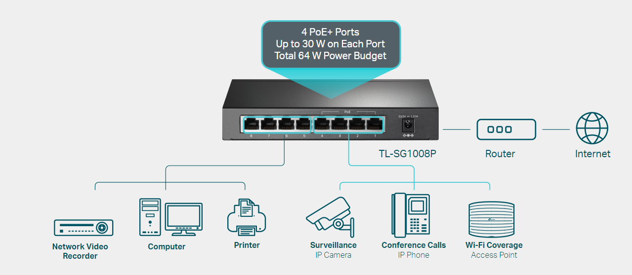

I'm guessing it's a typo, and you have actually bought this 8-port 1008?
8-Port Gigabit Desktop PoE Switch with 4-Port PoE+
It is perfectly fine.
Gigabit.
Has high power.
You need to ensure that the switch's total power budget is enough for your overall plans.
Which it will be if you are only adding one PTZ.
