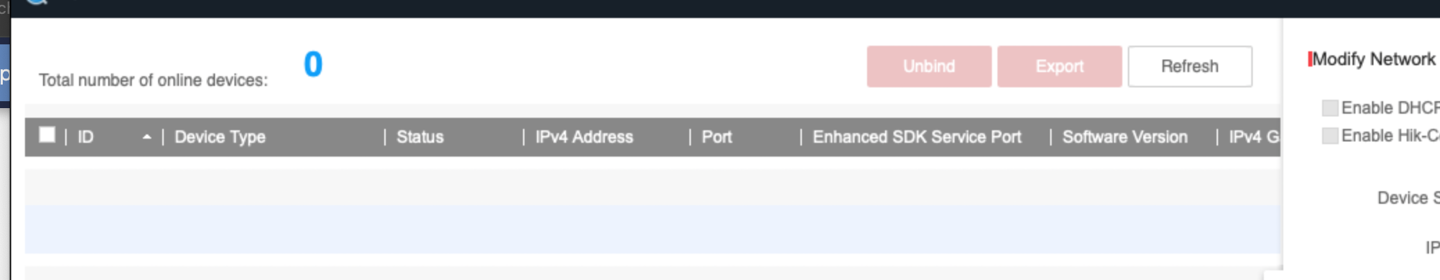

Sorry for the bombardment but i wonder if my issue actually is to do with me updating my NVR because in IVMS4200 my NVR is apparently offline. would i need to create a new question to figure out why its offline? if I open the sadp tool it does not find my NVR at all.
I am not connected to the NVR directly via a ethernet cable but i am on the same wifi network.
In the past, we have seen all kinds of strange behaviour from Hikvision software when connected via WiFi so we would recommend having a hard-wired connection to the same local network as the NVR.
But I will say that we have seen increasing problems with the Hikvision software on Macs running the latest OS and with the latest M1/M2 chips, so you will likely continue to see problems accessing Hikvision from a Mac and the best long-term solution might be SecuritySpy.

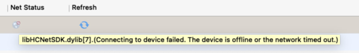

I have a linksys mesh network and one of my nodes is hardwired to the NVR. i have just restarted my router and have it showing as online. however the sadp tool and ivms4200 all saying its offline

Would this still be the case if (ive already got sadp tool and ivms4200 installed) and sadp tool and ivms4200 cant find my nvr online even though i can view the cameras on hik connect and can access it via the ip address. i think my biggest issue before being able to move to another application is understand why my nvr is "offline" but accessible.
I am on the same network and can hit the nvr via its IP but this is what is being shown on the sapd tool

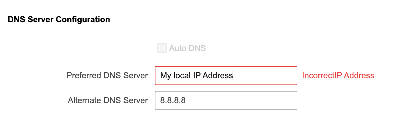

Hi @Dan
Can you confirm these settings are correct? preferred dns is my local IP e.g 12.45.1.195 and alternate is 8.8.8.8
If everything had been working fine before you updated the OS and you were accessing the NVR the same way (e.g. via WiFi) before updating the OS, then yes it is likely the OS update that has broken things.
Hikvision Mac software (iVMS-4200 and SADP) has not been updated for years, so as the MacOS has progressed the Hik software has stagnated and with Apple introducing more security requirements & software developer changes the Hikvision software has become less and less supported.
Hi @Dan
Those DNS details usually work fine, but sometimes users can see issues using their local IP address so we do often default to using the Google DNS servers - Preferred: 8.8.8.8 / Alternate: 8.8.4.4

I have another mac laptop and have just installed sadp tool onto that. I can confirm that the tool sees my NVR as online. I guess i will have to try and persevere in getting security spy setup although it is not going very well at the moment.

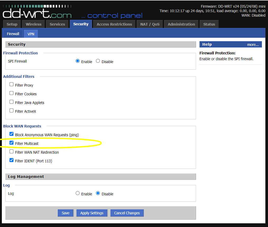

Just a wild guess, that might apply.....
  • SADP uses Multicast packets
  • many home routers, like Linksys, by default, block Multicast packets on the Wireless side of your home network
  • this "might" apply in your case (or not)...... so look for a Filter or Block Multicast setting in your router's firmware & disable the blocking feature (it all depends on the router's specific firmware you're running & it's default settings)
  • attached is a screenshot of a very old Linksys router I have with the blocking feature ENABLED..... you'll want to DISABLE it
Hi @sportster Thanks for the tip but unfortunately that filter multicast flag is disabled already.
the sadp tool was able to find my NVR online on an older version of mac os. so this issue is very much likely to be a Sequoia upgrade issue and just general mac not working well with hikvision tools.

Understood.
From the earlier posts, it sounded like the SADP issue might ONLY be on the Wireless side of your network, and NOT on the wired side of your home network. Which prompted my suggestion. So much for my wild guess. :)
A PC with the Wireshark tool, inserted into your network, might confirm whether the SADP Multicast packets are being broadcast into your network from your MAC, as expected, or not.
Anyway, hope you can get it sorted. Carry on.
