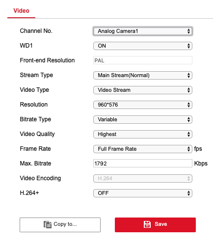

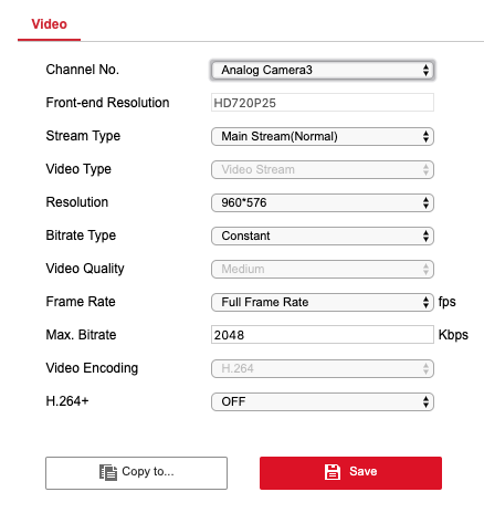

Now I have 2 cameras with great image and the new one is a really bad image (the new camera).

Attached are some screenshot. camera 1 is the new camera (bad image) and camera 3 is one of the older ones (good image).

We never work with analogue/co-ax cameras, so haven't got any relevant experience I'm afraid.
Have you tried editing the settings of the new camera to be as per the others?
Generally we would recommend variable bitrate, with a high max, because constant and a limit on the bitrate can produce poor images as the camera tries to keep the bitrate low.
Also, I'd expect to see h.264 enabled, as it'll use less bandwidth and it should not be detrimental.
If the camera offers h.265 (or better still h.265+) then that is the CODEC we typically use with IP cameras now; most efficient, least bandwidth and storage, and no detriment.
