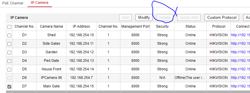

Hi. Got three new/replacement cameras. I've used SADP to set their IP addresses, etc successfully.
I've tried to swap one for an existing camera (different IP address) however this does not appear as a new camera on NVR via browser view.
I reconnected original camera with the aim of 'deleting' it in camera management before doing a physical swap.
However the 'delete' button is greyed out in the browser page for NVR (see attached).
What is the best/right way of swapping new for old cameras please to ensure they are recognised by the NVR with their IP addresses.
Note brand new cameras from USEIP this week with shipped firmware, NVR is latest firmware installed earlier this week (7608).
Thanks.
