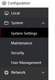

So you can see the RS485 sub-menu. However, mine looks like this:
I have upgraded the Villa to the latest firmware (V2.2.53 build 220816) so I can't understand why the RS485 menu option isn't available.

Hi, go full factory default. After that you should see that option.
