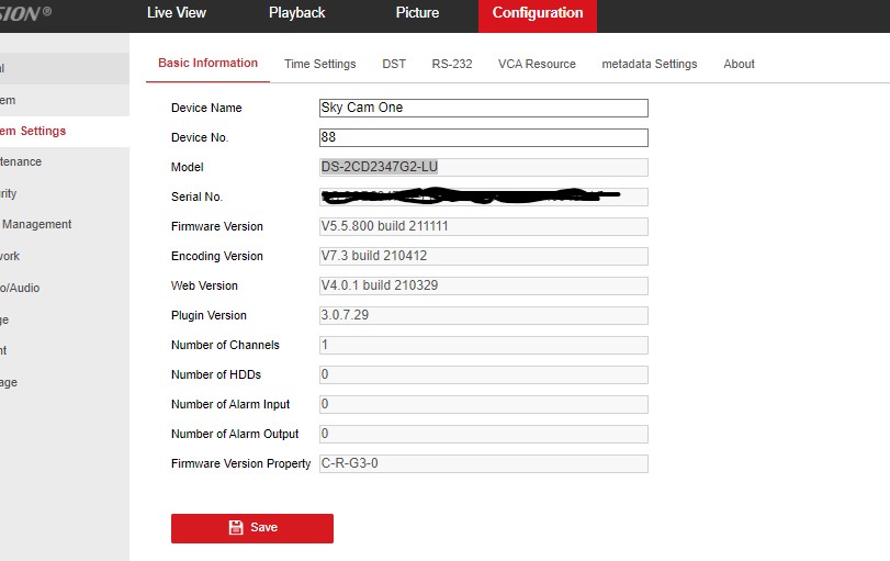

I have two Hikvision DS-2CD2347G2-LU cameras, Last year I upgraded my first one with RTMP firmware from the Uk Hikvision Portal

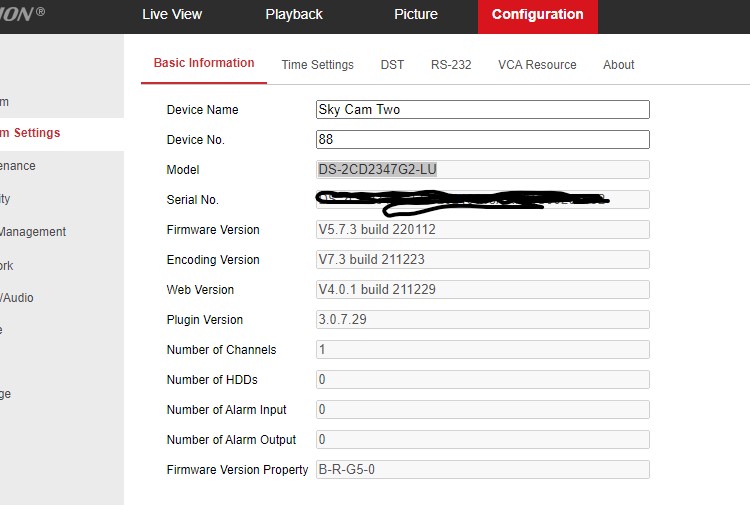

Today I bought a second camera, When trying to upgrade with the same firmware it fails.
Please see screenshot from cam one and cam two (attached)
I have downloaded the latest firmaware for the second cam direclty from Hikvision but still fails to upgrade. Any help would be great.
Paul

Hi @Paul2021
Since you purchased your first camera Hikvision has released a new version of many of the AcuSense/ColorVu cameras, these new models are labelled with a (C) and support a different firmware to the original generation of cameras.
You will see in your above screenshots that the Firmware Version Property is G3 for your old model and G5 for your newer model, this signifies the firmware that the camera uses and so your new model will use the G5 RTMP firmware which is v5.7.1
Yes, if you follow the link from my post above that takes you directly to the RTMP firmware from that G5 folder.
