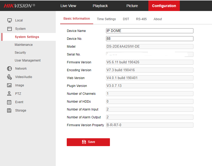

I've been reading HikVisions website user guides, using the google, using youtube, trying everyone's guides and instructions, but still am having zero luck.
Camera Model - HikVision DS-2DE4A425IW-DE
Firmware - V5.6.11 build 190426
And again, there is no NVR/DVR connected to this camera

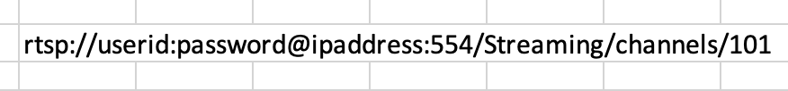

@GetAfterIt this works for me rtsp://userid:password@ipaddress:554/Streaming/channels/101, I stream 4 cameras to the internet.
search for rtsp on the Hikvision forum.
@GetAfterIt without the smiley....
Thanks for your reply. I guess, what I'm wondering and please clarify. I can stream rtsp direct from the camera correct? No nvr/DVR needed right?
And are you able to stream your cameras in vlc? Is there a better way to test? Cameras and cctv are not my expertise but everything I've found on this site and the Google, surprisingly haven't been working.
Lastly, is there anything I need to do to "turn on" rtsp streaming? Or anything I need to turn off, or associate the guest username and pw with this?
I can stream rtsp direct from my camera, use the URL in the image I posted in an earlier thread.
Yes, I can view live stream using VLC.
I've not enabled or disabled anything, I think it is enabled by default. @Dan @Kyle please could you confirm?

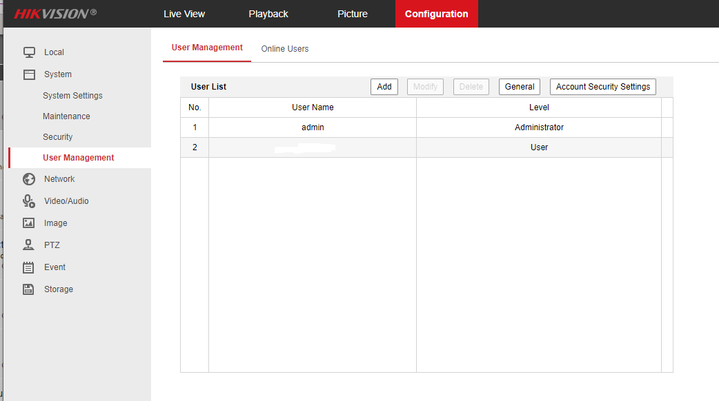

On. the camera admin account setup a user account with remote view privileges only, log out admin and login user. If it does not work login as admin and find out why.
modify the rtsp URL to use the new user id and password, test on local LAN with VLC.

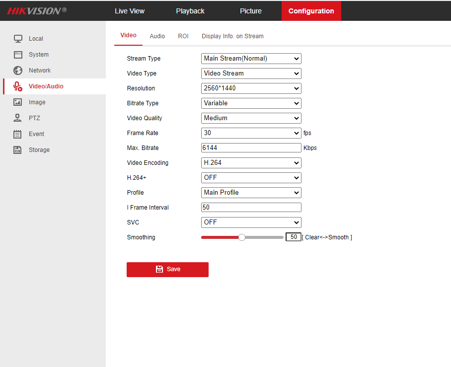

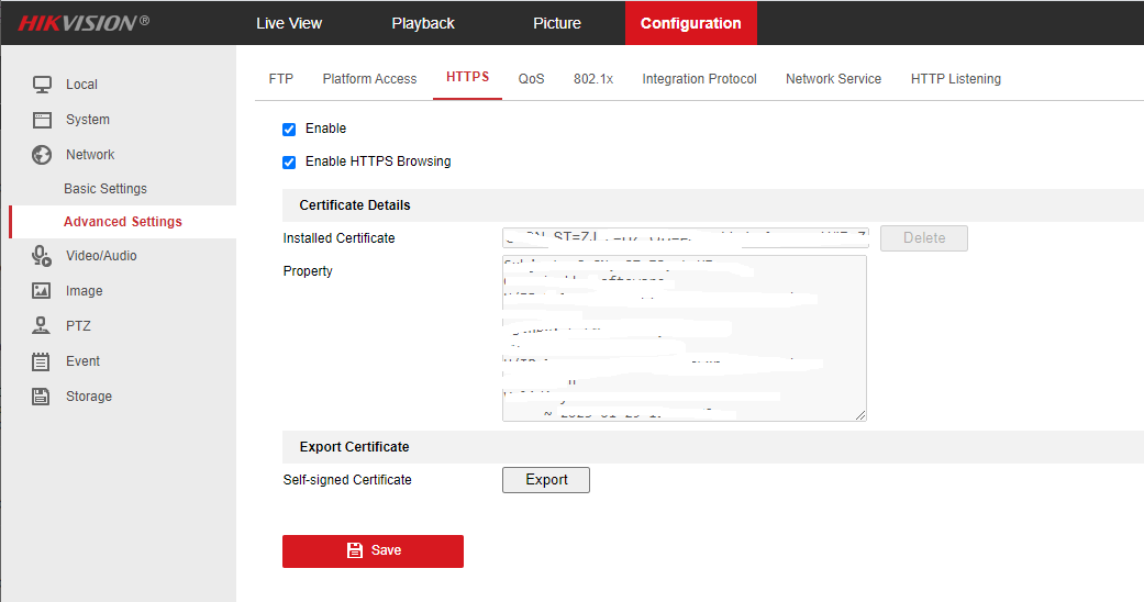

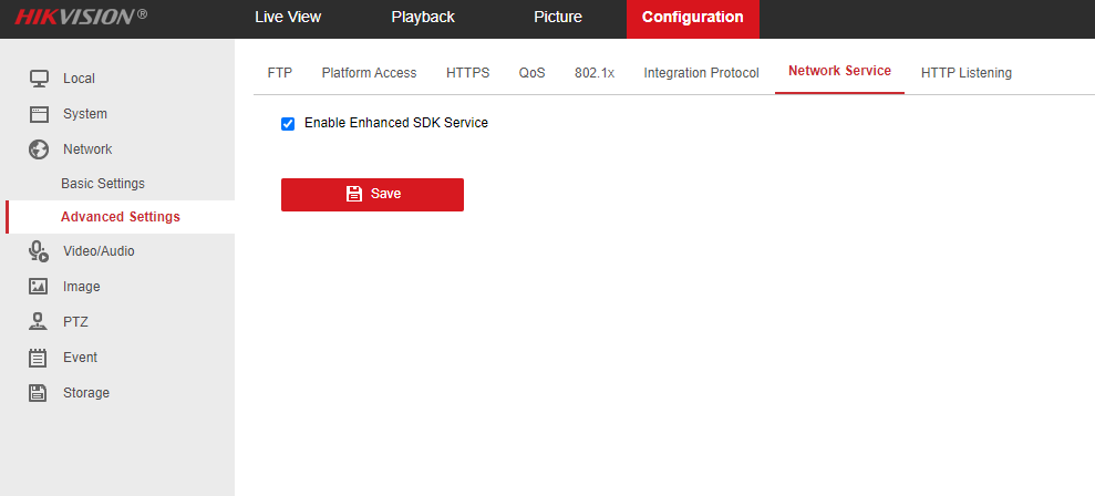

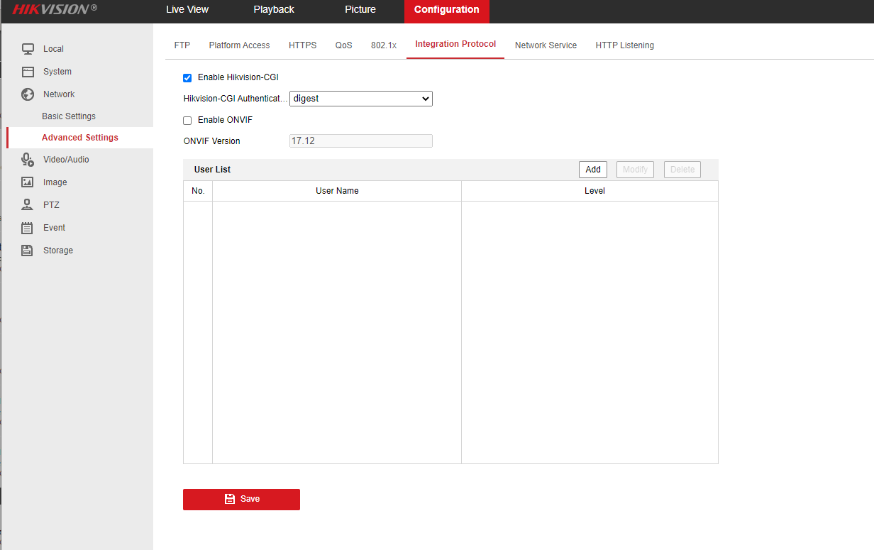

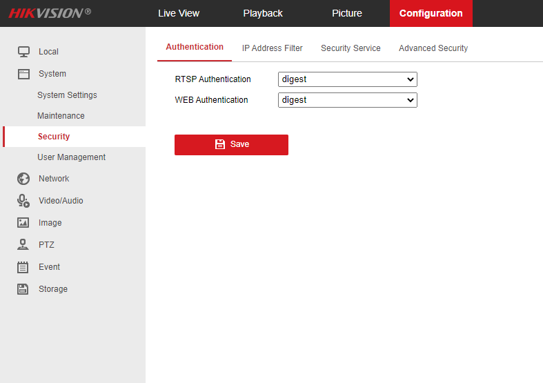

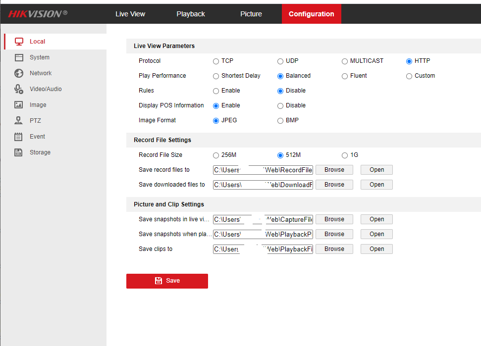

Based on the above error, i found this post, but that also didnt seem to solve the issue either. I've also tried another computer with VLC installed..no dice.
I also am attaching screenshots from camera web interface to help. I've seen videos saying to turn on Hik Vision CGI or seen posts that say to turn off SSL encryption (but not sure if that was only nvr setups )

For now disable NVR HTTPS.

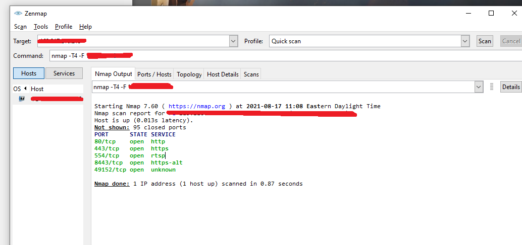

Well, the camera lives out on the internet, no nat or port forwarding, so no local IP to try. And I dont have an NVR for this, so if i disable HTTPS (screenshot 5) wont that affect the camera?
I attached nmap showing port 554 is open on the camera.
I also have access to our palo alto as we have a /24 here and i see https and rstp traffic being Allowed, so its not our firewall.
Maybe VLC is the culprit? Then again, i have also tried vlc on my laptop, and it was a fresh install of vlc.
Again, i can view the live feed and ptz with both admin and user account i created in the web browser. Just cant open rtsp in vlc.
if http port 80 is disabled yes, how do you access the camera http or https?
This should work with VLC, maybe try the sub stream on the rtsp URL. 101 is main stream and 102 should be the sub stream.

live555 error: Failed to connect with rtsp://9.9.9.9:554/Streaming/channels/0

Unless there is a different firmware to try??
You may be able to roll the firmware back to a certain point, I wonder if there are any other protocols that could be used? If this is going to a website could http / https be used by someone with the coding skills and an API call? I think Hikvision use a software developers kit (SDK).
I'm having trouble with the quote replies for some reason, sorry.
Yes. i see on their page for this camera a bunch of archived firmware, any idea of one i should try? I dont see any notes that come with the firmware for sme reason.

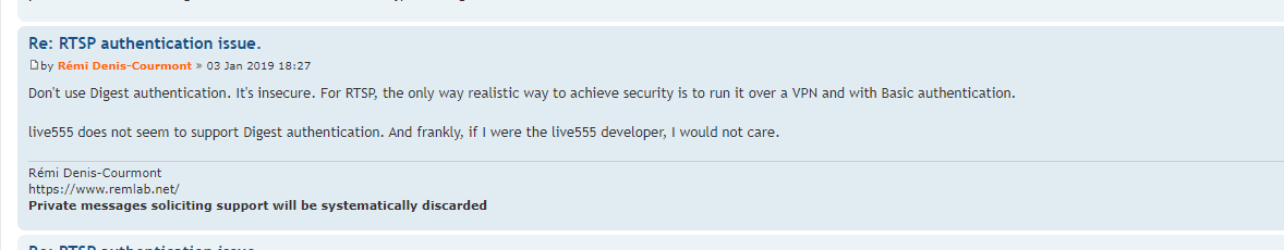

@GetAfterIt 3 of my cameras have rtsp digest authentication activated and rtsp streaming works with the standard URL.
Could you post the public url you are using with changed IP address and logon details?

rtsp://user:QW123@9.9.9.9:554/Streaming/channels/101
i just changed the username and pwand then swapped the IP address for all 9s.
also tried 102, and i think i tired 1
i've also tried with no name/pw to then make vlc prompt me for it. Still no dice.
