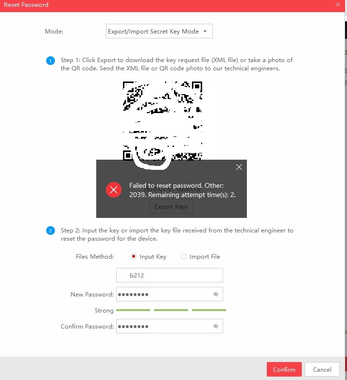

I got the same error as the colleague above, I followed your steps and got the same error. Failed to reset password. Other:2039. Remaining attempt time(s): 2
Device model: DS-2CD1343G0-I.
thank you in advance

Hello
I have only one IP camera in the system and I emailed hikvision support with the error, I get different reset codes but the error is the same. But I don't understand what error 2039 refers to.
==Failed to reset password. Other:2039. Remaining attempt time(s): 2==

Have you checked / tried all of the things in post #3 above? Those are all things which we've known to cause password reset errors.
The latest version of SADP is available here - SADP
The reset files also expire after 48 hours, so you may need to do another if it's been longer since you received it.
Thank you Kyle, it worked
I wasn't using the latest version of SADP tool
