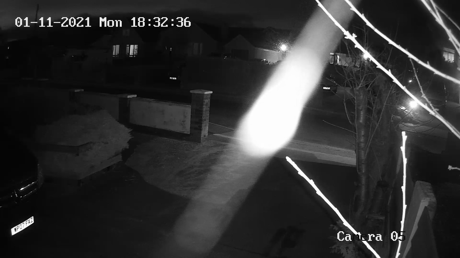

You wouldn't think a small cobweb would cause any problems on one of these infrared IP cameras. Think again, I put a camera up at the front of my garage this afternoon and a spider has already made a small web. The small strand of spiderweb is playing havoc with the infrared. Basically, it's cancelled out the infrared altogether.
I have just realised that the branches from a tree are also causing the infrared to fall short of the distance they can work to.
I use a blow torch. There is some spider spray you can buy from CCTV retails that apparently keeps them away, no idea how good it is
