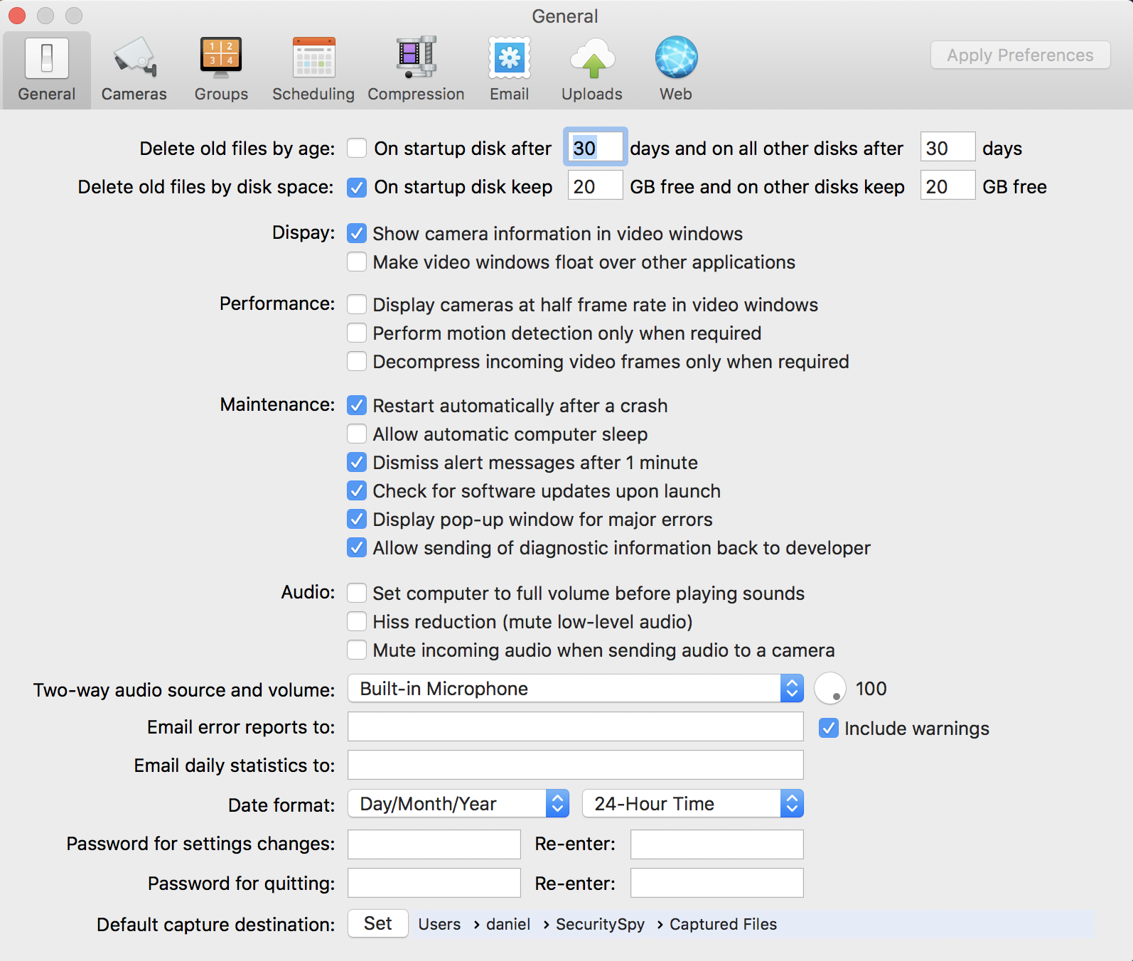

We recently downloaded the Security Spy 30-Day Trial to see how Milesight functioned with the software and how user-friendly the software was in general, and as you can see from the pictures below the software is designed, like any good Mac software, with ease-of-use in mind. On initially opening the software some Mac users who have never installed an IP system before may struggle with getting started, but Security Spy offers a range of support including user manuals, FAQs, and a forum.

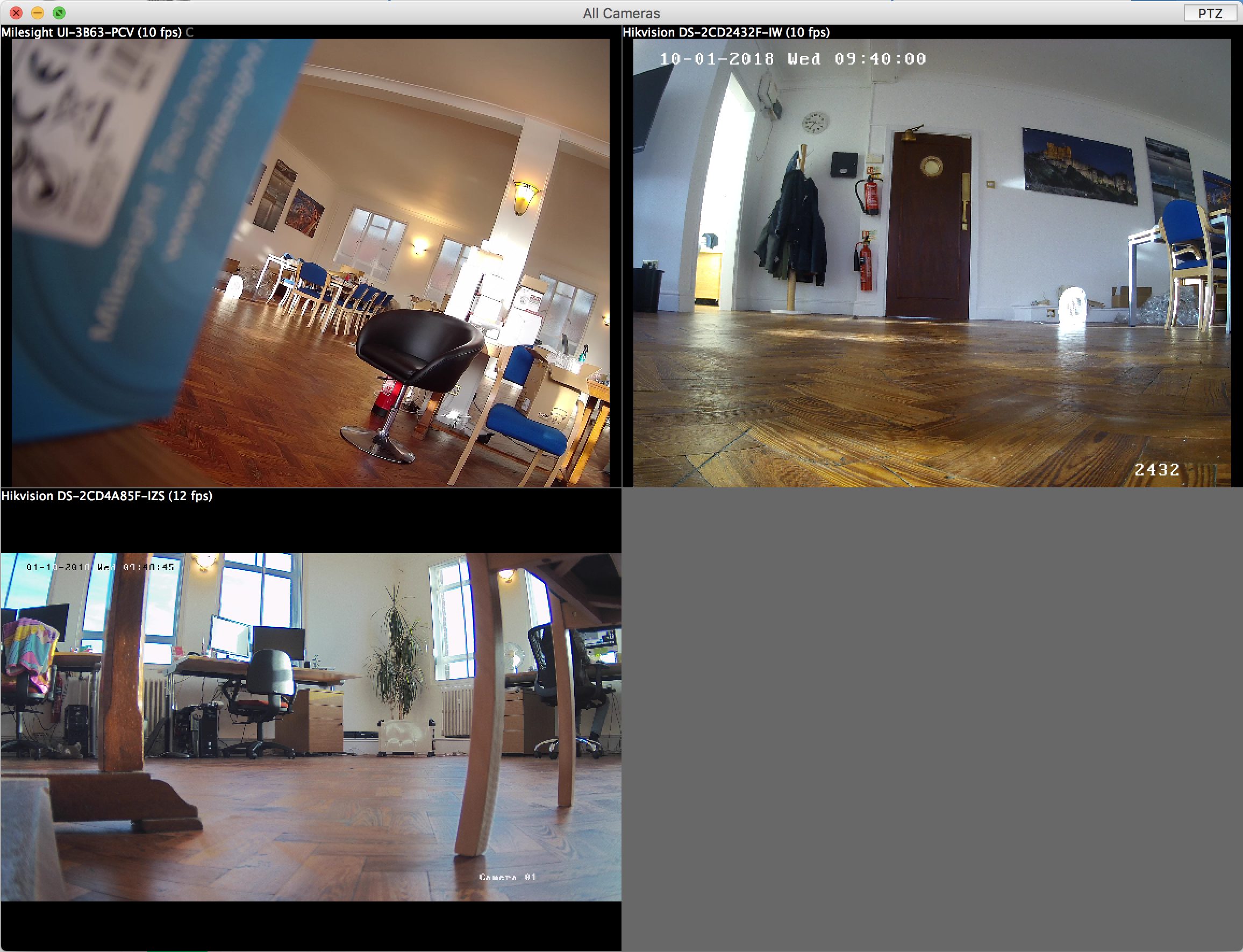

After some time testing the software with Milesight cameras we were really pleased with its live streaming, recording settings, and the huge range of other settings, the only problem we came across is that Security Spy won't detect new Milesight cameras fresh from the box.
