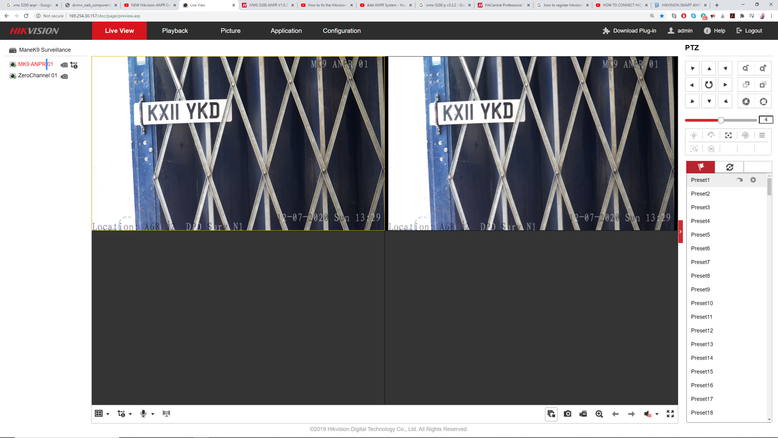

ok I have bought a Hikvision DS 7608NI-I2/8P and 2 x iDS-TCM403 ANPR Cameras and im clearly missing something as I cant get them to grab any license plates. Only thing i have is Video.

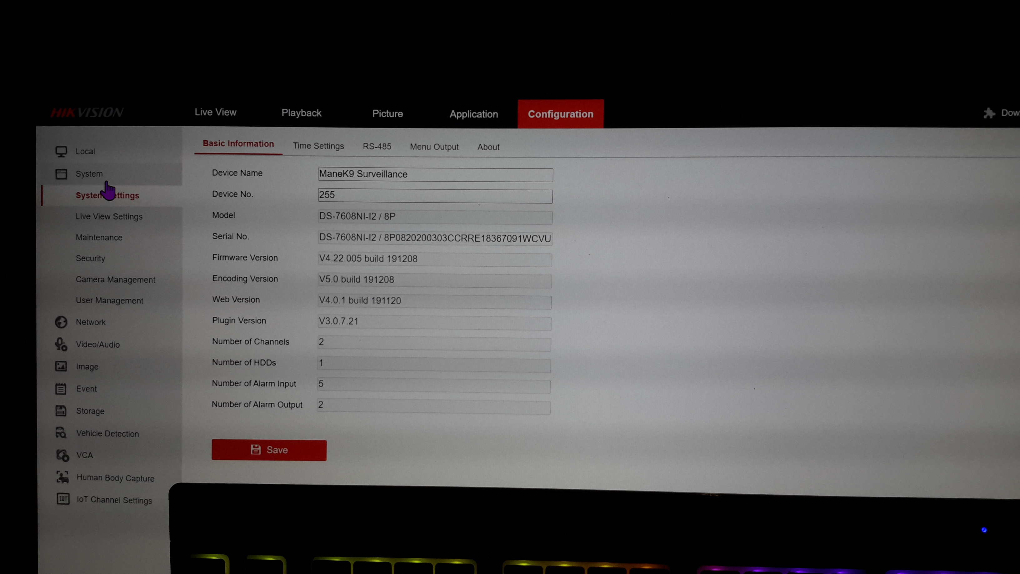

Are the NVR and camera firmware up to date?

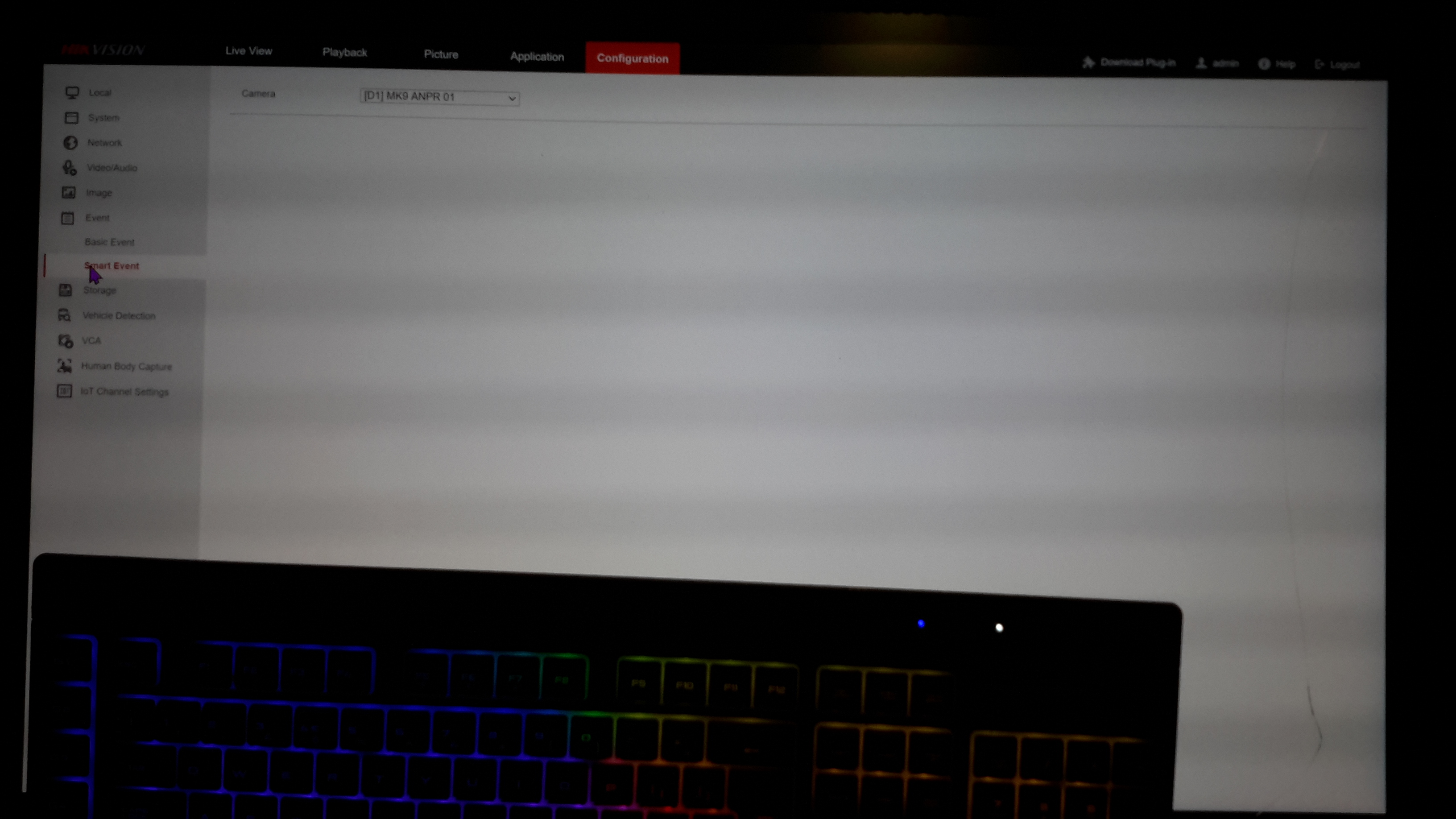

@David appriciate you replying mate as I've been struggling for days to get someone on here to help me. No i haven't tried that as I can't plug direct into a route. Wireless only which I why I connected the dvr to the laptop.
The part where I believe is the section to put the lines in says the camera isn't capable of this. I think it's maybe because in browser it regonises the nvr instead of the camera. As other videos show the model of the camera on yutube. It shows my nvr.

@Devman if your anpr camera cable is connected direct to one of the 8 ethernet ports (bank of 2 x 4 at the rear of the NVR) then you will have to access the camera using the virtual host. If not you can access the camera using its IP address found from the NVR config menu system> camera management> IP camera tab.

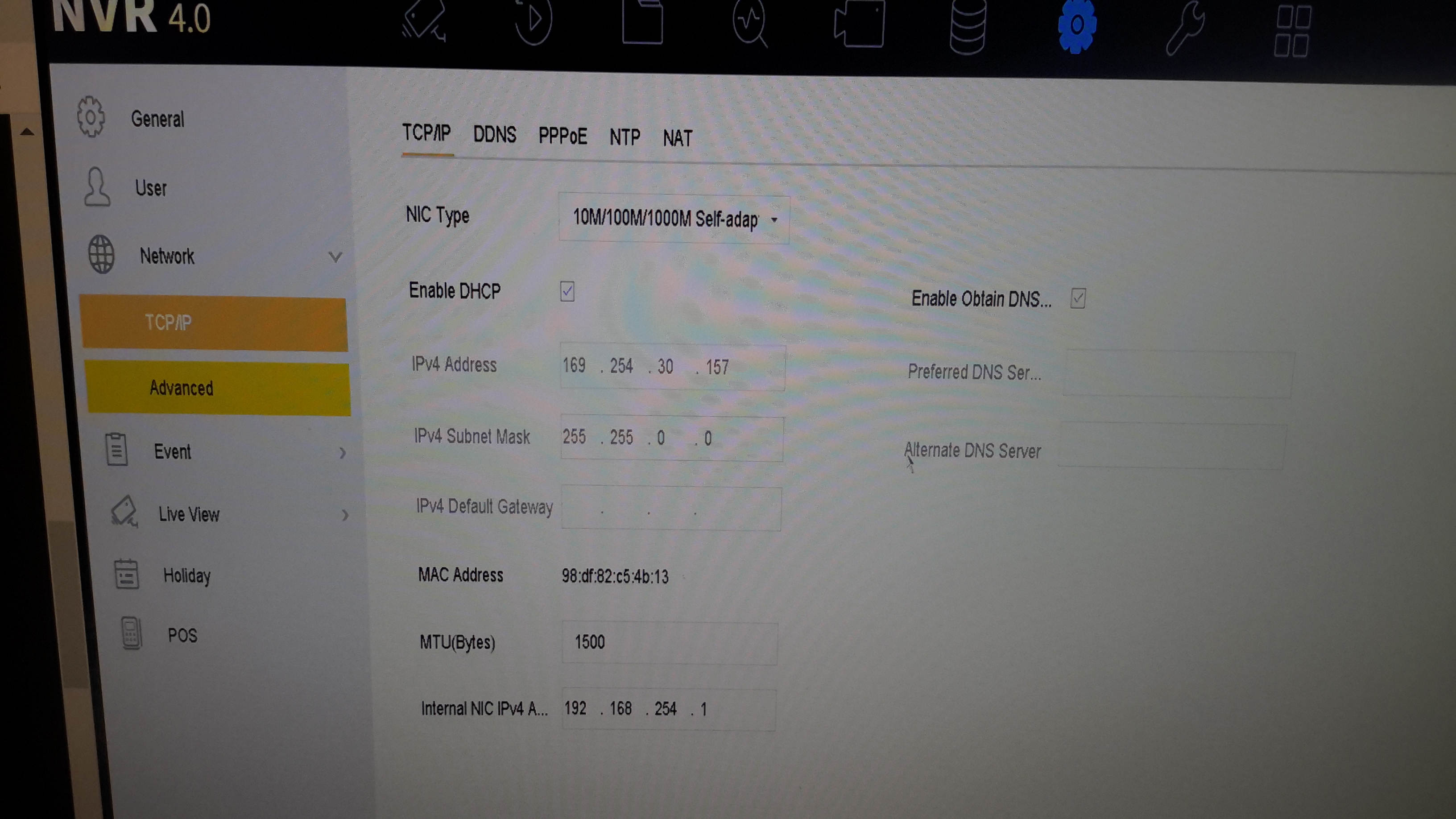

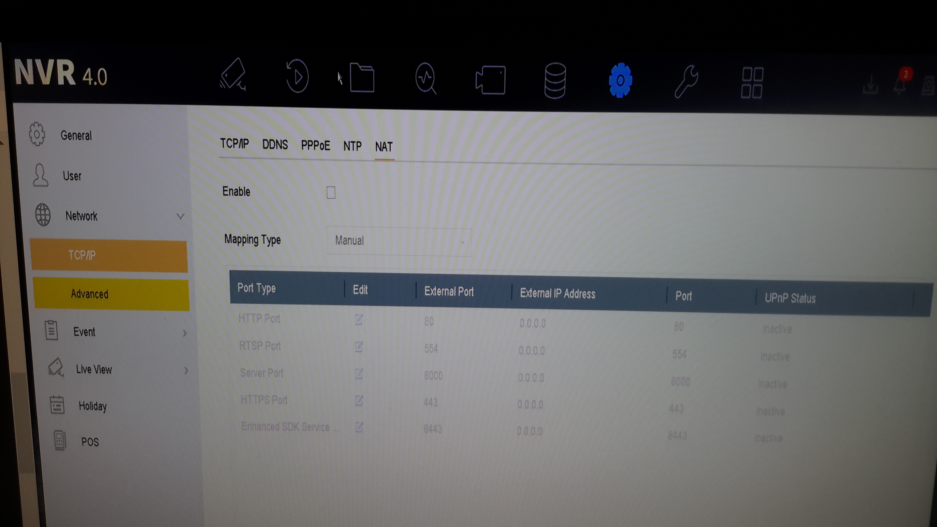

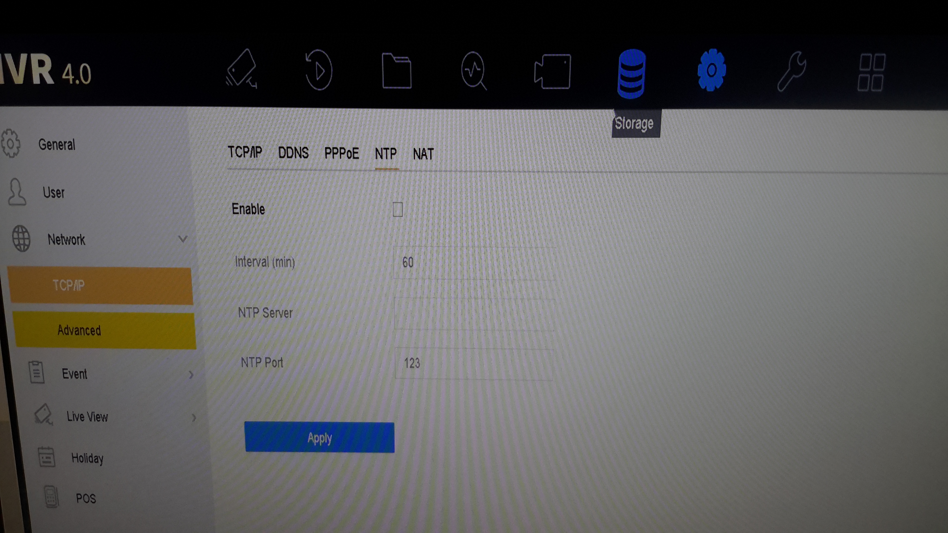

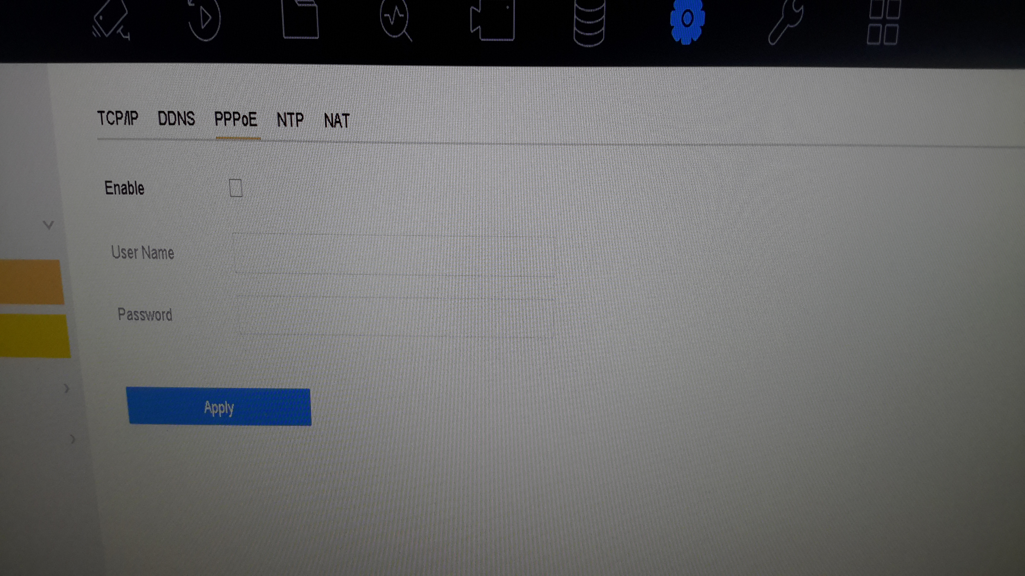

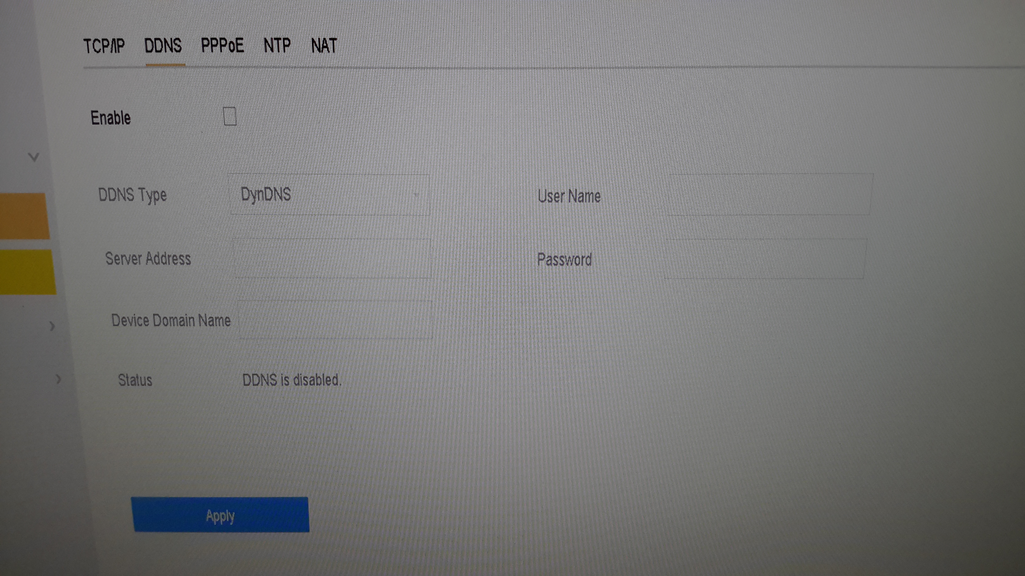

Yes I believe that's what I did. I will run through it again mate. I've sent over shots from my dvr. Is there anything in network I should enable ???
To clarify, the laptop will have to be on the NVR's sub network before that camera will be visible in SADP. If he's on his LAN then only the NVR will show up in SADP.
AHHHHH this sounds like it. How do I do that exactly
@Devman where is your camera connected to? Is it on the nvr subnet or your LAN?
also something looks strange with the DHCP address and subnet mask assigned to the NVR. is the NVR wan port connected to your LAN?
Its connected into the back of the NVR @David and i have the NVR connected to the back of my laptop
@Devman the NVR wan port must connect to your router or to a switch connected to the router the router assigns ip addresses to everything on your net work.
@David Unfortunately i cant hardwire into a wifi router. Is this something i can do just once to assign everything or does it have to be connected to the internet
I am not sure if it will work standalone. For it to work now you will have to connect your laptop to one of the NVR camera ports and assign one of the NVR subnet IP addresses (fixed up) to your laptop NIC.
