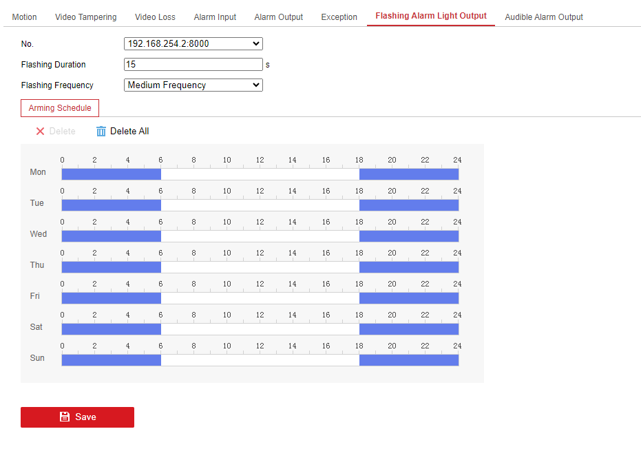

I can see motion detection set up is in both, NVR and the Camera, I configured motion detection in both the same, in the camera and NVR, I got the motion to work and send me notification emails but I coulnd't get the link methode flashing light to work only at night
I disabled the motion detection in the NVR and configuered in the camera and I got the flashing light working at night but the email is not working, I'm getting "The network gateway is not configured, and this may cause the failure of email sending."

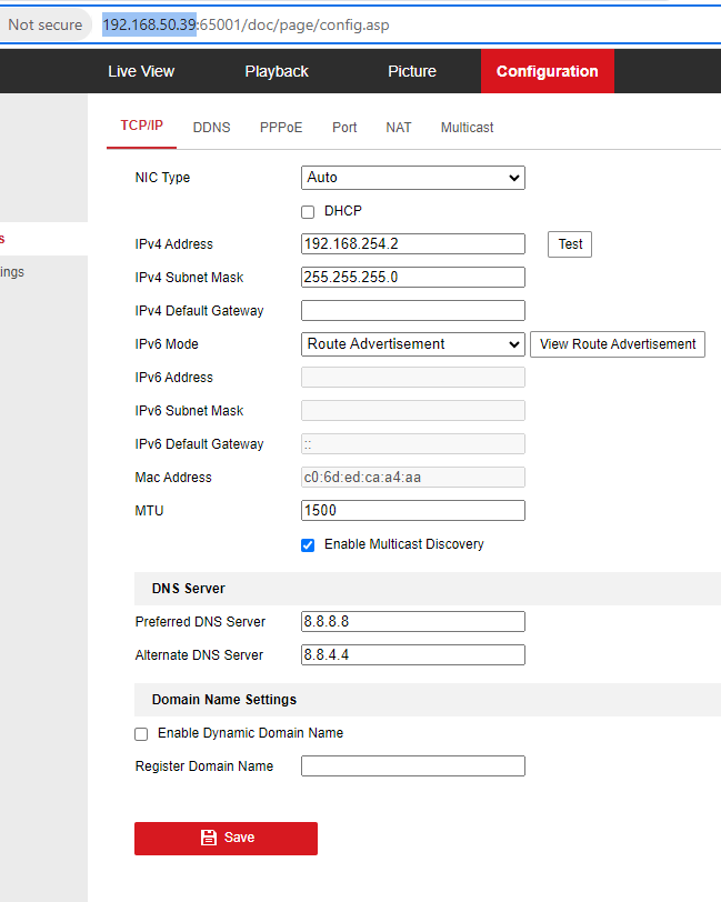

Try configure the Gateway and I noticed I have a different IP address range than the NVR,
In the Camera IPv4 Address 192.168.254.2 but my camera IP address is http://192.168.50.39/ so I don't know where this IP is coming from and when I click on Test I get The address is not used.
This IP address 192.168.254.2 is the one showing in the NVR for Flashing alarm light output

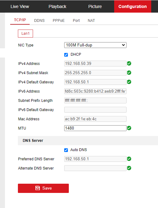

If I set IPv4 Default Gateway to NVR IPv4 Default Gateway 192.168.50.1 and reboot it doesn't take it, should I change NIC Type to DHCP for the camera as in the NVR?
