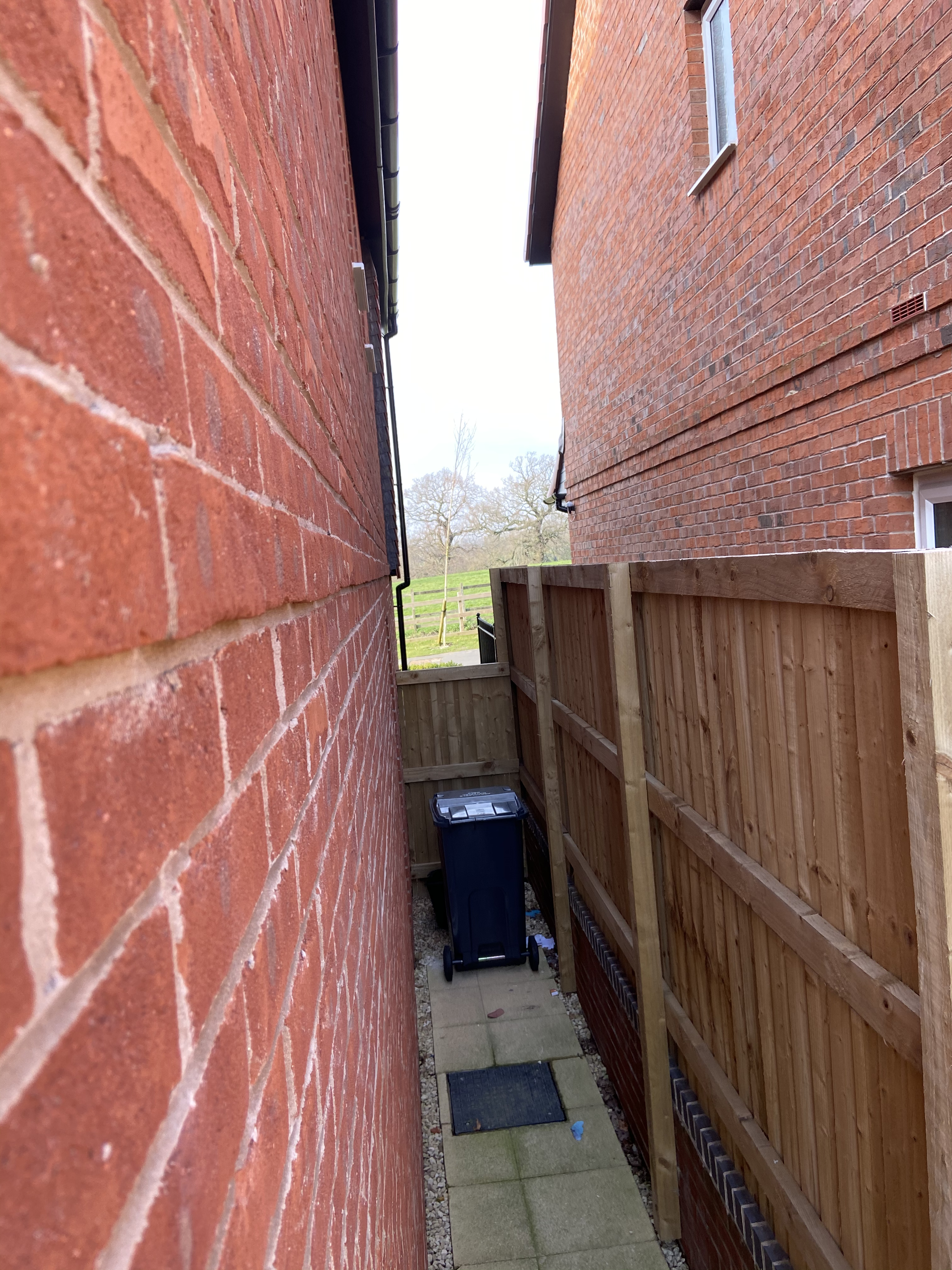

Hi Dan, just another quick question, one of the locations I want to put a camera is pictured below, basically side entrance to house, its completely dark (i need to fit lighting). What camera do you recommend for there? I think the 2CD2386G2-I/GREY would be overkill, maybe?
A turret could work in that location but we would recommend that you use a narrow 6mm focal length to cover this area, this is because if you go too wide you will be wasting lots of your field of view on the walls. another option that we often recommend for narrow spaces and corridors is the Mini Bullets like the DS-2CD2085G1-I which can be angled a bit better to look along the surface they are mounted to. Also, both these models should support the corridor mode that allows you to flip the cameras FoV so that you have a very tall and narrow image which is great for small spaces like what you have above.
