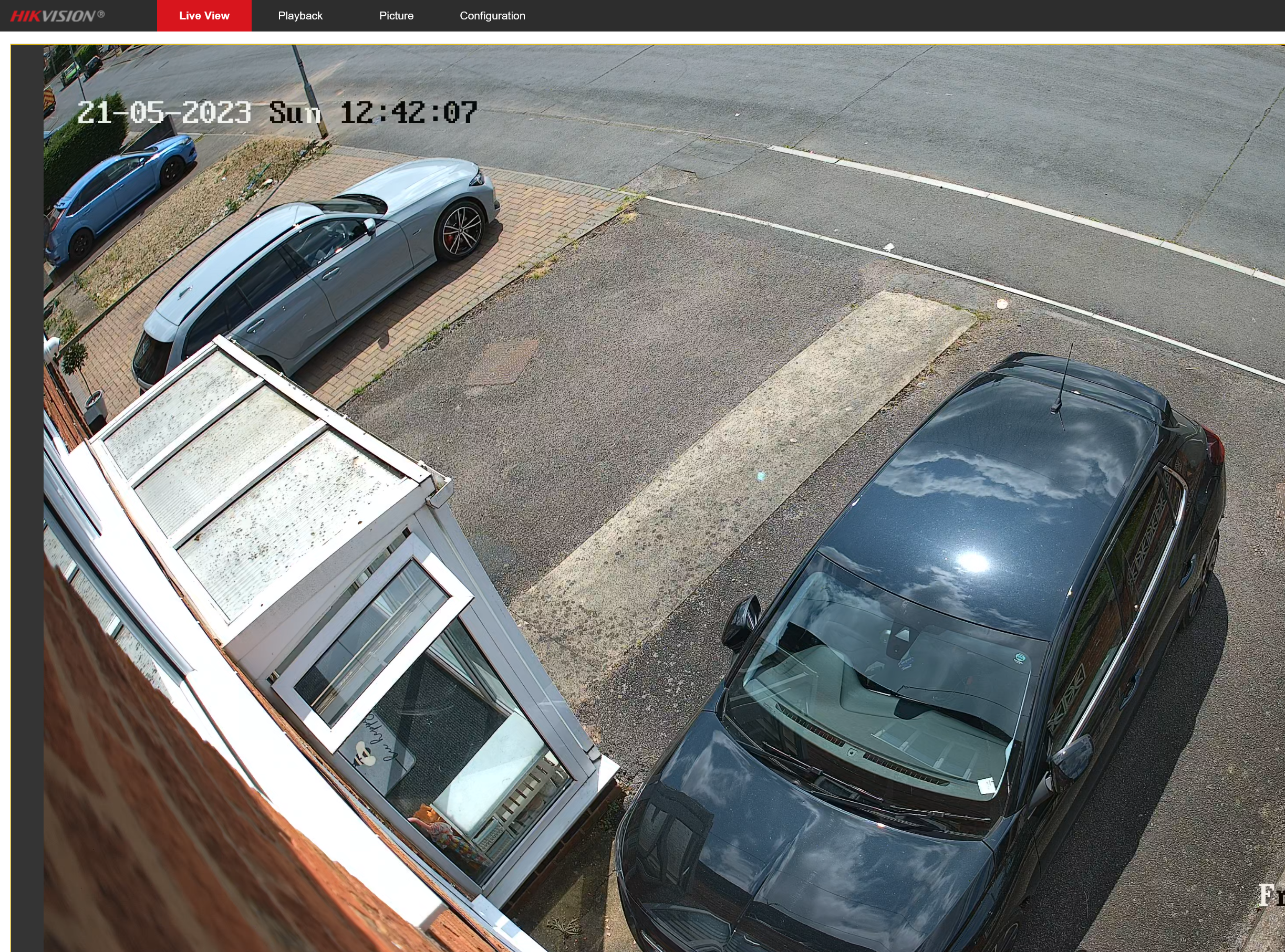

Since updating to the latest firmware all of the lines have now gone when live viewing via the browser and the motion box that highlights motion has also gone, alerts are still working though

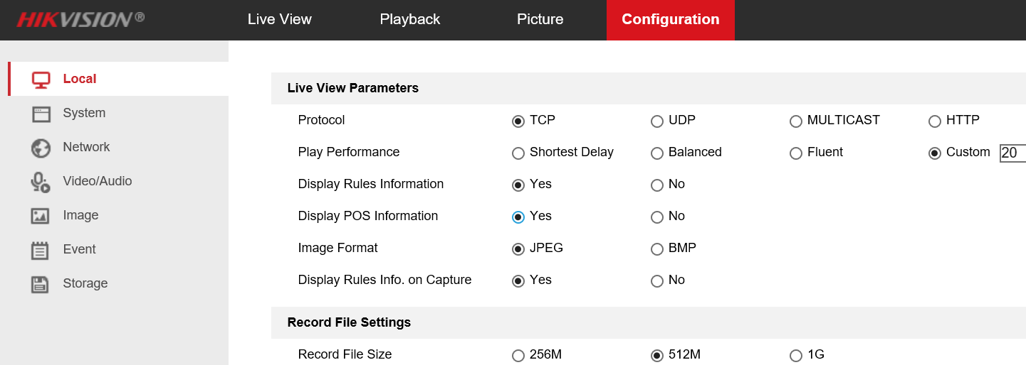

I have tried turning off Display Rules Information and turning back on but it makes no difference, only thing I haven't tried is factory resetting the camera.

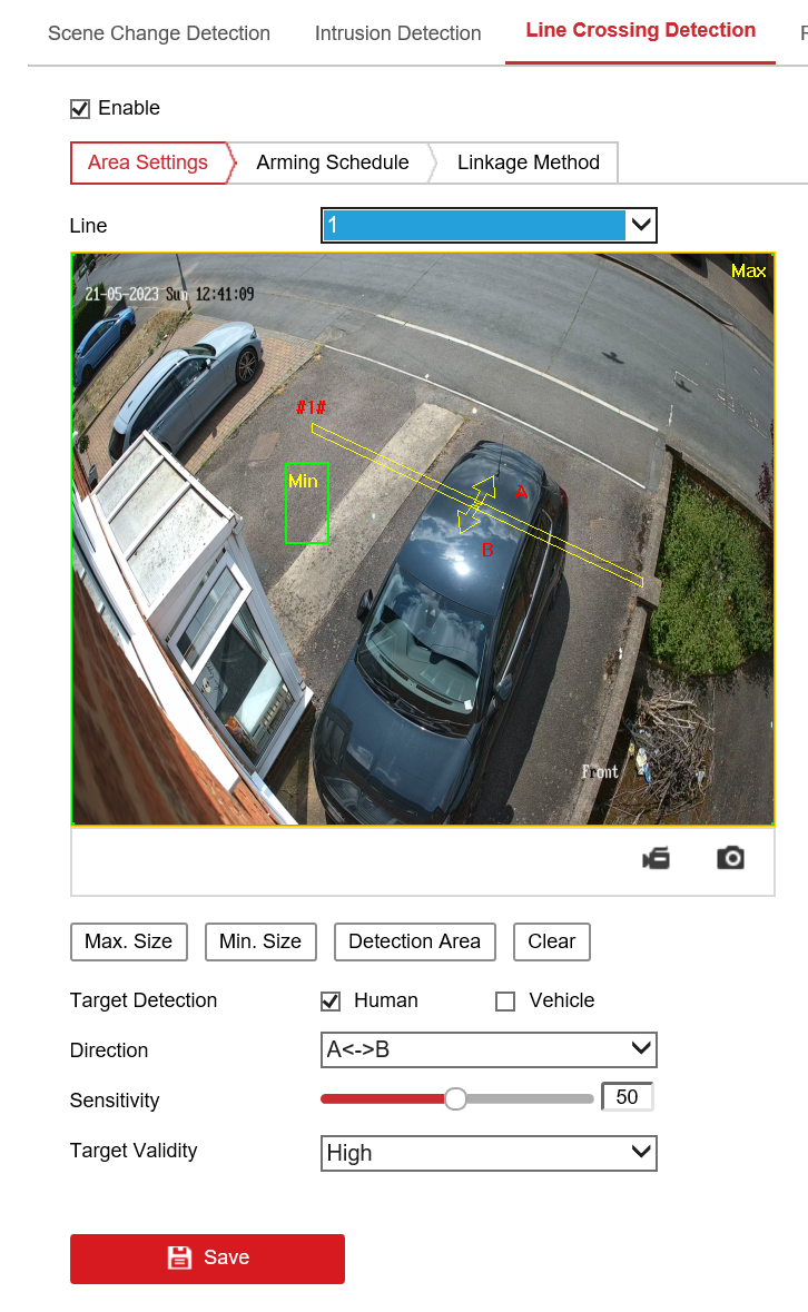

Strange. I just had a look at mine (same model and version) and they're showing. It could be a browser issue/incompatibility maybe. I'm using Edge in Internet explorer mode and they're visible. The motion boxes you're referring to are switched on separately in the motion event settings - it's the 'Enable Dynamic Analysis For Motion' checkbox.
