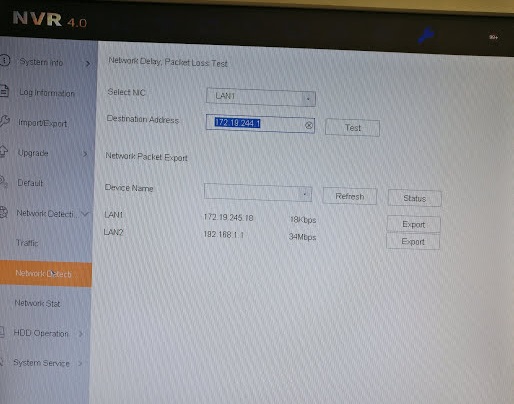

Watching it today...
LAN1 (connection to main network)
Sending: 1500kbps
Receiving: 40kbps
LAN2 (camera dedicated network)
S: 3500kbps
R: 110kbps

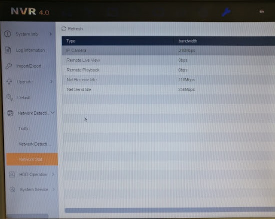

STATS Page:
IP Cameras: 210Mbps
Remote Playback (me monitoring 8 cameras): 9216kbps
Net Receive Idle: 110Mbps
Net Send Idle: 247Mbps

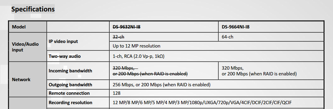

I was asking about RAID because configuring RAID diminishes the bandwidth the NVR can cope with.
Right.. was going to add that I took your comment about RAID the wrong way around! :)

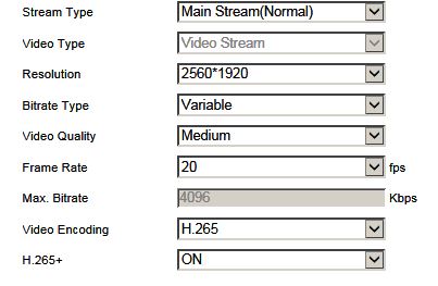

Cameras are set to H.265+
Frame rates are all set as low as we can to be usable for us. For most that 15fps with some set to 20fps.
I've just checked that though and all cameras are now set to maximum! Don't know how that's happened. As I said though, it's working fine like that at the moment???

I tried limiting frame rate of all cameras to a maximum of 20fps as advised somewhere. The resolution never high.

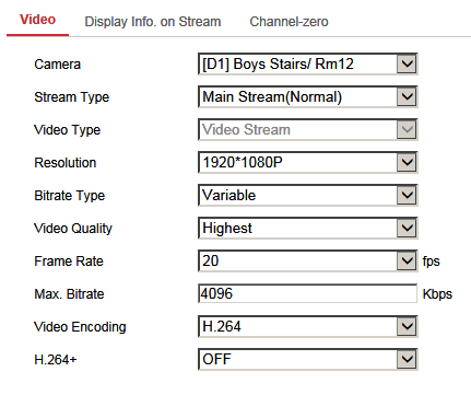

Although H265 is more efficient than H264, it requires more computer processing power on the client side. I would try H264.
A higher frame rate will have reduced latency providing the network can handle the additional bandwidth. If you don’t have the bandwidth try reducing the resolution.

Currently all cameras are set to H265+. That's an interesting thought. We don't need the retention that we're currently getting, so this is doable.
I've turned down frame rate and resolution already. It's only on the windows PCs I'm witnessing any slowdown. The mobile client, running on a modest OnePlus 3, has no slowdown.
I would just change video quality to medium for now to see if it has much effect. And increase the frame rate to 25 or the highest option available.
I’d stick with 1920x1080 and reduce any higher resolution cameras to this too and see if you notice any improvements.
Thanks again Digilec.
This config is copied to all cameras. Performance seems a lot better already, although the establishment is closed and there is no possibility that someone isn't sitting with the web client constantly running.
Before, maximising any camera view would cause a 2 minute break in viewing the stream. Now it's pretty instant, just by changing the encoding to H264.
