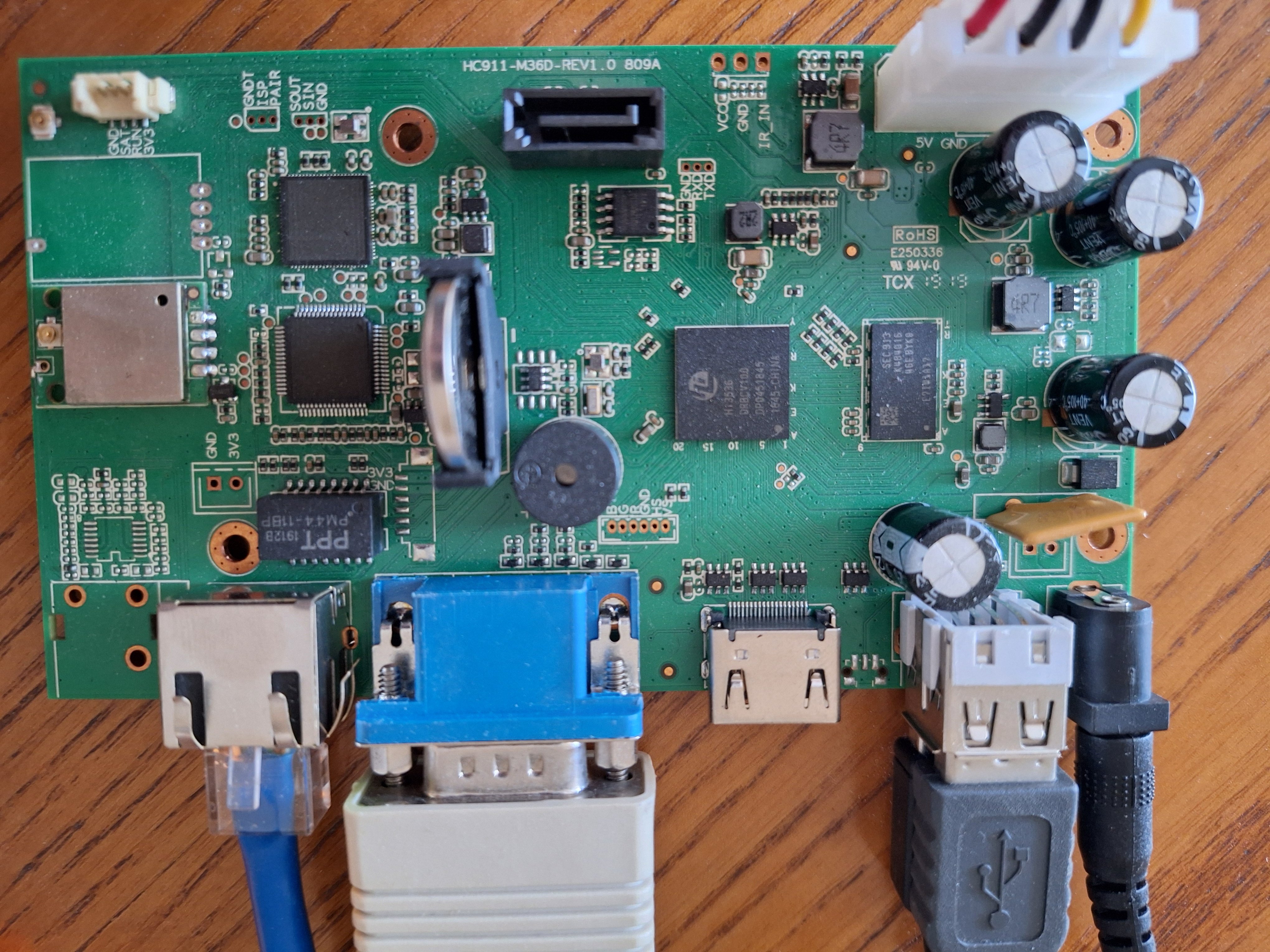

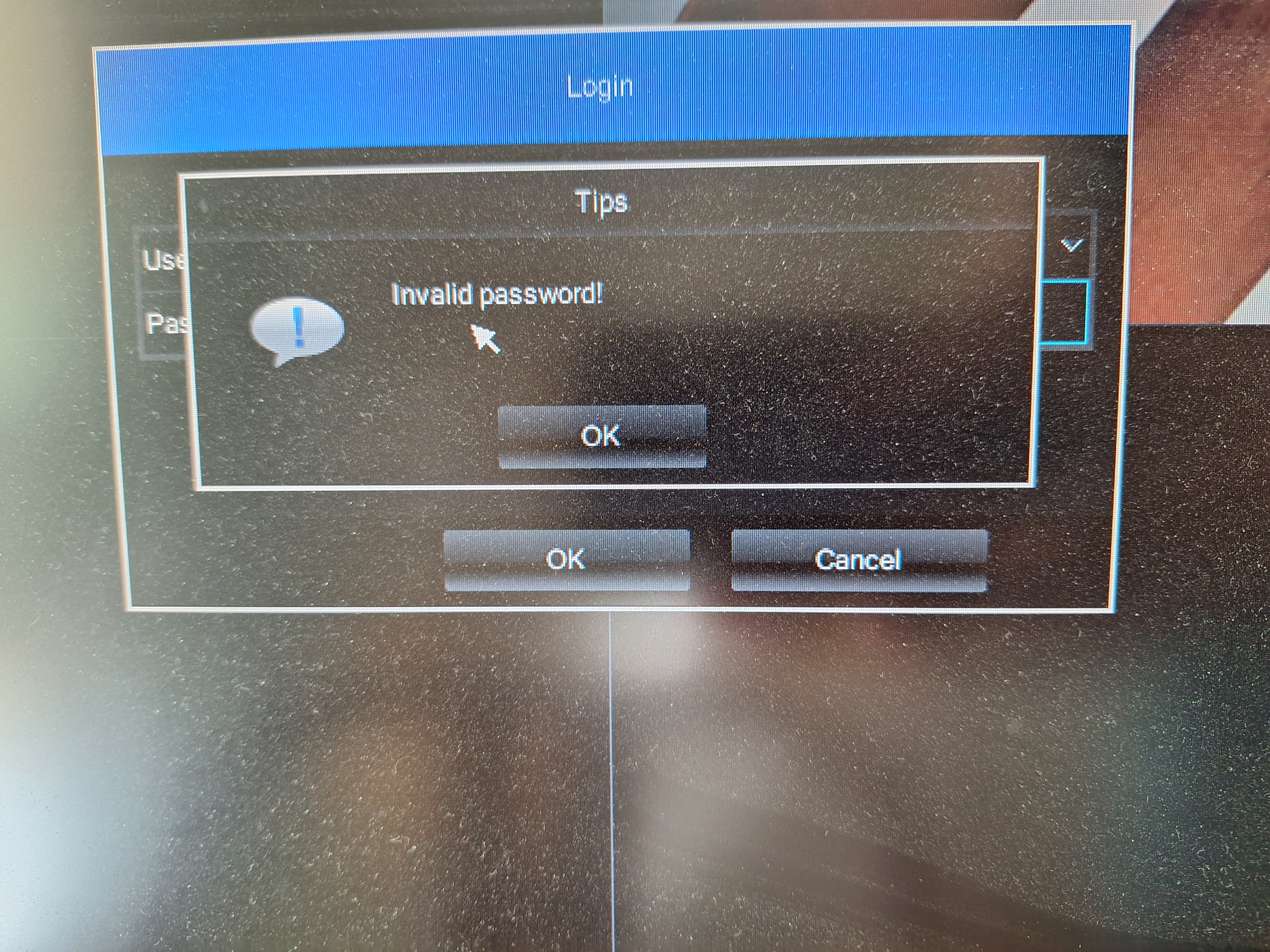

Recently, I wanted to upgrade the hard disk in the NVR, when I discovered that I had forgotten the device password, which would let me access the various submenus. It’s been several years and I cannot find where I have stored the password, I probably thought it was too obvious for me to forget.
What I tried:
  • various password combinations, including the usual (888888-admin default, 000000, 123456, etc)
  • contact SriHome support through Skype – the “Reset Password” functionality is in a submenu that needs the old password to access it…
  • reset device to factory settings – no dedicated button exists on the NVR mainboard, removing/replacing the CMOS battery does nothing, reset button on camera only restarts the camera. The cameras are factory-connected to the NVR wirelessly
  • short some connectors on the motherboard (where a reset button would be) with a metal wire for 30 seconds, no luck
It seems to me that the device password is stored on some chip of the NVR mainboard. Here is the only result I could find when searching with the number of the board ( hc911-m36d-usb-rev1.0), not much help either.

I think that you are pretty much at the end of the road :(
The response from the manufacturer seems plain daft.
Maybe you can contact the reseller that you bought it from?
Apart from that, it's not a brand that I have ever come across so I don't think anybody here in the forum will have a magic answer, but you never know ...
