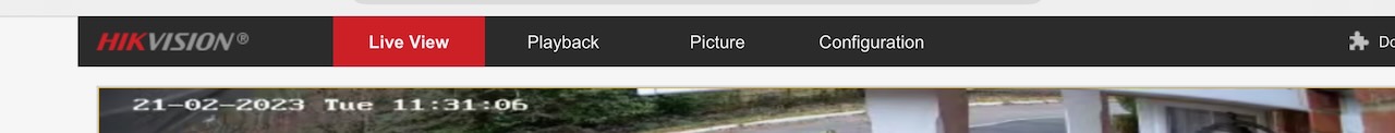

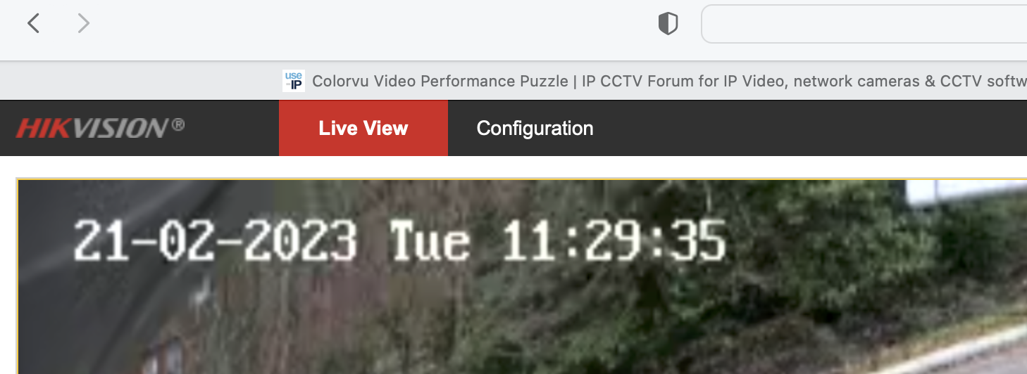

There are certainly some oddities between the Mac experience and the PC one, even between MacOS and iOS. For example, when logging directly into a camera, there is no Playback or Picture menu option on Safari for the Mac, just Liveview and Configuration, compared with the iPhone. Do you think this is what's causing the spurious transcoding issue? iVMS4200 on the Mac shows all of the cameras just fine and the NVR is recording all smart events as programmed just fine. I may need to hardwire my PC, as I'm currently using WiFi and it's not the best.

Can I just clarify, are you saying you can see the picture & playback menus when accessing the NVR with Safari on the iPhone?
Hi @Dan,
Not the NVR, this was just looking at one of the cameras via its IP address on the iPhone. I've not tried to view the NVR via the phone.
Which camera model?
We had assumed that Safari behaved the same on desktop and mobile, but I guess the mobile version of Safari must still offer some level of support for the old plug-in which is allowing you to see the menus not displayed in the desktop version of Safari.
This is with a DS-2CD2386G2-ISU/SL running 5.7.12
