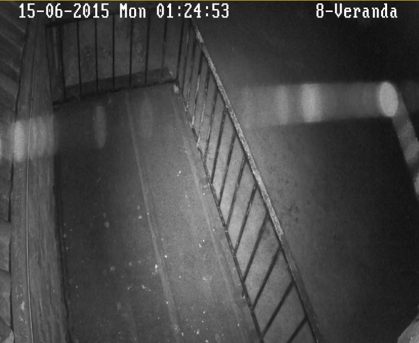

I've just setup a 7616 NVR with 2032 bullets. On one camera I'm getting strange dancing lights - looks like some kind of reflection. See attached picture. These lights flicker, and dance around slightly - triggering motion detection. The area is totally dark - we have no street lights in our area and nor are there any visible lights from neighbouring properties.
Any ideas what causes it and how to avoid it?

That's a spider web. You'll need to clean the area around the camera.
As for false triggers, these can be somewhat difficult to avoid. It's unlikely you'll ever get motion detection 100% perfect, especially with certain animals interrupting the scene. My only suggestion is to play around with the sensitivity until you get a balance that works for you.
That's a quick spider - it was the first night after installing it. I've climbed up and inspected, but could not see anything. I gave it a wipe and I'll see if it's any different tonight.

It must have been a spider's web. No problem since I wiped the lens area. Thanks!
